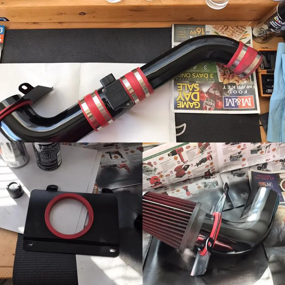

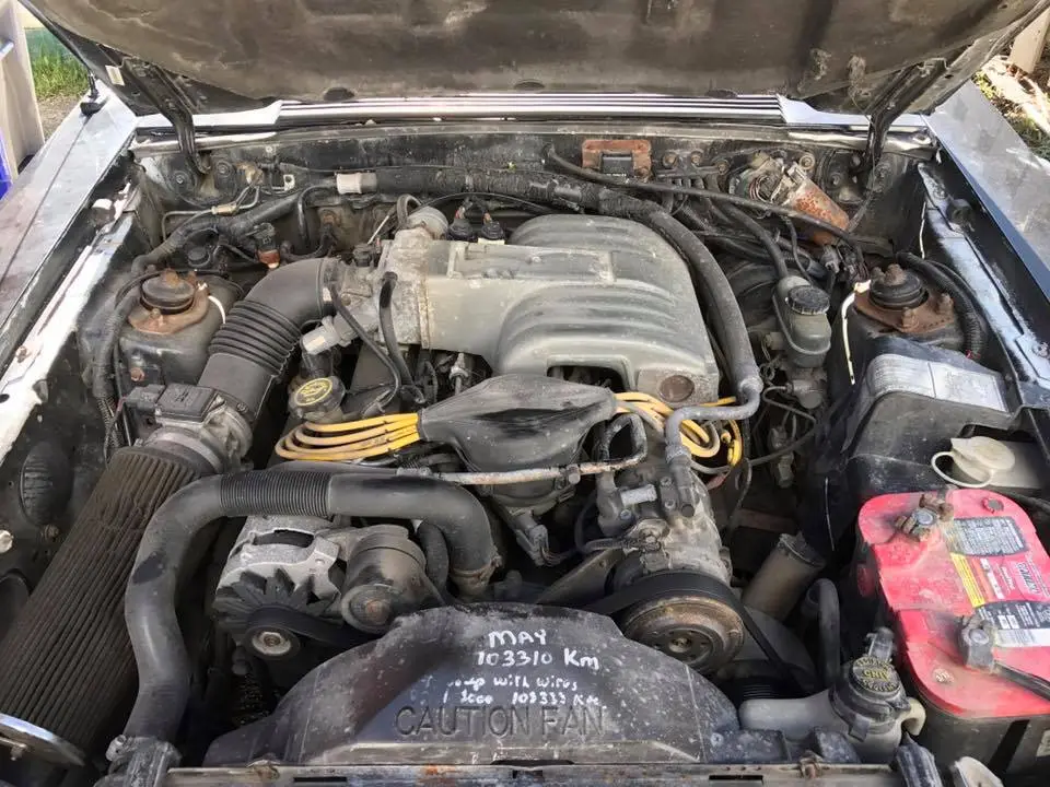

I got my intake painted. Just need to clean and oil my air filter. One more little thing done. :-)

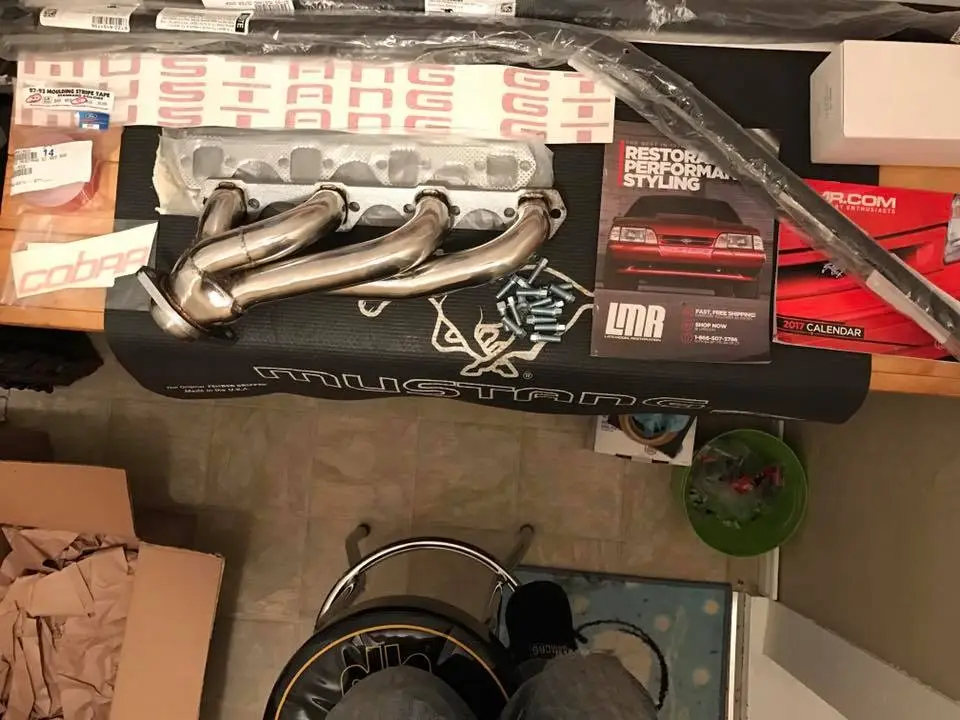

Well my LMR order came in :-).
Still need more parts. Seems like theres always more lol. Its a start. Can't wait to start replacing parts. Then cruse for the rest of the summer.

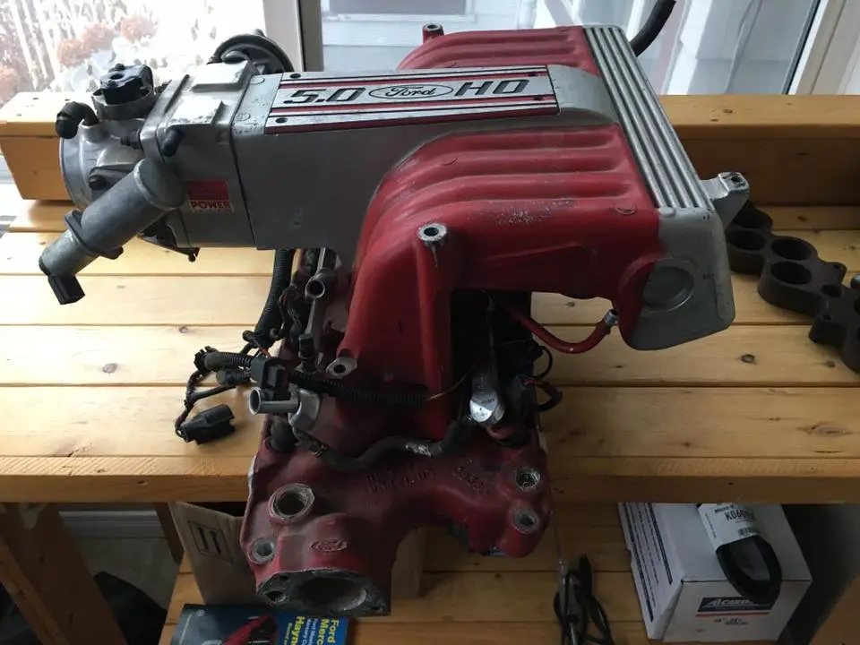

I think next I will work on my intake. Explorer (GT40) intake. Clean it up and paint. Maybe some gasket matching at the same time. :-)
I also have a 1" spacer. Will it fit under a Stock hood?? From what I have read online it should. Might have to take off my hood insulation. Mine is in bad shape anyways so I was going to take it off.

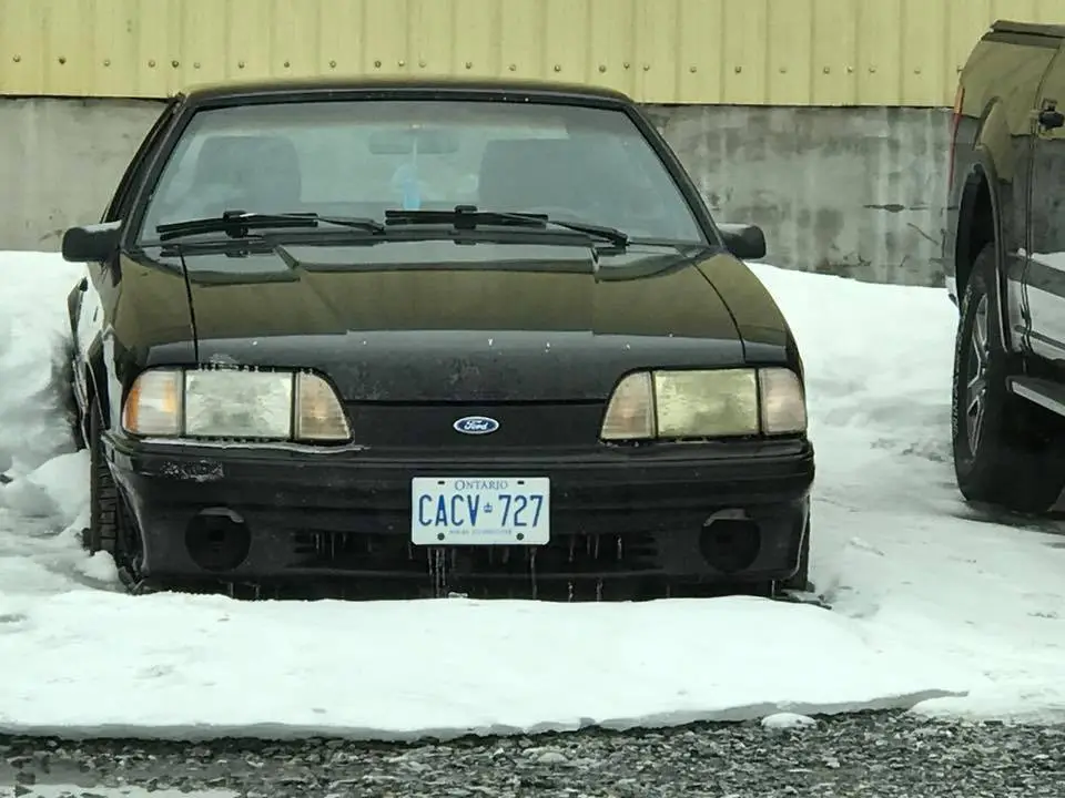

Well I went to wake up my baby almost two weeks ago. Lets just say she was not ready. Still way to much snow:(

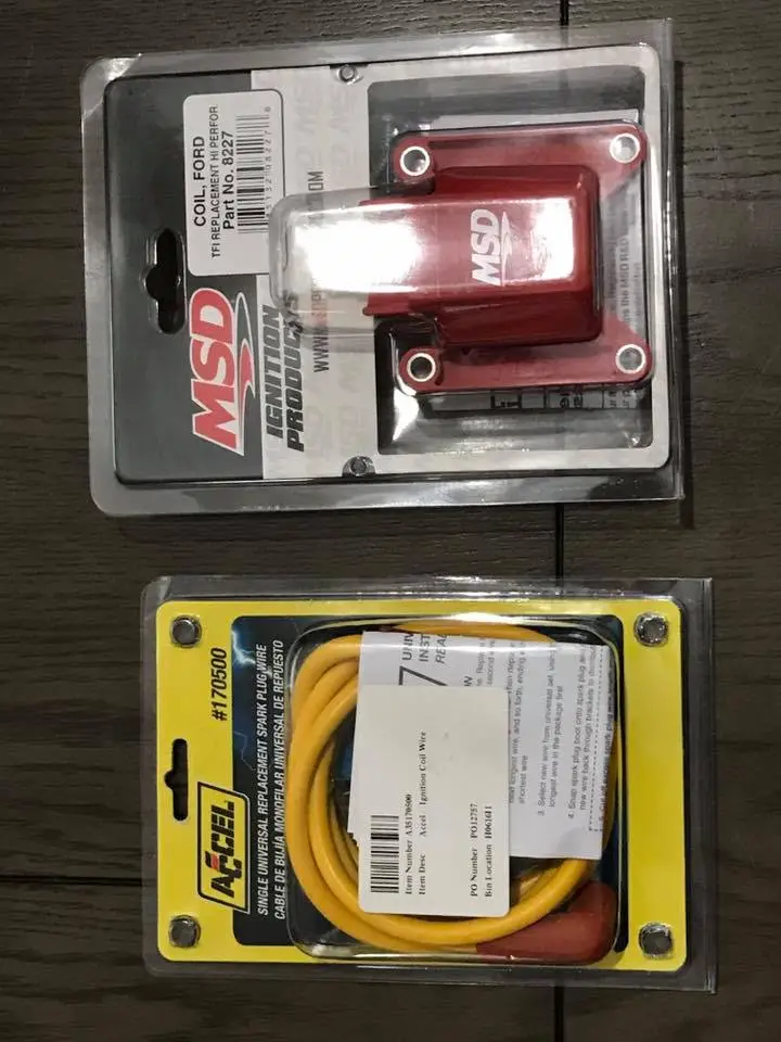

I got some more parts in. MSD coil and a Accel wire to replace my coil wire. When I got my new wires last summer the coil wire was to short so I ordered one off Ebay.
1" spacer may not clear the stock hood. I have a 3/8" spacer on my Cobra intake and it's close. 1/2" would probably contact.
I wouldn't lose much sleep if you can't run the spacer. Explorer intake is already well known for producing torque with its larger plenum volume
Thank you for the info. I will just have to wait to install my spacer I guess. No big deal.

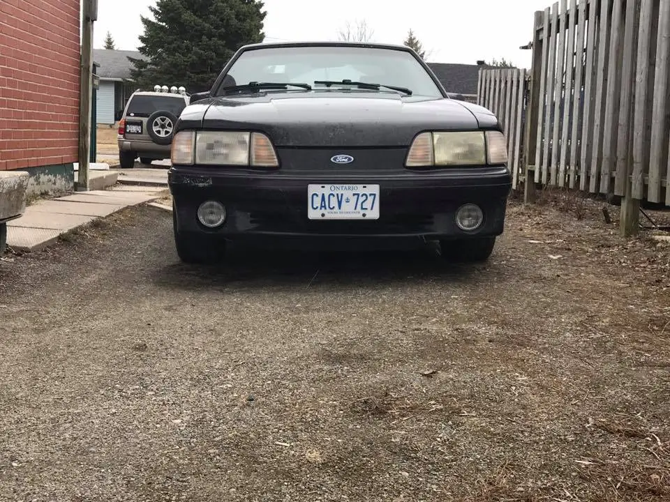

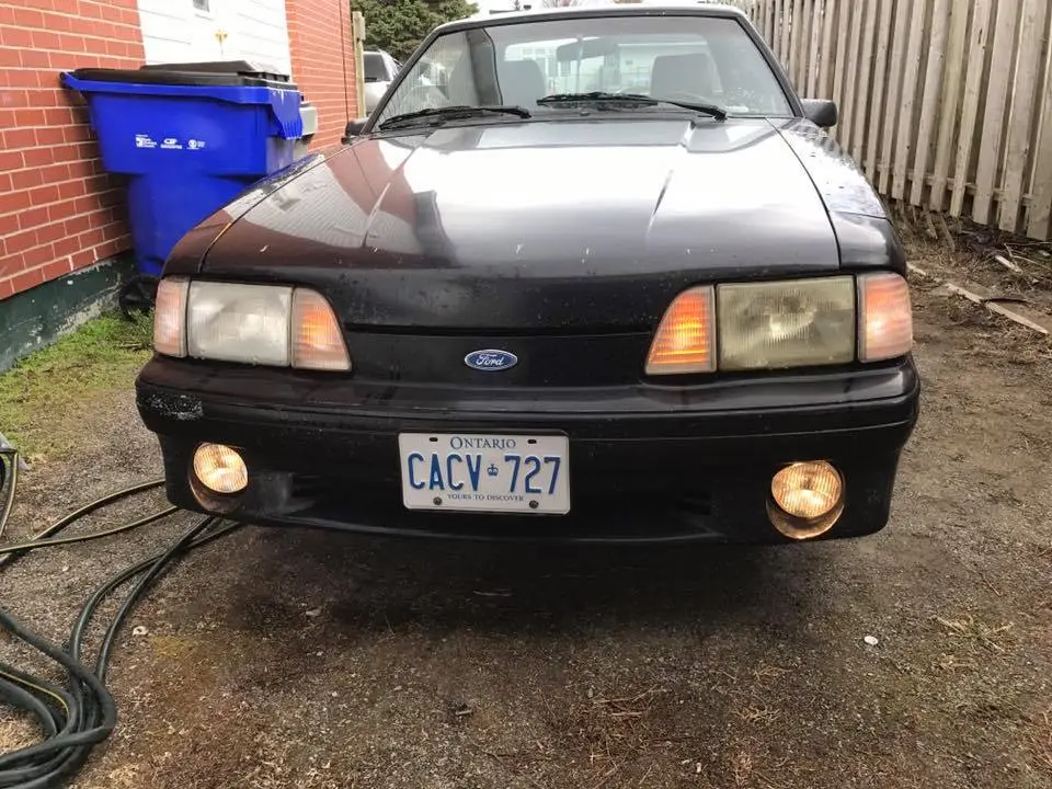

I was finally able to bring my car home. The weather is still not the best so I have not started the water pump replacement yet. But i did do some work on her. I installed my fog lights. Had to clean the connectors. Mounted them up and plug them in. They work :-).
Before
After
Looks way better. Just have to wait for night so I can align them. I will pick up what I need to do the fog light switch mod. Don't need my lights going out on me at night or worse burn my car up. Now she will need new head and park lights. They look really bad compared to the new fog lights.

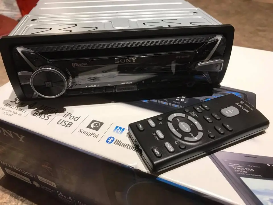

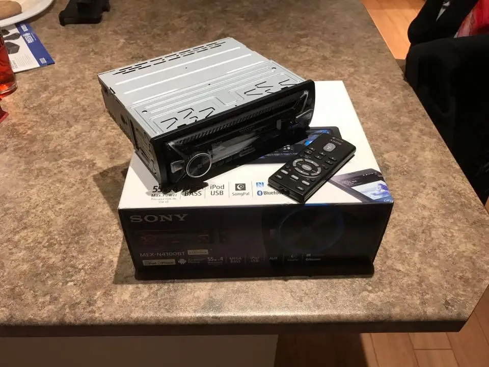

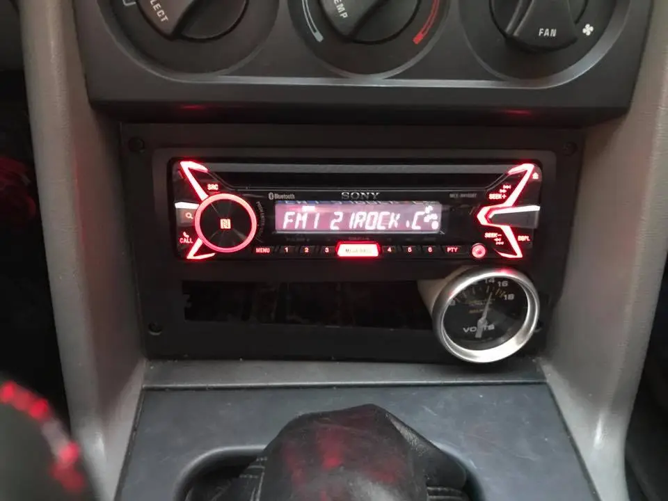

I installed a new head unit this weekend. Sony MEX-N4100BT. Nothing special but it has bluetooth to stream music. Just need new speakers and a 10" sub for a little boom boom.
I also installed my Auto Meter carbon fibre volt gauge. I will have to get or make piece to hold my head unit and gauges. But it works for now.
I think it looks good at night with the red lights. Lot more red lights to come.

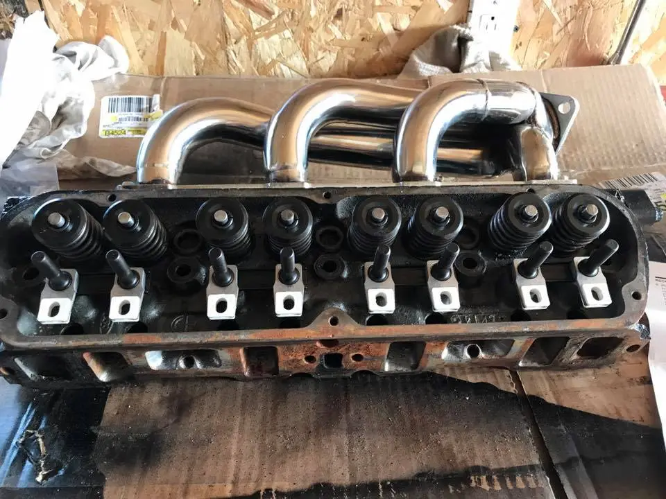

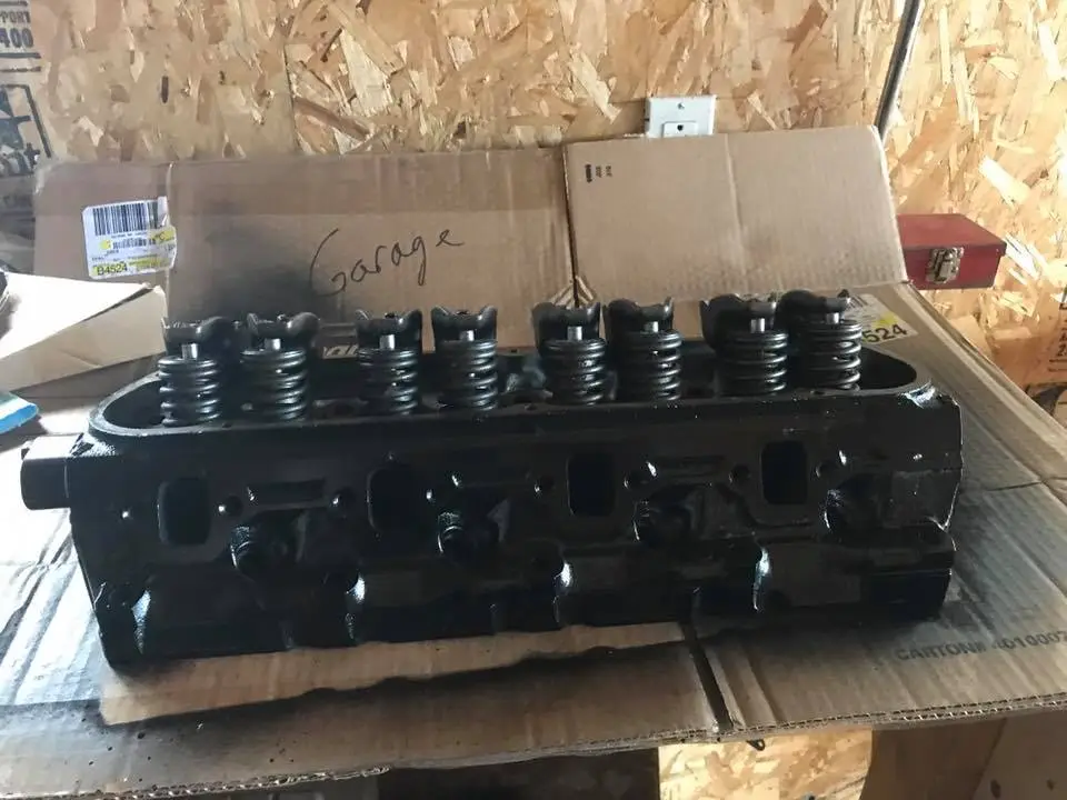

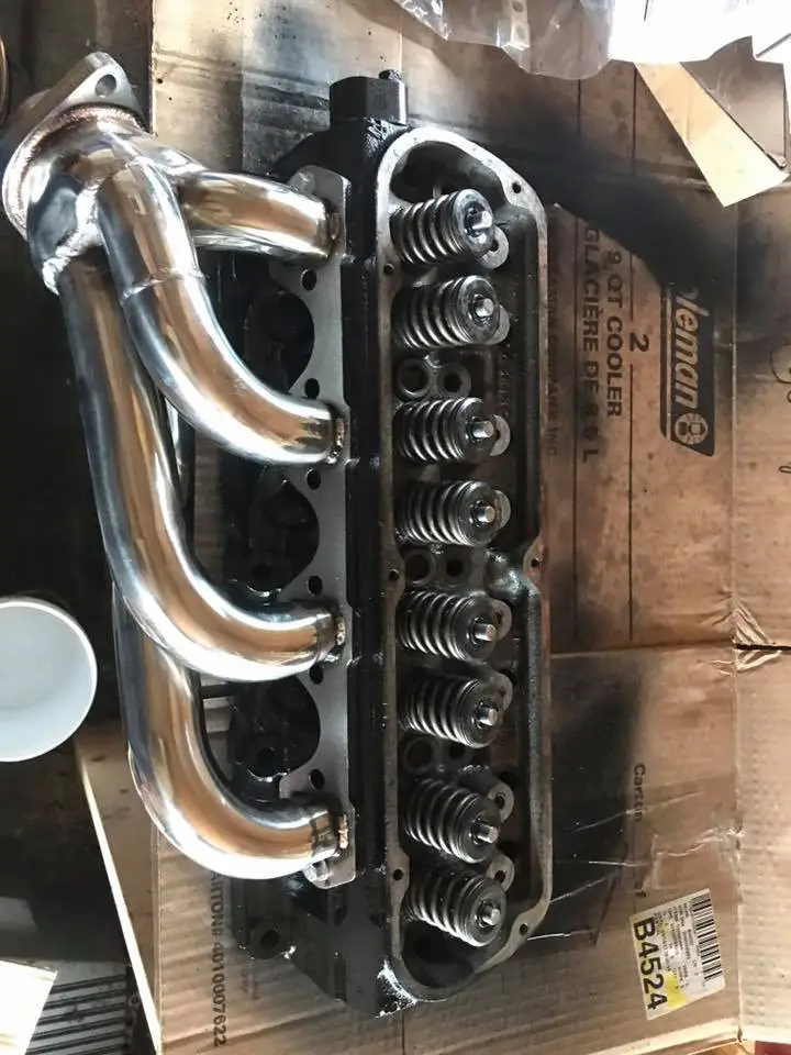

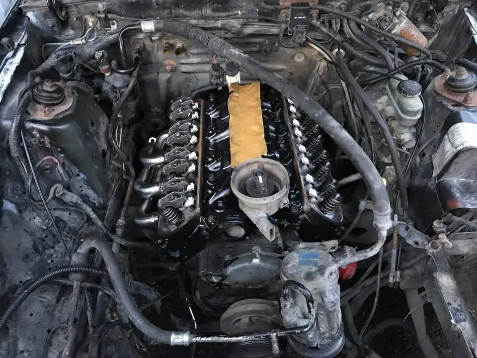

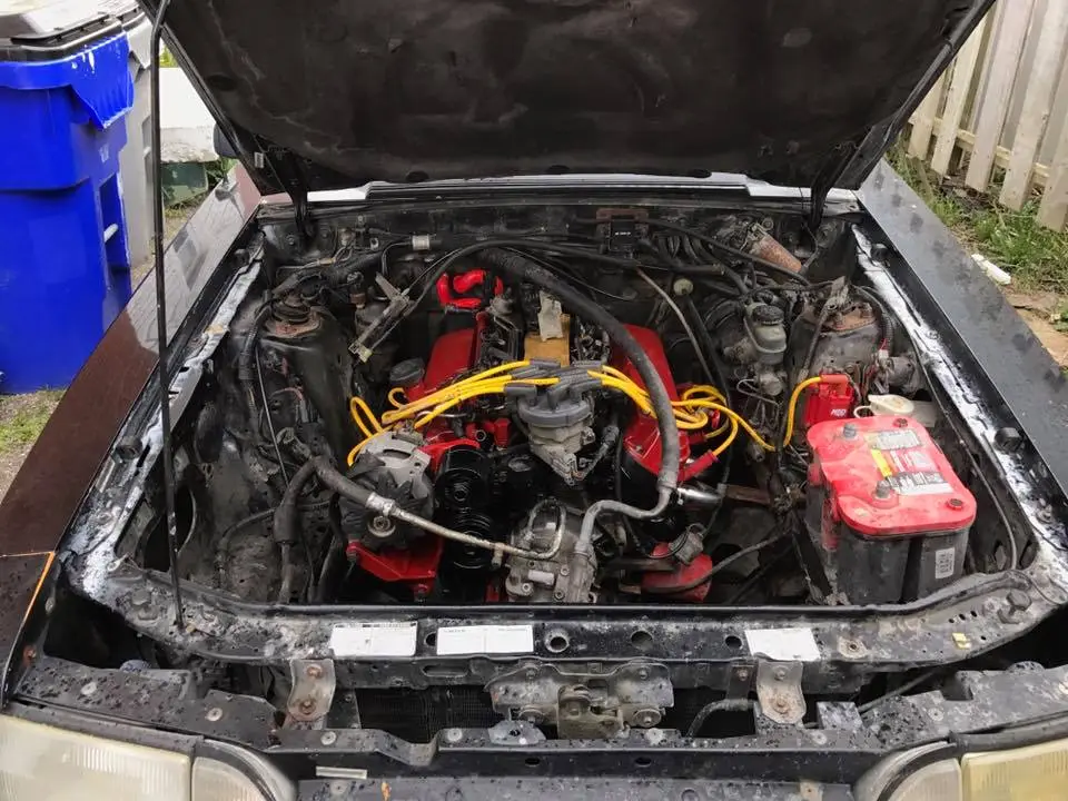

I got some more work done. Dropped off my intake to get the throttle open to 70mm. There also blasting it and plugging the EGR hole in the bottom part of the intake. Clean and painted my heads, Installed my stud mounted rocker arm kit. I also bolted my shorty headers to see what its going to look like. Going to change the water pump and do the other stuff ;) may run weekend. Hope to get it all done by the monday the 22nd.

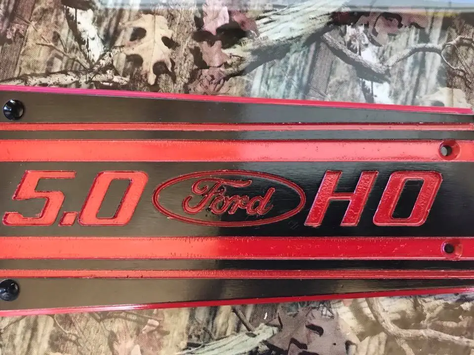

I clean and painted my driver side trim pieces clean her up a little. Going to do the passenger side next. She needs a paint job but it won't be for a while. So this will have to do.

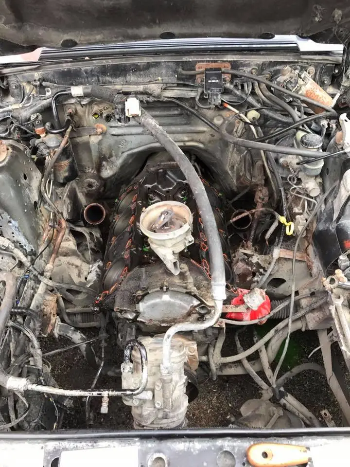

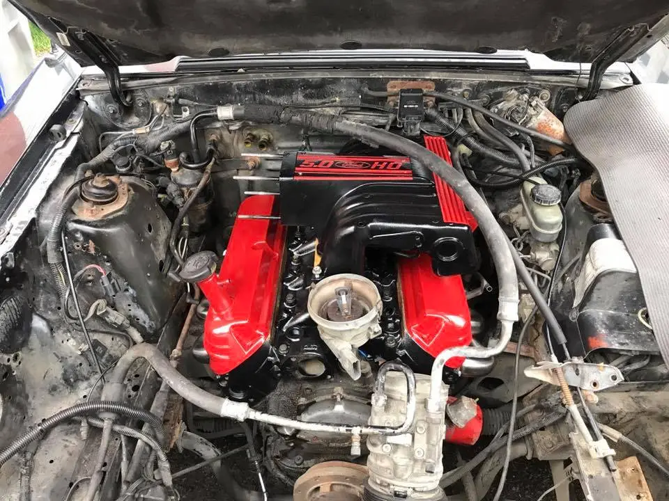

Well its time to clean this up a little and install the new water pump.
So I strip her down the top end and water pump.
Clean it up and starting to go back together.
Checking to see how its going to look done :-)

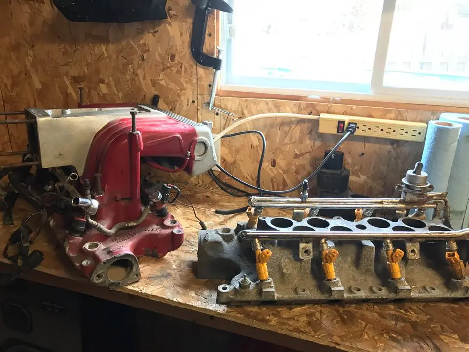

My intake is almost ready to install. The porting of the throttle body opening to 70mm is done. Just have to work on the vacuum lines. Install the water pump, paint the brackets for the A/C and power steering pump. Then she will be ready to fire up. Can't wait, want to drive her again.
