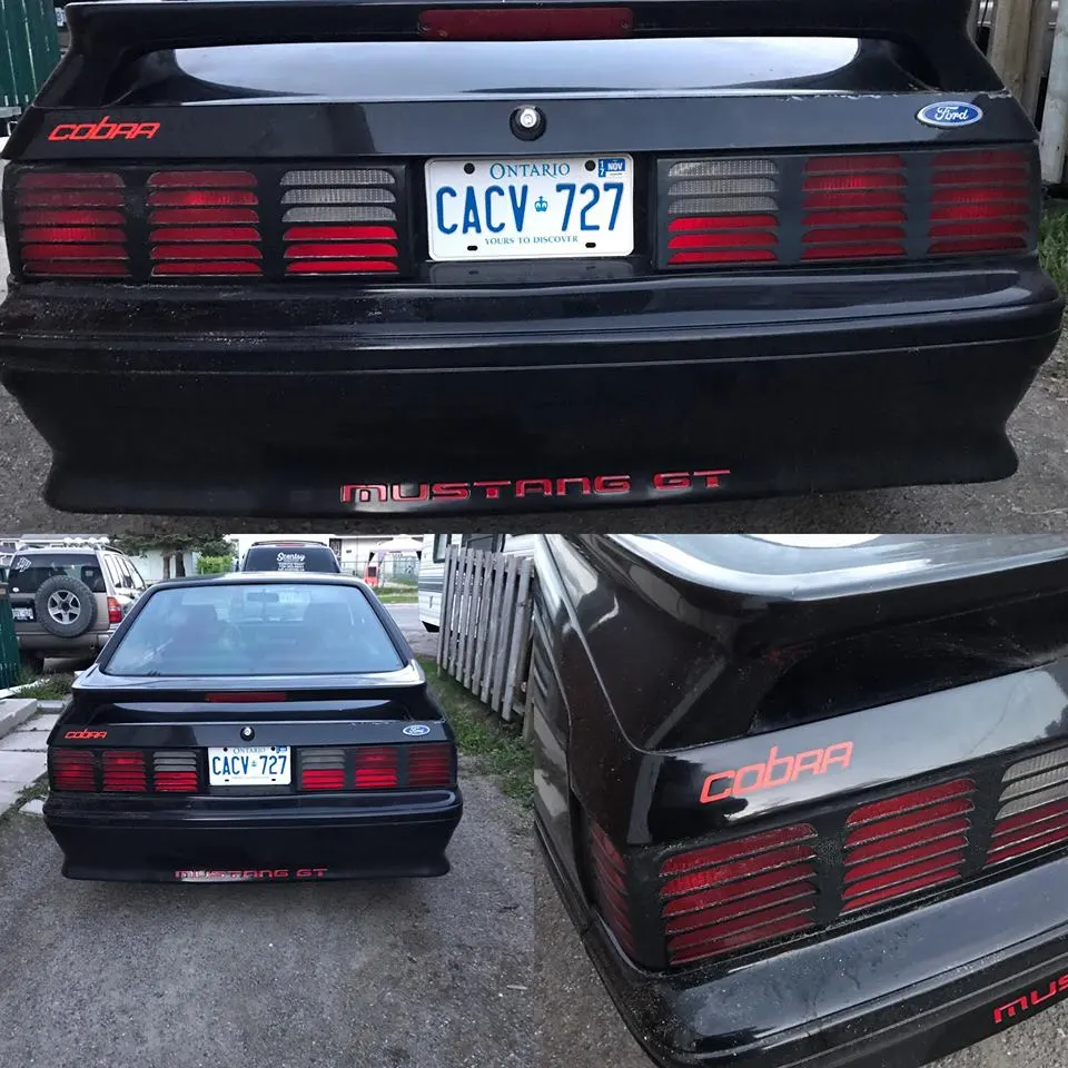

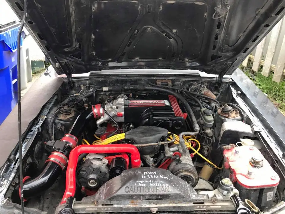

Well I got my car back together. :) Still have to re adjust my valves. I also have a little exhaust leak between header and H pipe.

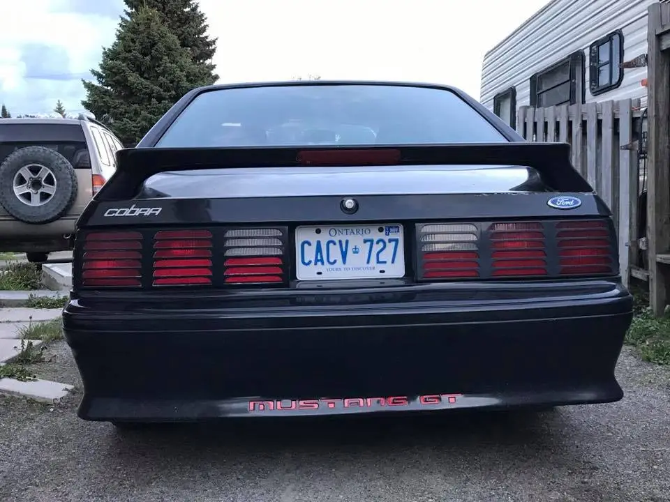

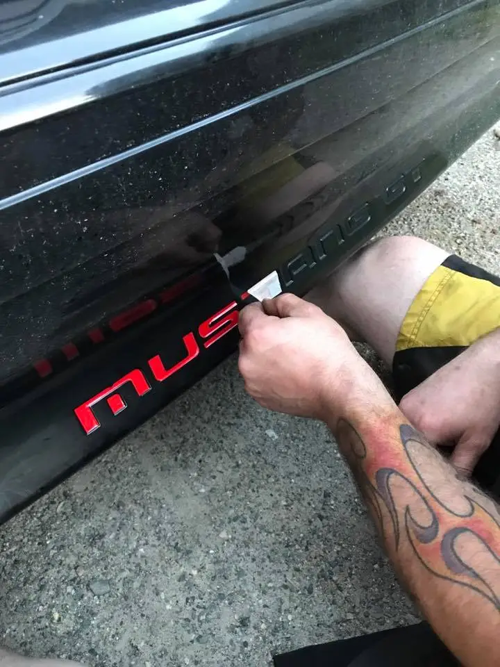

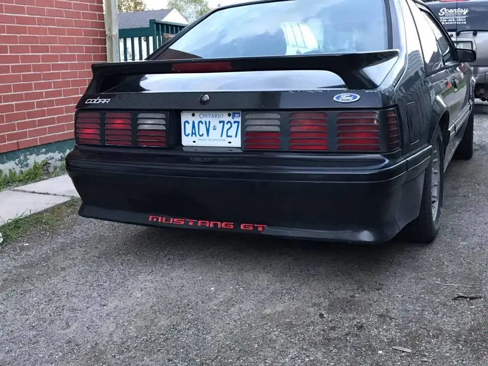

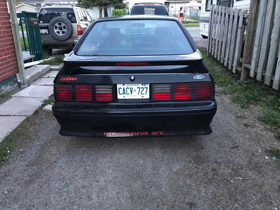

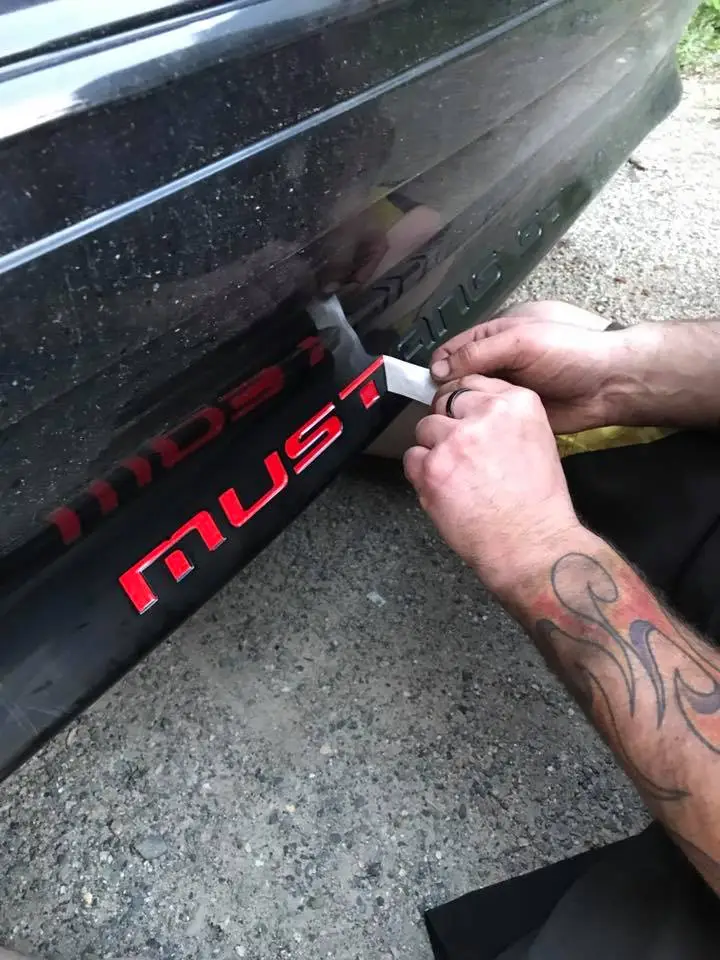

Then I decided to put my red mustang gt stickers in the rear bumper and side skirts.

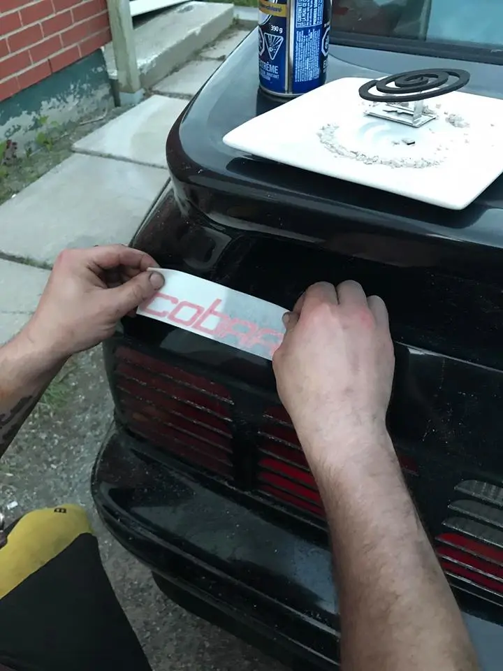

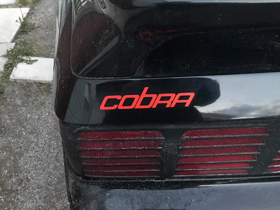

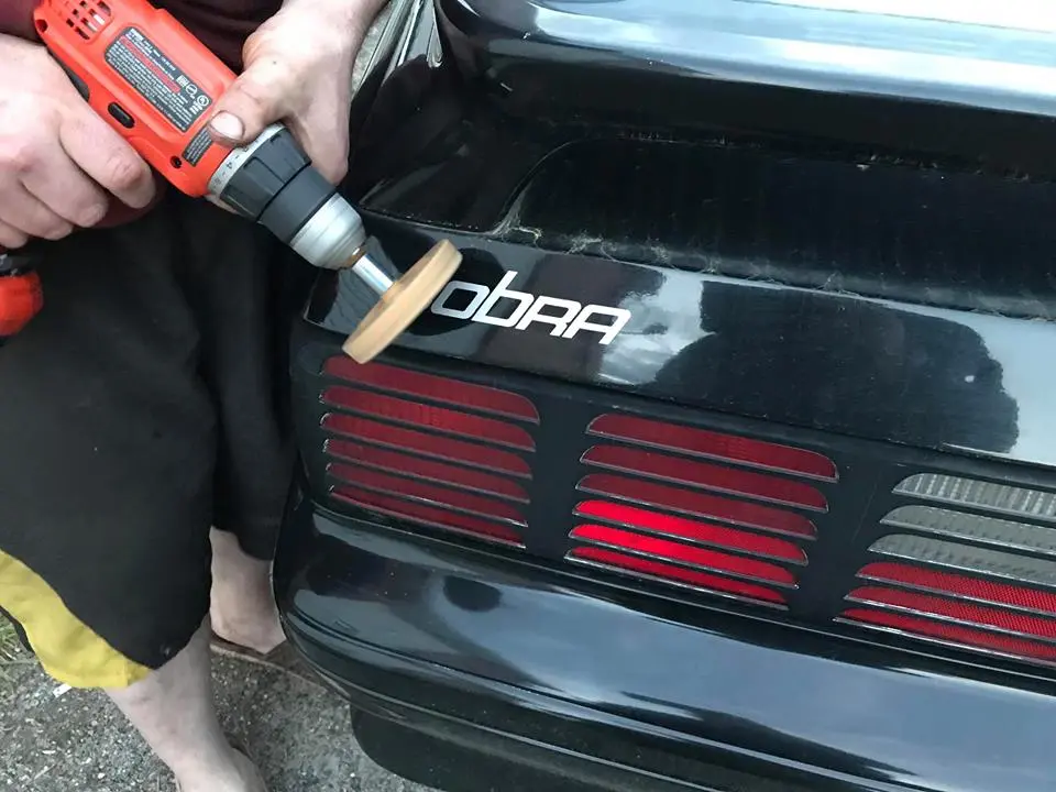

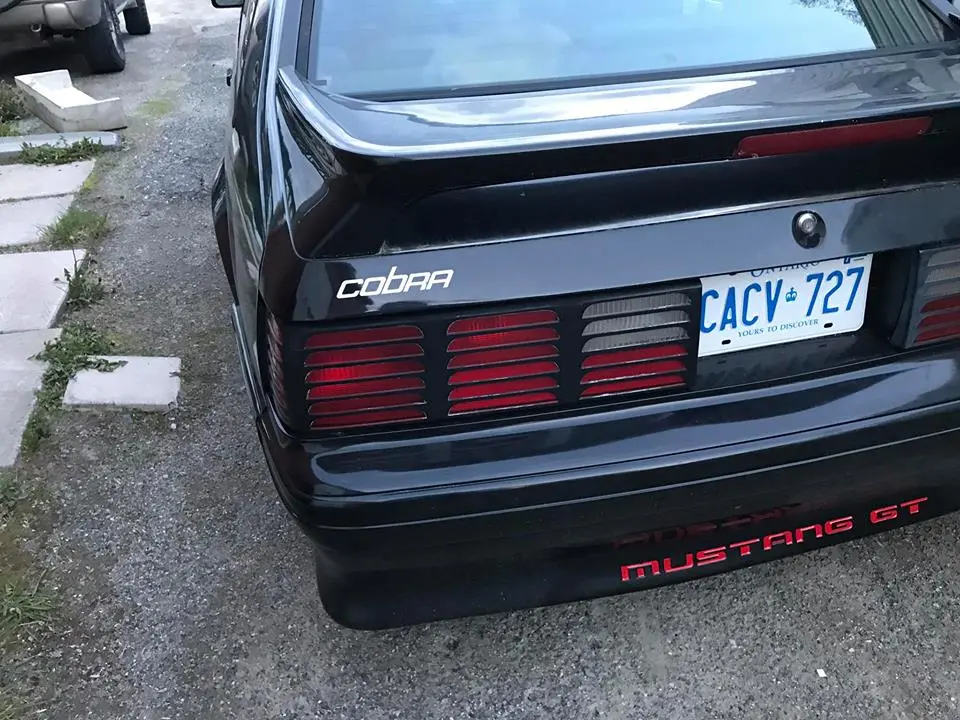

Then I decided to change my CANADIAN cobra sticker to red.
The red is looking good :-).

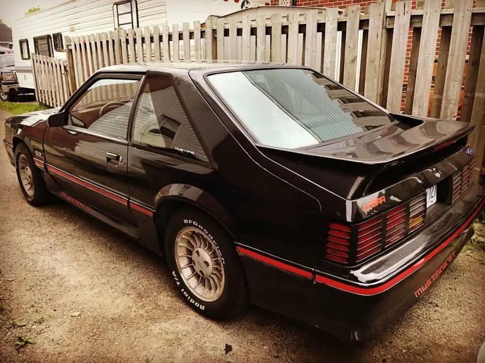

I finally added my red stripe in the body moulding, I think it look awesome. I love this picture of my car. It look so nice. Still lots of work to do. Might do a few little more cosmetic things but nothing crazy. Going to start planning the next step for my car. I'm thinking suspension with sfc's and other reinforcement parts. Discussion coming :-)

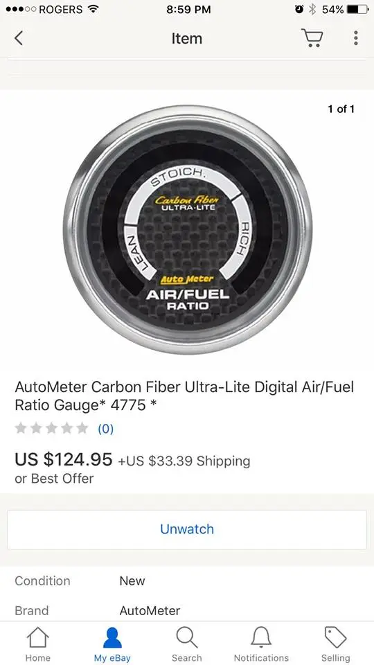

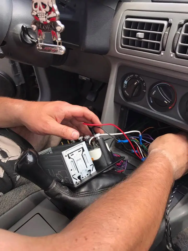

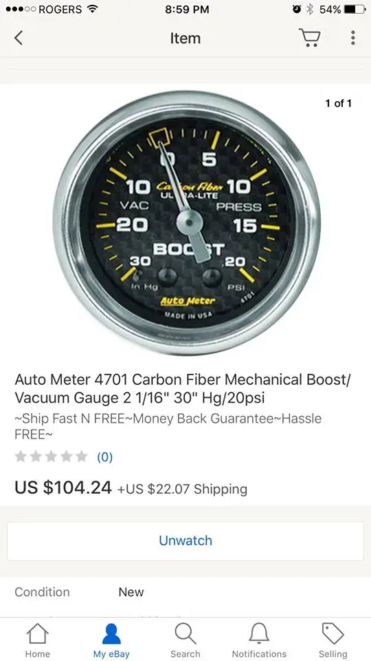

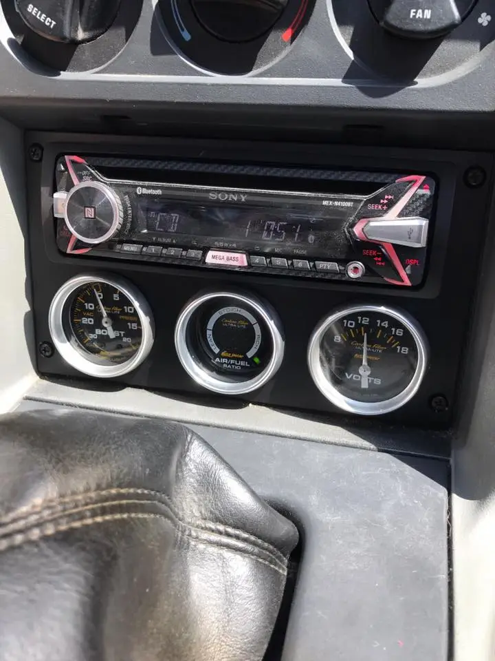

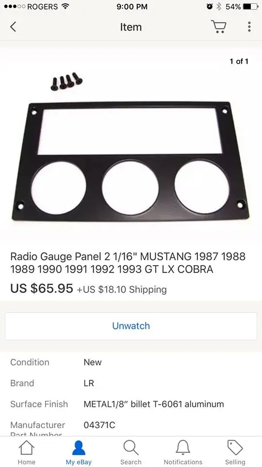

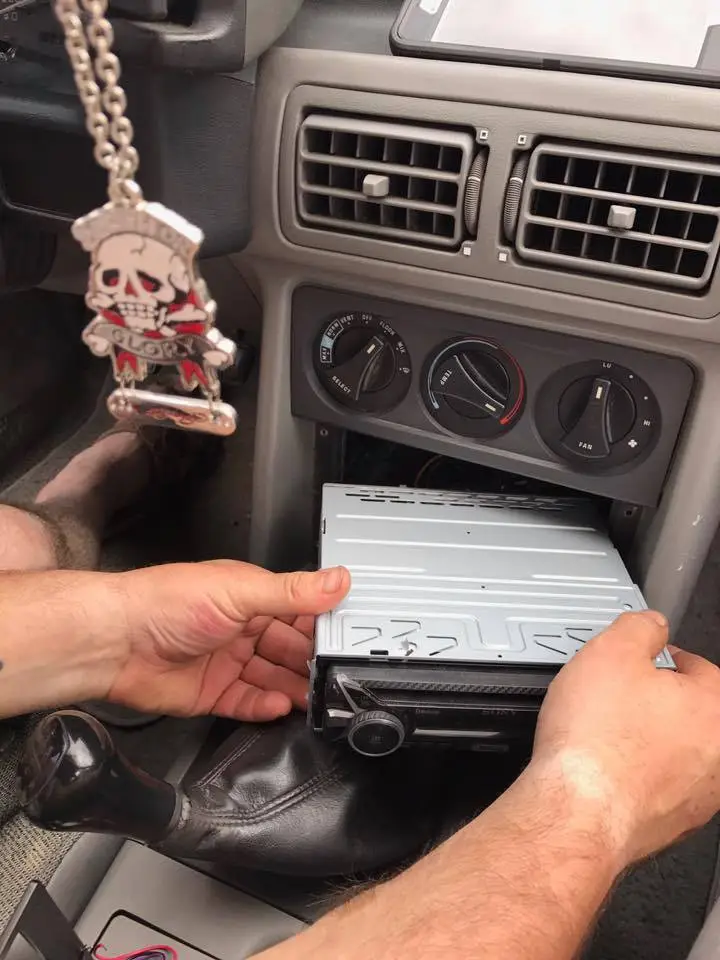

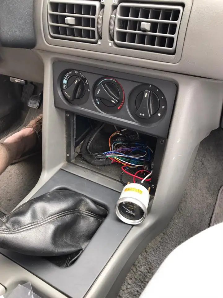

I ordered a few gauges and a stereo face plate. Need a few more gauges to keep a eye on the engine. I know what I want to do with the engine. Have to do chassis stuff first and suspensions. Before I build my motor :-)

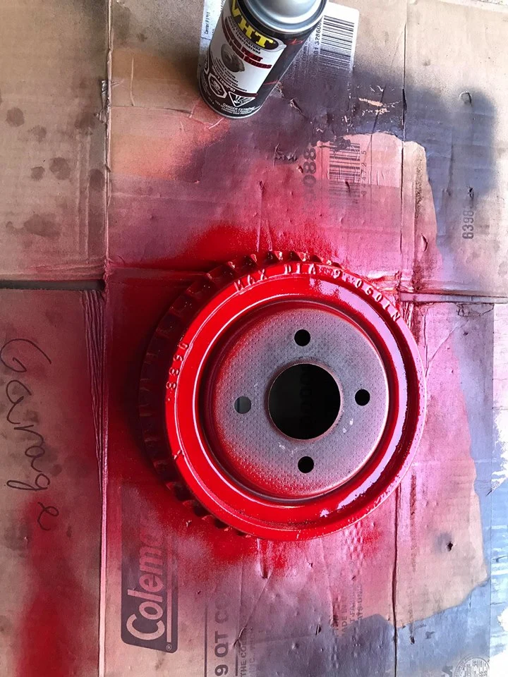

I am also going to paint the breaks RED lol. It will not show much with the turbines, but its the little things.
