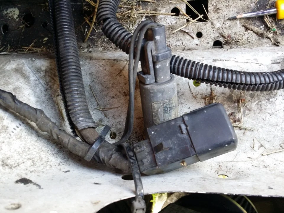

Is this the eec relay? I found it odd I couldn't find it above the ecu but under the hood on the passenger side of the car.

On an 87 5.0 Mustang the EEC relay is on top of the computer. It is difficult to get to unless you have small hands and an eyeball on a stalk like a snail.

Step 1.) The computer is located under the driver's side kick panel. The EEC relay is mounted on top of it. The EEC relay is somewhat difficult to get at. Removing the passenger side dash speaker may help. Remove the 2 screws in the computer mount and pull the computer down. The EEC relay is mounted on a plastic push in upholstery fastener, and may be difficult to get loose. Pull it down to where you have good access to the wires. You will see 2 black/orange wires which are continuous power feed to the EEC relay. Look for 12 volts on them; they do not depend on the ignition switch being in the Run position to have 12 volt power. No 12 volts and the fuse link is bad.
Step 2.) Turn the ignition switch to the run position and look for 12 volts on the red/green wire on the EEC relay. No 12 volts then the ignition switch is bad or the ignition fuse link in the red/green wire is bad.
To check the ignition switch, remove the plastic cover from the bottom of the driver’s side dash. Then remove the plastic cover from the steering wheel. Put the ignition switch in the Run position and look for good 12 volts. No 12 volts and the ignition switch is bad. Good 12 volts and the red/green fuse link is bad.
Step 3.) Good 12 volts on the black orange wires, good 12 volts on the red/green wire with the ignition switch in the run position, no 12 volts on the red wires, check the resistance of the black green wire (EEC relay ground). Ground one meter lead and set your meter to low ohms. Measure the resistance between ground and the black/green wire: you should see less than 1 ohm.
If you see less than 1 ohm, the EEC relay is bad, or the relay socket may be corroded or damaged.

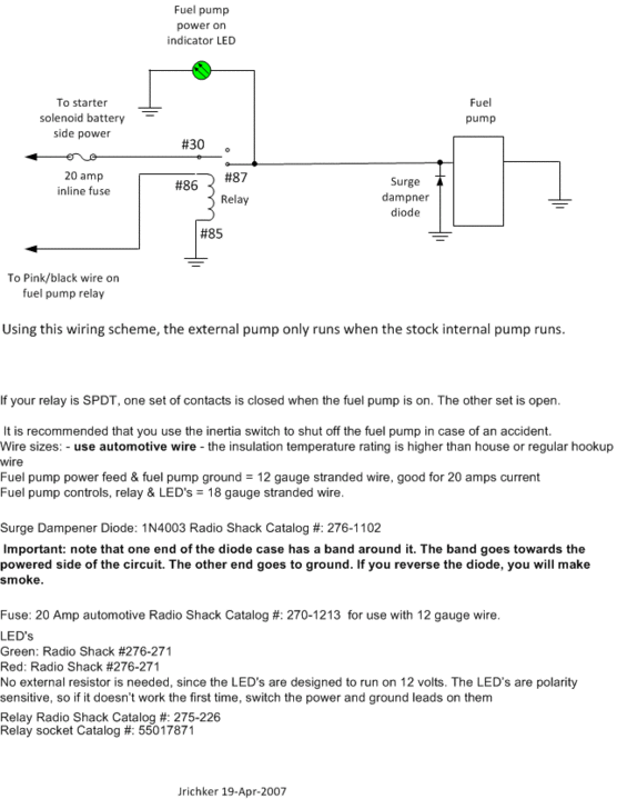

Does that relay control anything else else besides just the pump? The reason I ask is because the car has an a1000 on it and I can clearly hear it every time id turn the key.

The in tank fuel pump is controlled by the fuel pump relay. The external pump is probably wired directly into the ignition circuit, which is incorrect because it bypasses the computer and inertia switch control.
Computer control of the fuel pump: the stock in tank fuel pump circuit is switched on & off by the computer by providing a ground for the fuel pump relay coil. The pump turns on for 2-4 seconds when the Ignition switch is turned to Run. It does not turn back on until the engine RPM gets up past a certain point. This prevents the engine from flooding and washing all the oil off the cylinder walls.
Inertial switch in the fuel pump control circuit: the inertia switch is located behind the driver's side taillight. Its' purpose is to shut off electrical power to the fuel pump in the event of a collision. This reduces the danger of fire in a collision and protects car and driver.

Thanks for the explanation that makes a lot better sense of it. I'll try to jump the eec once I get home today. So in other words the external pump could be coming on either way since it might not be wired to come on with the eec relay. Is that relay a dealer part only?

The fuel pump relay is a common auto parts store part.
fuel pump relay for external booster pump on supercharged engines
fuel-pump-relay-for-external-booster-pump-on-supercharged-efi-gif.530780
