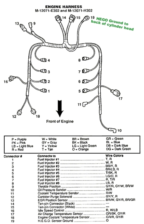

On the back on the engine the "salt and pepper connectors". The white plug has a orange wire that's connected to it but not connected at the other end. Any idea where that wire goes or what it's for?
