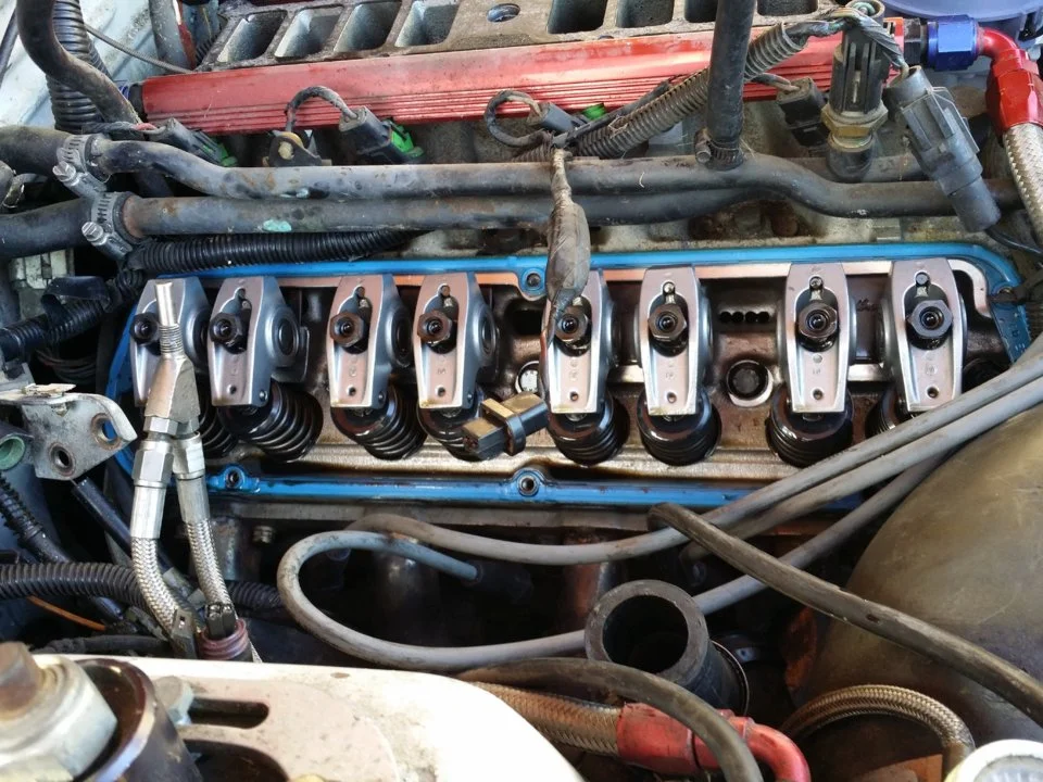

Just did a compression test and I'm totally confused. The engine has no compression in the cylinders. I checked 1,35,7. That would explain why I couldn't feel the air blow my finger off the number 1 cylinder when I was cranking the engine by hand. I got one of the valve covers off I'll post a picture.

Also to answer your question when I got it the distributor was loose that's what made me think that there could be a possibility of a timing issue. I've pulled both valve covers and the engine looks like it was built yesterday. I watched the valves open and close while hand rotating the engine as well. I plan on returning the compression tester and just going straight to a leak down tester to be sure. I just thought I'd try pulling codes as well.

So it went down 8 years ago? Leakdown will answer your rings, which may not be sealing due to time sitting for allot of reasons. Compression should never be zero, you need to be sure the plug fitting is in tight or youll get a false low. All signs point to the likely hood cam/timing being out of sync. Id pull the timing chain cover, first then proceed to pulling weakest test side head.... others posting to you have deep knowledge follow their lead....

Do you have a garage or work space? 8 years, unknown failure, track record of gasket failures.. Take your time, tear it down and see what you have. Then you can reassemble (or machine shop) and drive with confidence. Otherwise you'll always be wondering what's next... if you start now you could be back on road in no time. Do you have a budget for fixing it?

I have a garage to put it in to work on it, and to be honest with you I've really considered tearing it down to see if there are any mechanical failures. The only reason I haven't yet is because I was trying to rule out all the smaller possibilities before I had to go into it. It would suck IMO to tear it down nothing be wrong with it internally, and be back in the same boat I'm in now.
The car seems so close to starting just sounds like its a timing issue. Of course I've been thinking it could've jumped a tooth on the timing chain. I won't to get my timing light on it while it's being cranked making sure of where my timing is, and if I am for sure at the right timing and it still won't start then I'll go through with the tear down.
