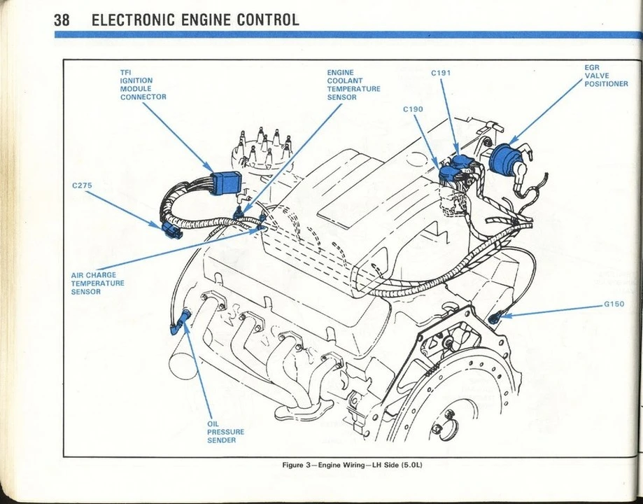

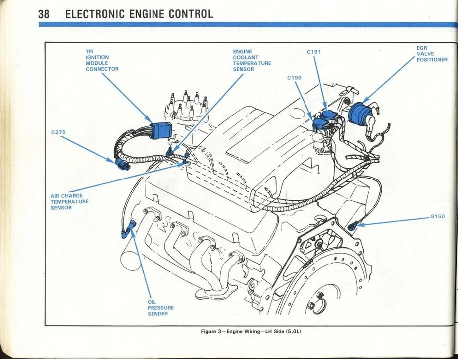

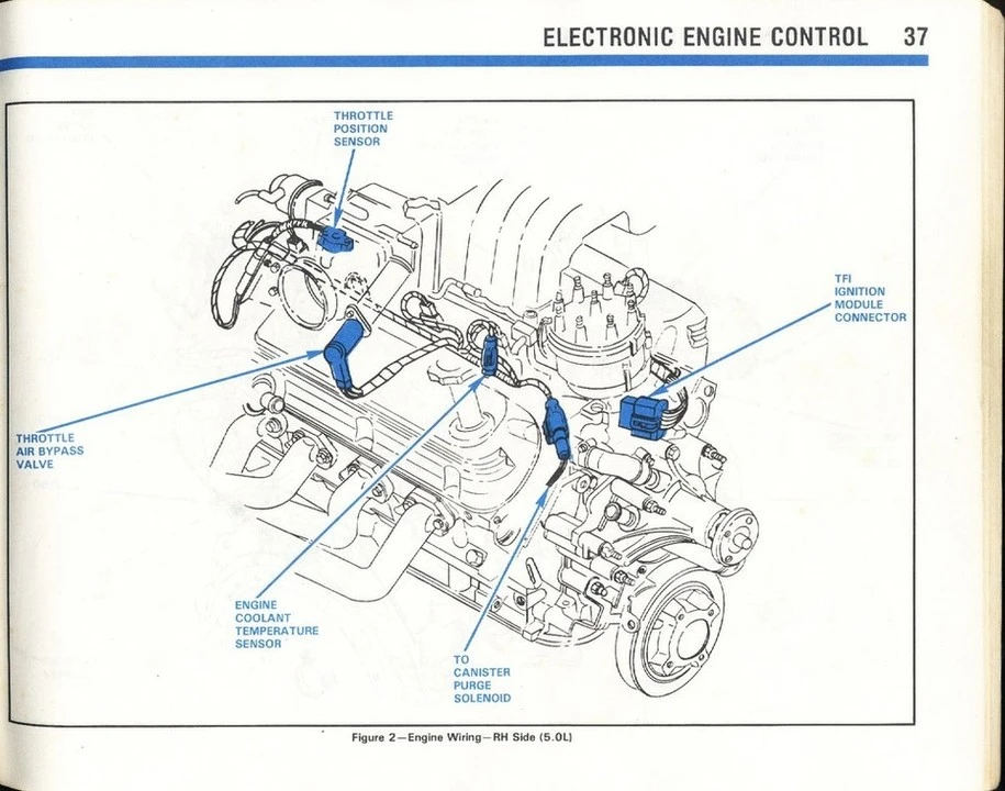

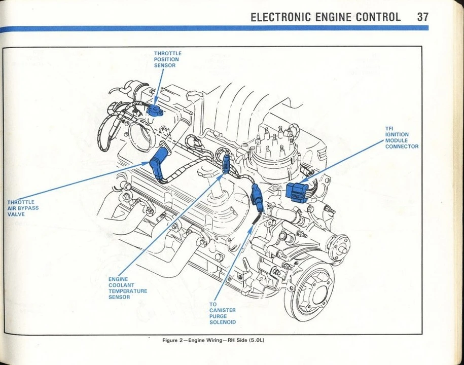

I am having trouble identifying physical locations of ACT & ECT.
My manuals don't agree where they are & what they look like. P.37 & 38 differ.
ECT has 1 wire according to p.38, p.37 is hard to tell, but look like 1-wire. All drawings show 2 wires & a 2-wire connector.
On the car, I can see a 1-wire something on the top of the lower intake & a 2-wire something (ACT) behind it.
On page 38, the thing labeled as the ECT sensor should be labeled as the gauge's sending unit. It has just one wire and is on the driver's side lower intake. As you know, this is only for the gauge.
The ACT is further back (near #5 runner), with multiple wires.
The ECT is on the heater tube on the passenger side. It's got multiple wires.
