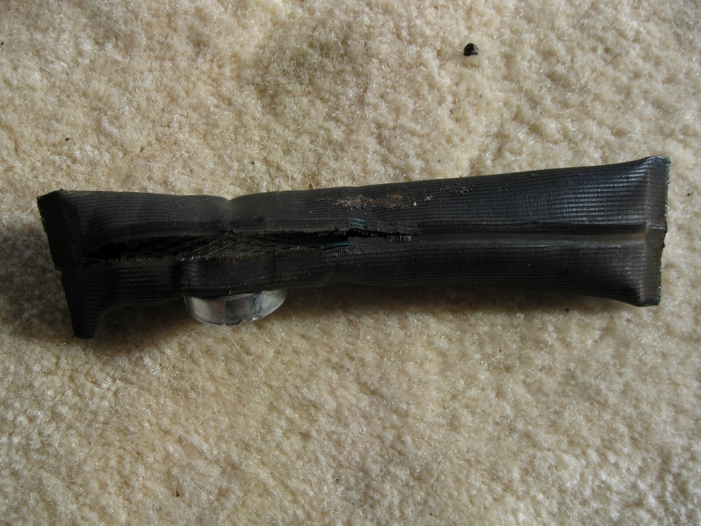

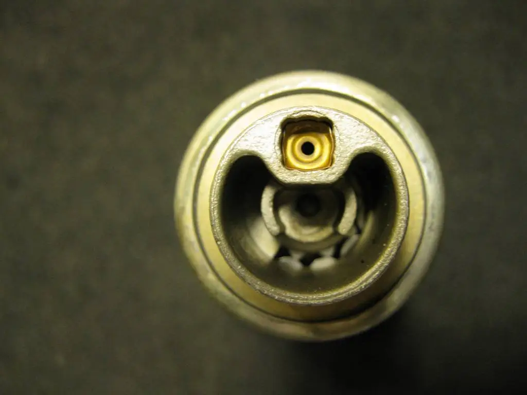

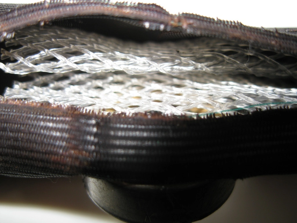

None at all, tank looked brand new inside. Look at the closeup of the sock; this is the way I found it, split open at the seam & some small pieces missing. I think the original color was black or dark red, the nylon mesh inside is still white. Found a small piece of the sock trapped in the cavity of the small orifice on the pump inlet. If that orifice is the pump inlet and not where the gears are shown, it might have been acting as an on-off valve. Pump could still be good. New pump is installed. It's quite a bit different from the 2 earlier ones. Instructions were bogus, following them caused more problems than not. The main pic showed some of the assembly backwards. Wouldn't go together as pictured. Pump is a Walbro GSS342 with kit (includes pigtail, had to modify & solder; rubber isolator; S-hose w/clamps, hose wouldn't fit; tank rubber seal; & some new hose clips). Ran the new pump to evacuate the air & fill all the lines with fuel, no leaks. Only awaiting a blow-thru calibration tube for the new C&L MAF, so have no working meter for the new 30lb injectors.

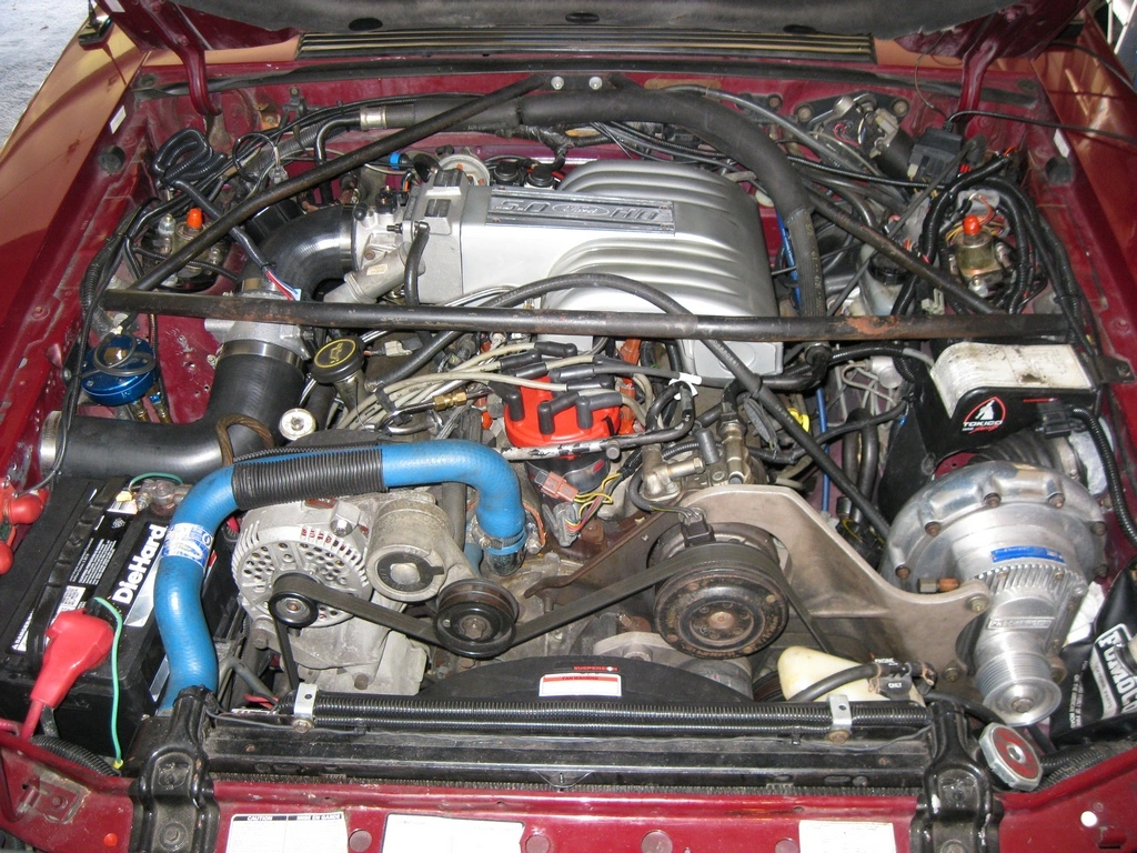

Thanks! It ran pretty good even with the SC belt removed, only went 2 miles around the neighborhood. It ran a bit rich because of the "blow-thru" MAF calibration tube. Exhaust sounded mean. Intake plumbing is a very tight fit, difficult to get a long enough straight run to the MAF. Probably will keep it clocked, so it will idle.

You aint kidding that intake plumbing is tight! You've changed where a few things sit in that compartment, haven't you.

ProCharger mounts on driver's side, battery goes to passenger side, same as the 4cyl. Mounting holes are all there, battery box gets trimmed a bit. Air-to-air intercooler sits vertical in front of AC condenser. Conical air filter is located where washer reservoir used to be.

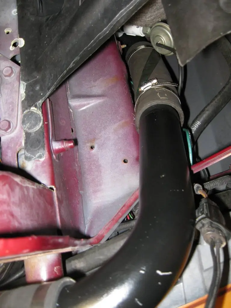

Am now re-engineering the intake plumbing from the intercooler outlet to the TB, with silicone hose instead of the molded rubber ones which don't have much give. The current surge valve (hidden inside the fender) is a bit small, only 1/2". The new setup (1") will fit inside the fender. These items have changed a lot in the past 20 years due to the huge increase in turbos & superchargers. Engine compartment hoses are on the way. The remaining surge valve components can wait a bit. New plugs & wires can go in when the intake plumbing is removed. I've waited 4 months, what's another couple weeks? No job to go to any more.
