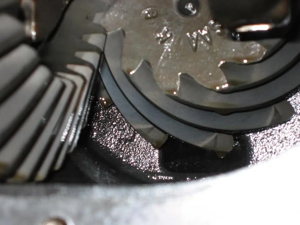

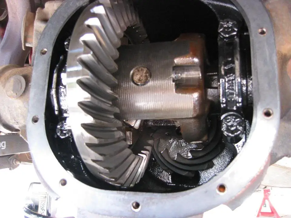

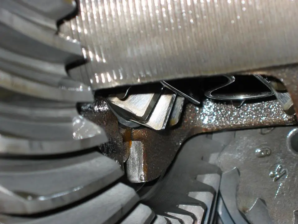

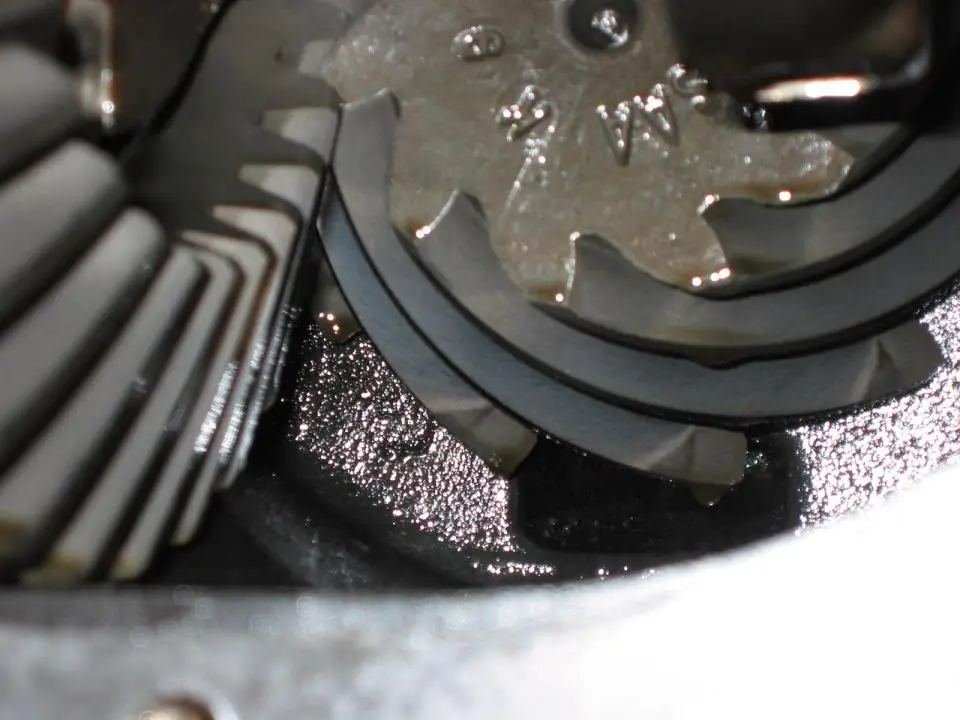

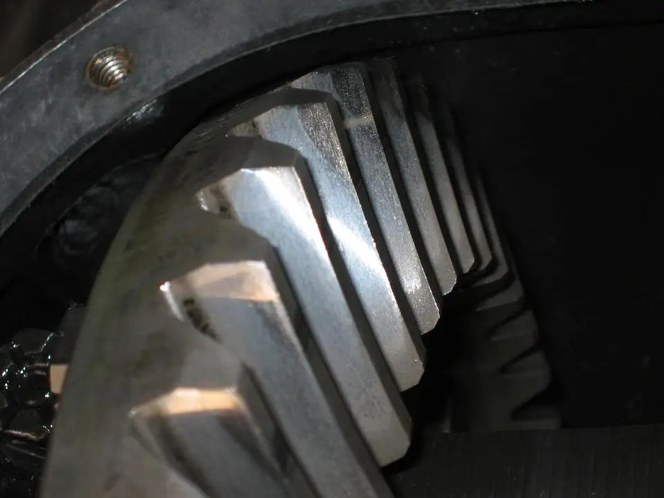

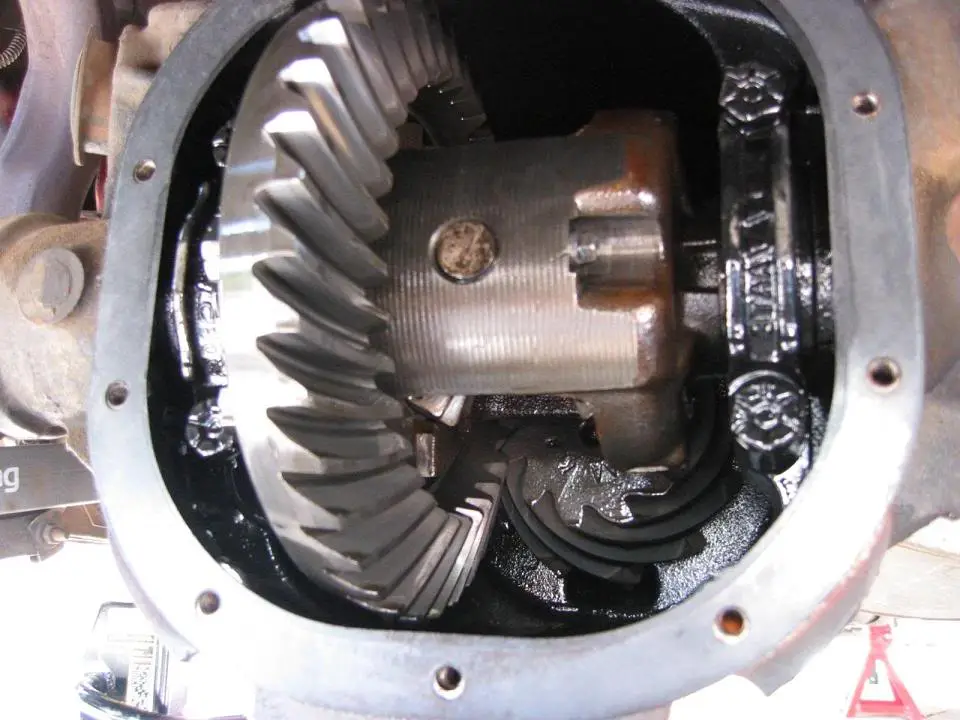

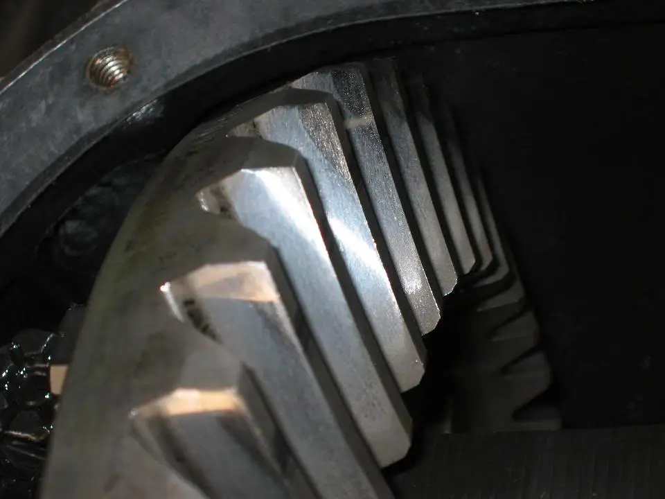

Alright, I have a 98 cobra convertible with stock 3.27 gears, never replaced and I have a horrbile, loud, obnoxious whine. I'm talking deafening. It goes away with the clutch disengaged, and with the clutch engaged and off the gas pedal.

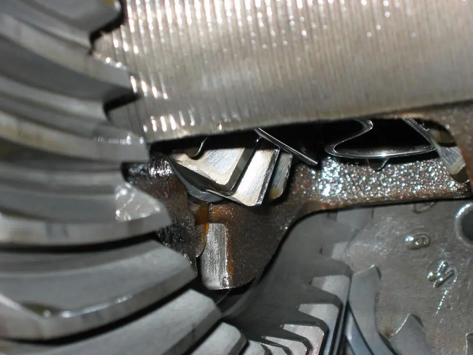

So I took the diff cover off and snapped a few pics. I'm hoping someone will see something out of the ordinary.
With the first two pics I can't tell if the contact pattern is the light part on the whole tooth or the dark part on the outer part...
Please someone help!
Thanks
The contact pattern looks okay (I think...what are those dark features in the first pic?). If the noise is there under acceleration/load and goes away when the load is taken away and given that the gearset is factory I'd suspect an inner pinion bearing.
That is opposite of what I'm hearing. With a lot of load it gets quieter. With 0 load it goes away completely. With little load it whines like a mother. It is at it's worst when I am driving a constant speed, say 60, giving it just enough gas to stay there, REALLY loud.
Doesn't matter which gear I'm in. Shift from 5th to 4th, same amount of whine, change 4th to 5th, same.
z1n said:
What is that dark pattern? Is that normal?
I don't know what that is, but the pinion looks to have a similar mark where it contacts the ring at that spot too.

1fast4by said:
How many miles?
The pattern on the outside of the ring gear tooth doesnt look right either, I can see where it is matching on the pinion. Is there a taper on the gear where the pattern is? It looks like it has been improperly set up, and if so may have caused some gear wear as well as bearing wear

A buddy of mine, who knows a thing or two about cars, said that the wear pattern looks a little deep and may cause the whine.

1fast4by said:
Id say you probably have a bearing problem. But it looks like the rear is set up incorrectly.
Yeah, I take back what I said earlier about the contact pattern now that I've looked at the pics with a half decent monitor. It appears that the pattern is biased too far toward the heel of the ring gear teeth. Perhaps a tad more pinion depth is needed... Anyway, if they're truly factory, they've been like that for a good 7 years now. If the noise is a recent development and it's from the rear it'd certainly most likely be bearings. After 7 years, I wouldn't suggest changing the setup on gears...I'd just replace them with FRPP 4.10s (you've got a Cobra after all...)
While in there, have them check those pinion bearings :D
1st off, the black part isn't important, from the pictures ,I would say it is fine. You should see the shiny part in the middle which is the contact patch, it should be middle to inner. I still don't think that is causing the problem. I believe now that it is a pinion bearing. Get some 4.10s or 4.30s, inner and outer pinion bearings, install new gears and be happy. You have to pull the carrier to replace the pinion bearing anyway. At least 4.10s...... :D
