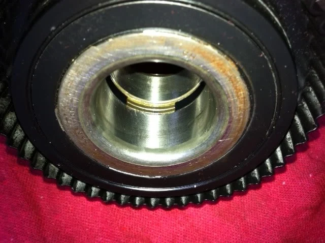

After reading the above link, I'm going to pop these apart for the hell of it.

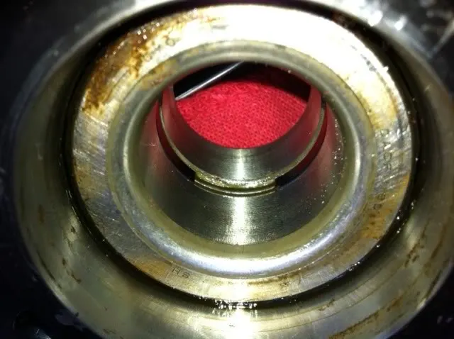

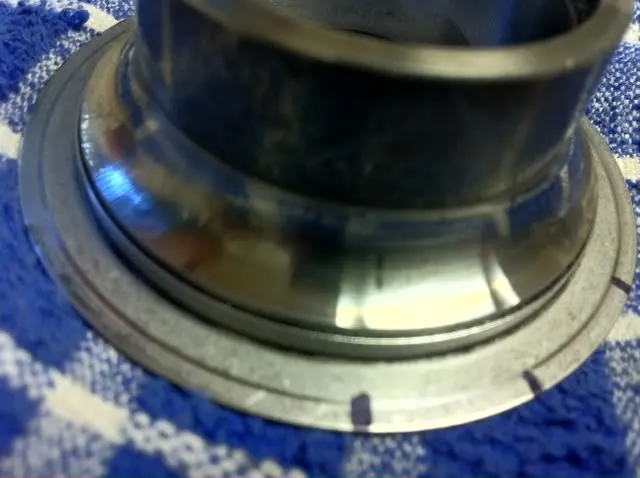

Bearings read: KOYO, DACF111OD?, SH
It's tricky to get a good photo of this. I took the hub apart and felt these grooves right away. I marked the outer edge with a pen, of where the 3 grooves were. I think (hope) this is my problem.
