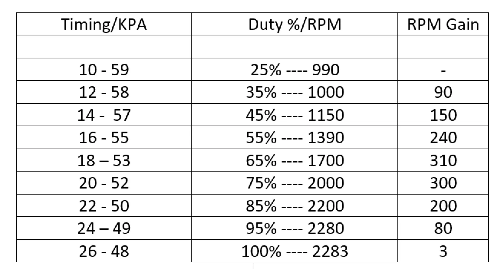

Ok, ran from 45 - 100. fixed timing @ 20. I must have been doing something wrong before cause the rpm actually changed this time as I went through the different valve positions.
Also took the time to sweep timing. 10 - 26 degrees, IAC locked at 20. (If you can't tell I'm trying to follow your videos)
OK, I finished following your idle setup videos. It is much smoother and stable now, and best of all I (for the most part) understand what I did and why.
