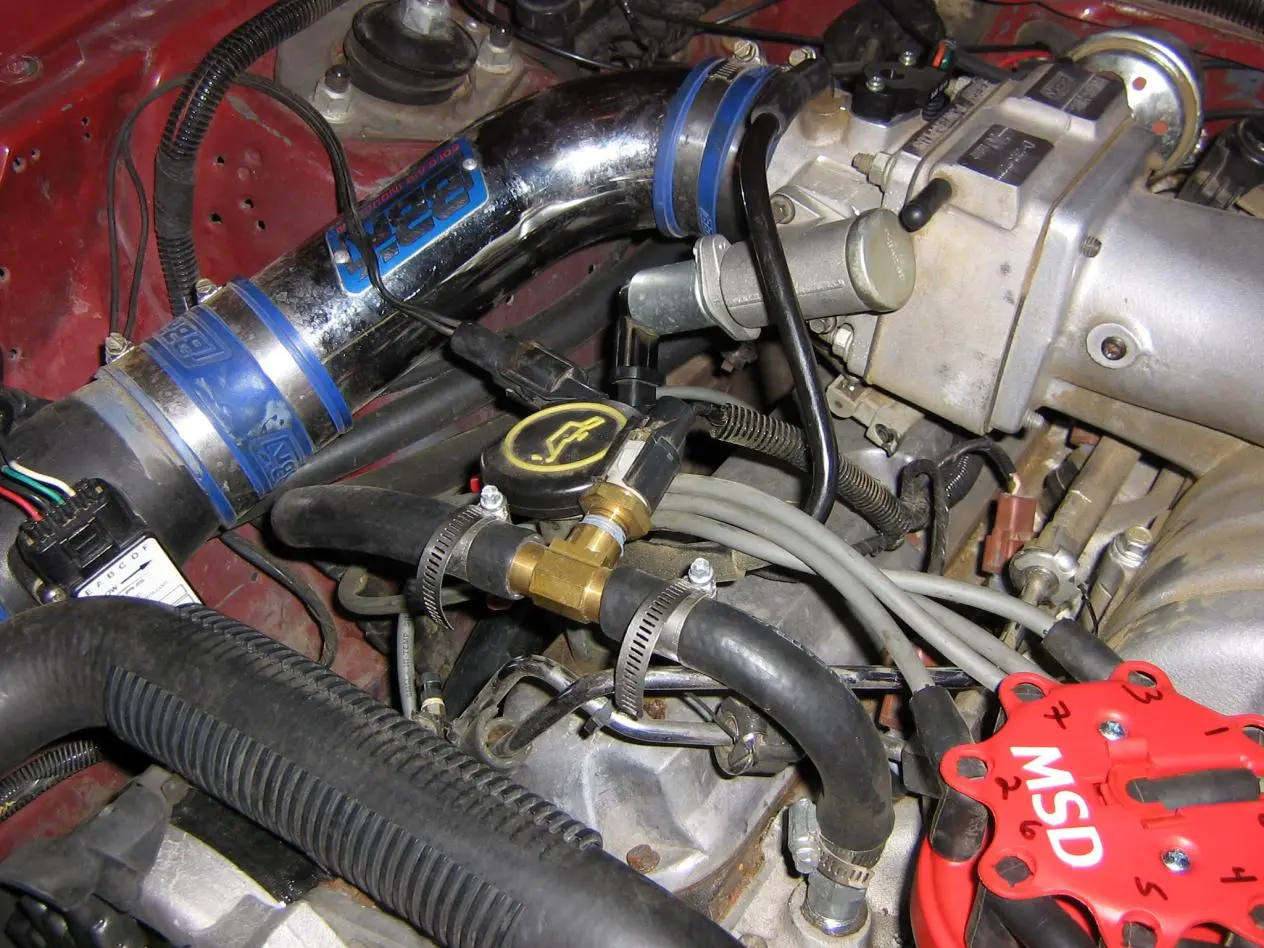

well, i redid the KOER test with a fully heated up car....still got the 21. see attached pic of how the ECT sensor is rigged up.

Is there not a spot on the back of the lower intake you could route the ECT sensor too? My Heater Core setup is just like yours(rubber hoses), but I put the ECT sensor in the back on My Cobra intake.
I dont see why it wouldnt work the way you have now. usually if there was an open in the ECT wiring it would throw a code 51, which a ECT circuit open code. So im inclined to think the wiring is fine as is.
