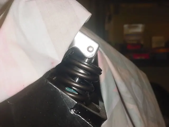

here is a pic of what my setup looks, i couldnt get any good pics of the roller tip on the valve stem.
plus one a few rockers the roller tip was FLATTENED, one was real bad. but only 3-4 in total had flat spots on the tips. so pretty much the rockers are junk.
and the lifters are in fact pumped up from what i can tell, there is no slack in them and i cant push them down at all.

Think real long and hard about what you want,a set of new heads/rockers and gaskets will set you back near $1500-$2000.I would shop around for a nice used set with rockers,there are good deals out there.Those valves are definately wrong,a new set is $200 and a set of rockers the same so for maybe $600 you could be back in business..........

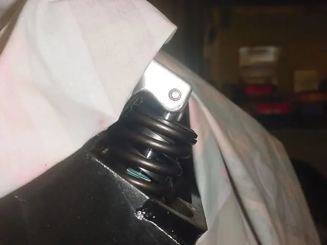

You definately have a serious problem there. Whether it's the retainers, keepers or the springs themselves, something is not right. Here are my Manley SS valves installed into P's.

Foxfan88, if I was in your shoes I would contact Mike (Thumper) let him know what is going on and see if he can send you the right parts or if he has any recommendations. Those are some good heads set up right. Honestly with the right parts you will only need 2 tools and you can assemble them yourself. Or send them to him, but I know shipping will hit you pretty hard.
