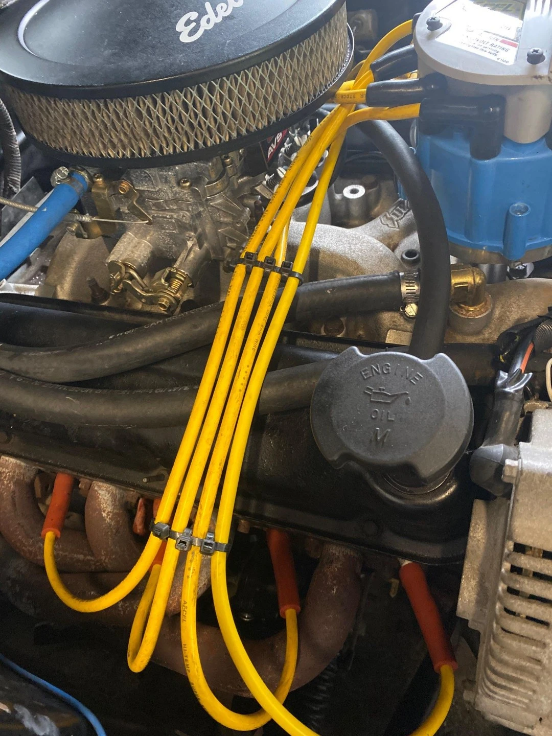

Having it looked in to tomorrow. I've got new wires that we're gonna cut to the proper length and new plugs, just to start. Once we verify everything is dialed in correctly, if its still not running right we'll move on to the distributer, cap/rotor then re time it. Hoping its nothing more serious then that.
Wiring re done

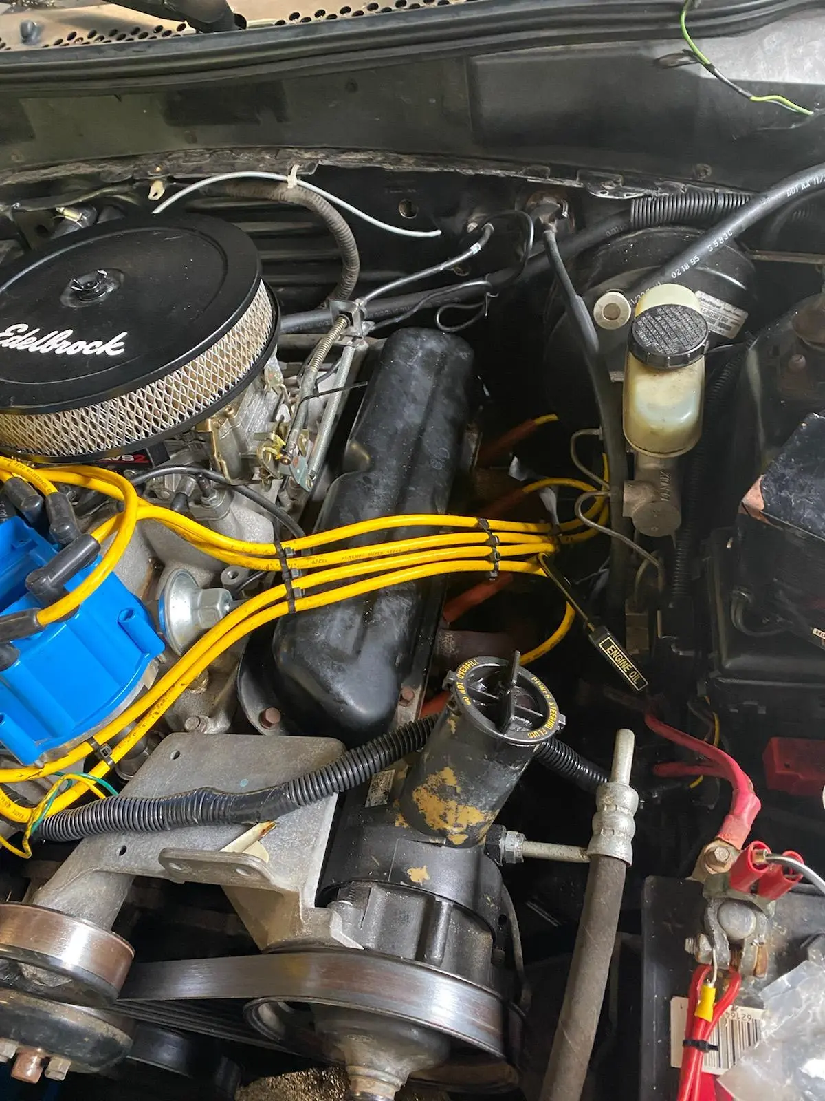

Apparently there was a second fuel filter back towards the rear of the car along with a disconnected vaccume line below the distributor. So we're gonna remove the front fuel filter and re connect that vaccume line and see if that makes a difference.

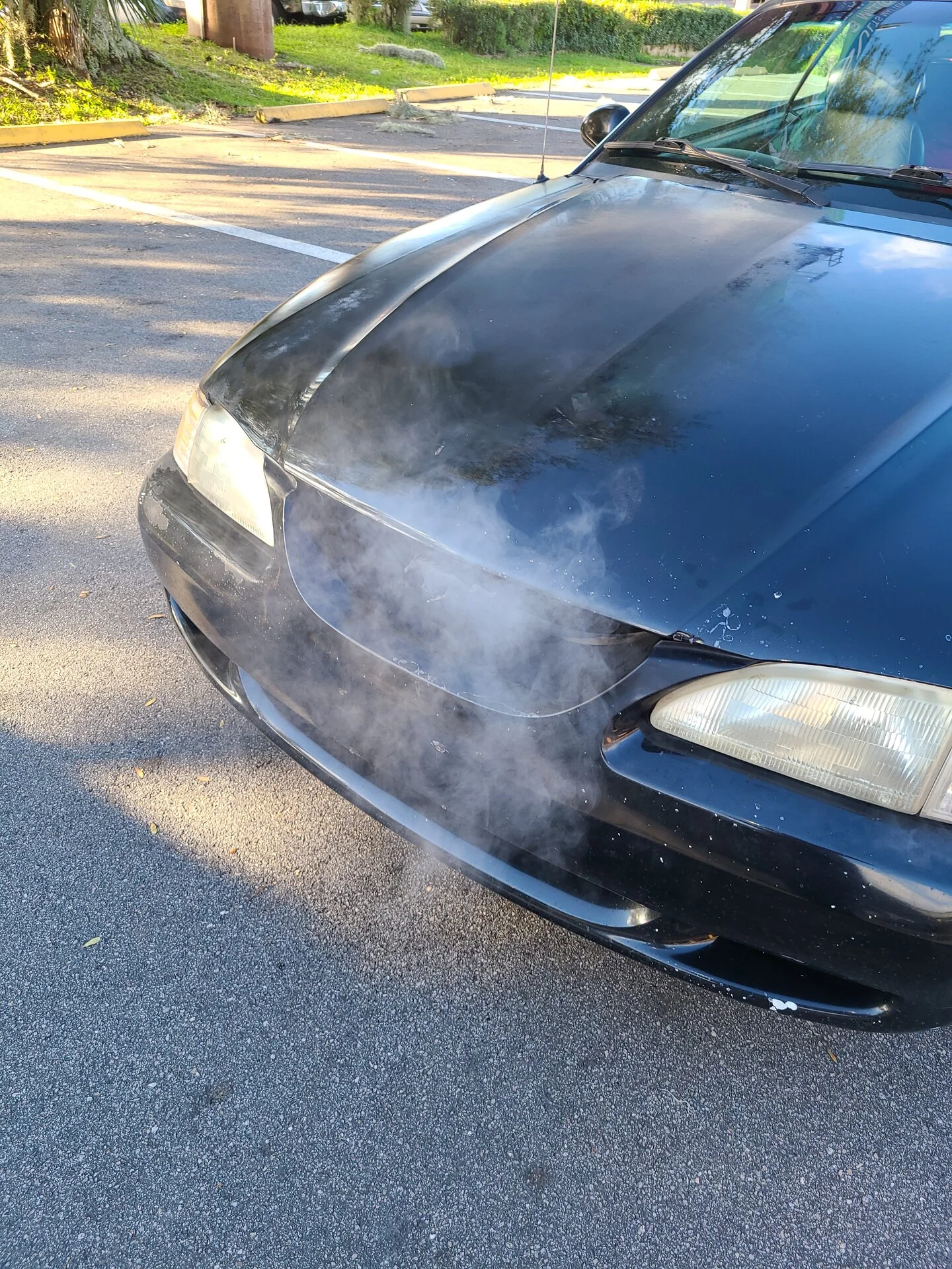

Filter is new... motor seems to be running fine...however when I was taking it from my buddies shop to get an alignment, since we replaced the entire front suspension and rack and pinion it overheated. For some reason the fan isn't coming on. Gonna check into that today. SMH...Hate getting into someone else's project where we have no idea what was done...

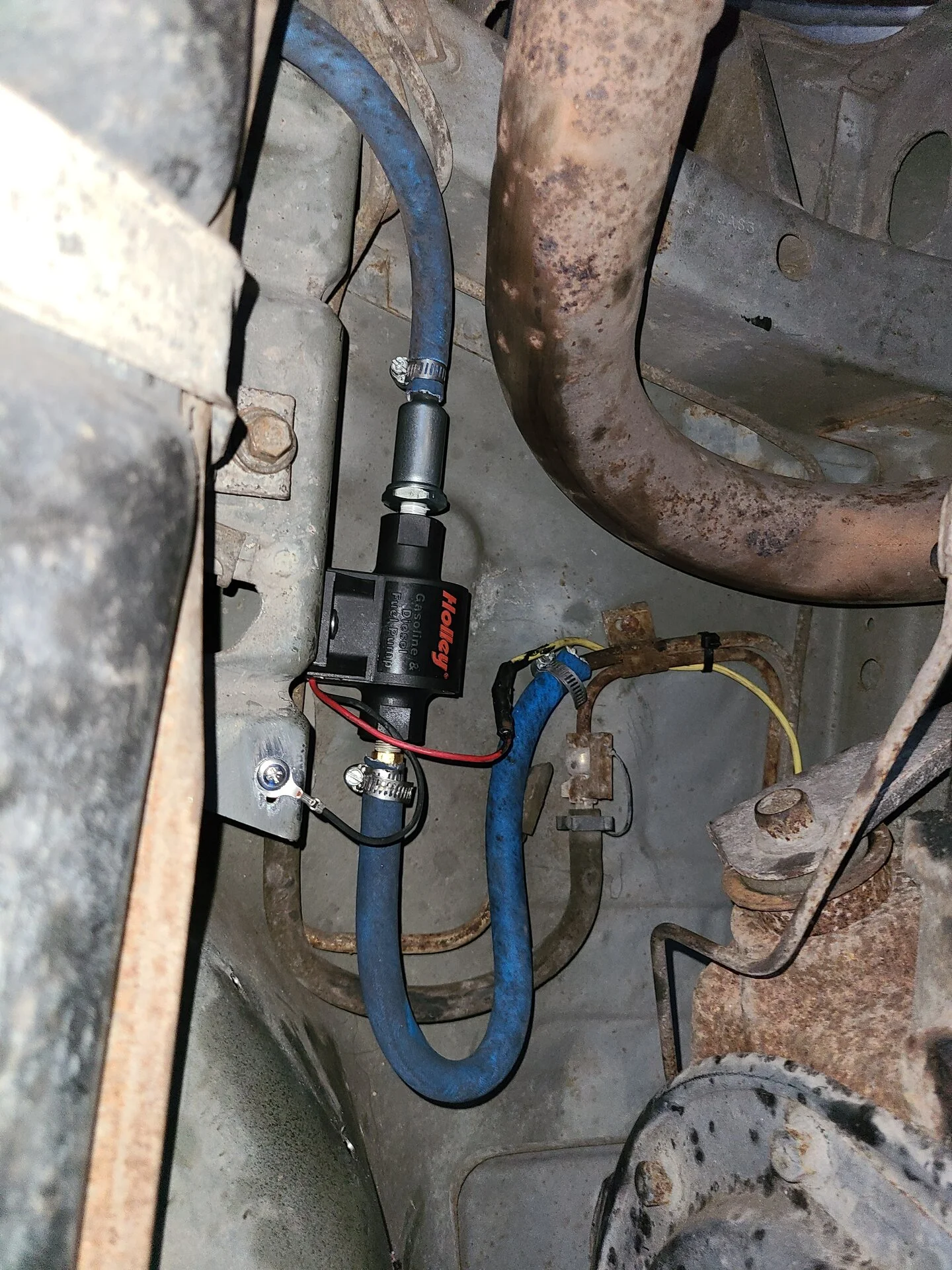

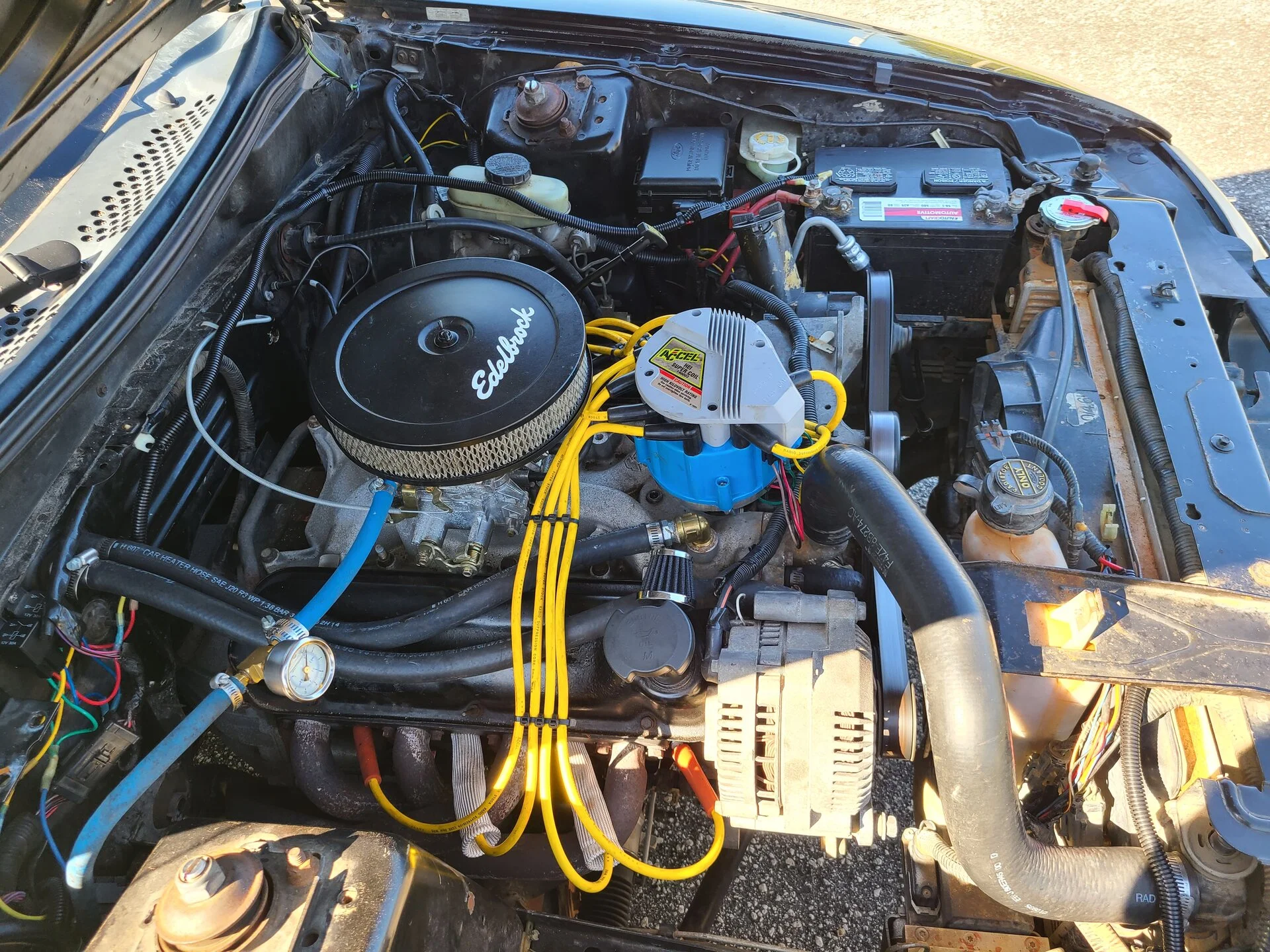

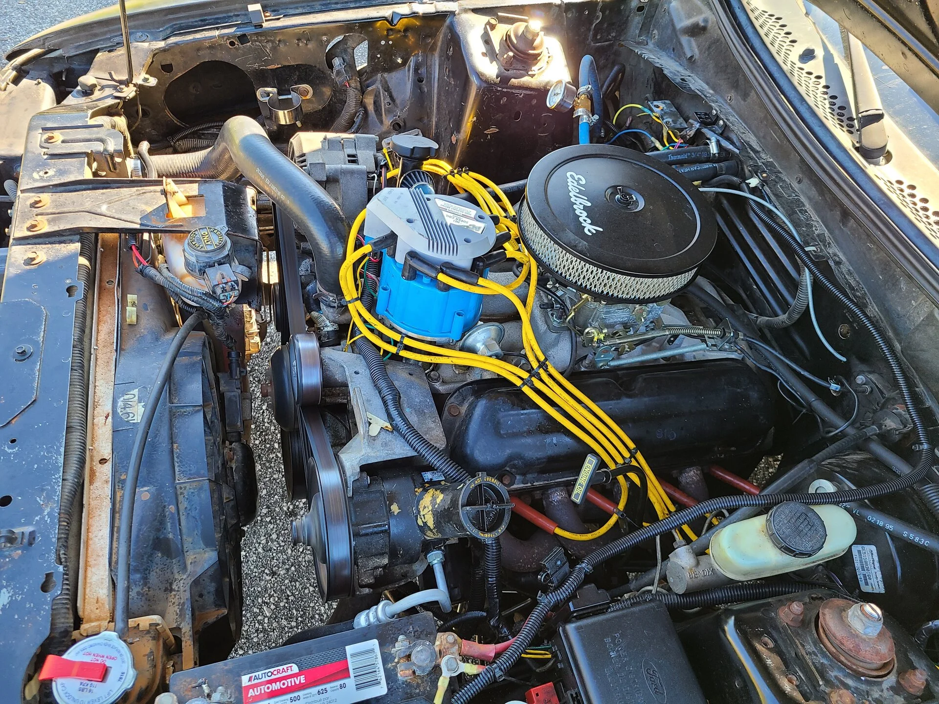

Final result so far. Removed fuel filter from under hood. There is one on the fuel pump. Removed fuel pressure regulator. Rewired everything, re did spark plugs/wires. There was a vaccume line disconnected under the distributor. Fixed that. Replaced steering rack/pinion, tie rods, ball joints, sway bar links, oil pan gasket, and new power steering lines. Drives/rides beautifully and runs A LOT BETTER. Still has this studder sometimes under acceleration. Not sure if it still could be the timing is off, or the carb needs adjusted. Anyone have any ideas?

I will say, in that last pic showing the pump/filter, is real close to that exhaust pipe, I would move it or at the very least insulate it from the heat that exhaust pipe is going to generate, the low fuel pressure required for carbs are very prone to vapor lock.
Yeah pretty much anywhere you mount it next to the tank is gonna be pretty close to the exhaust. Really nothing we could do about that.
