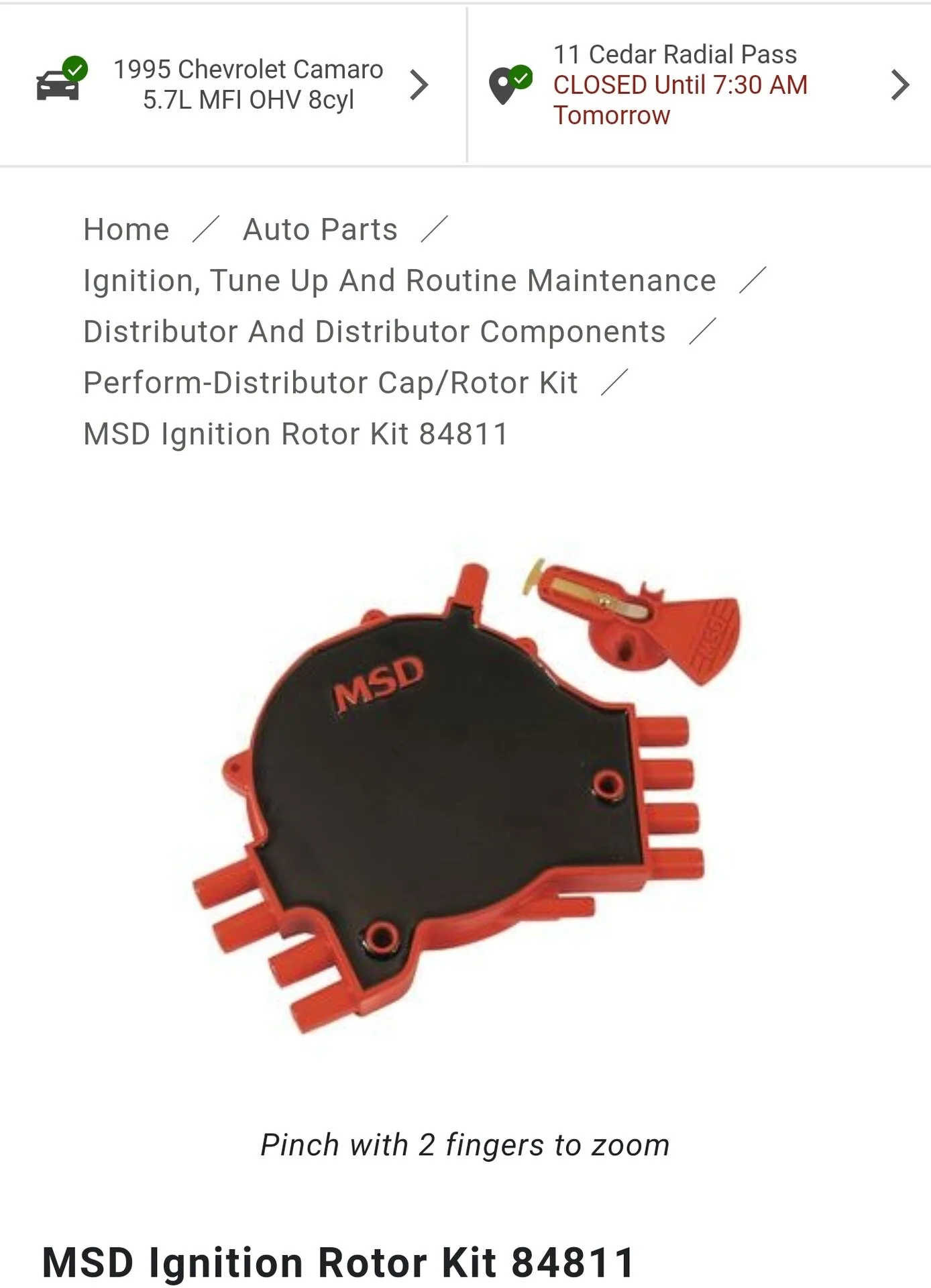

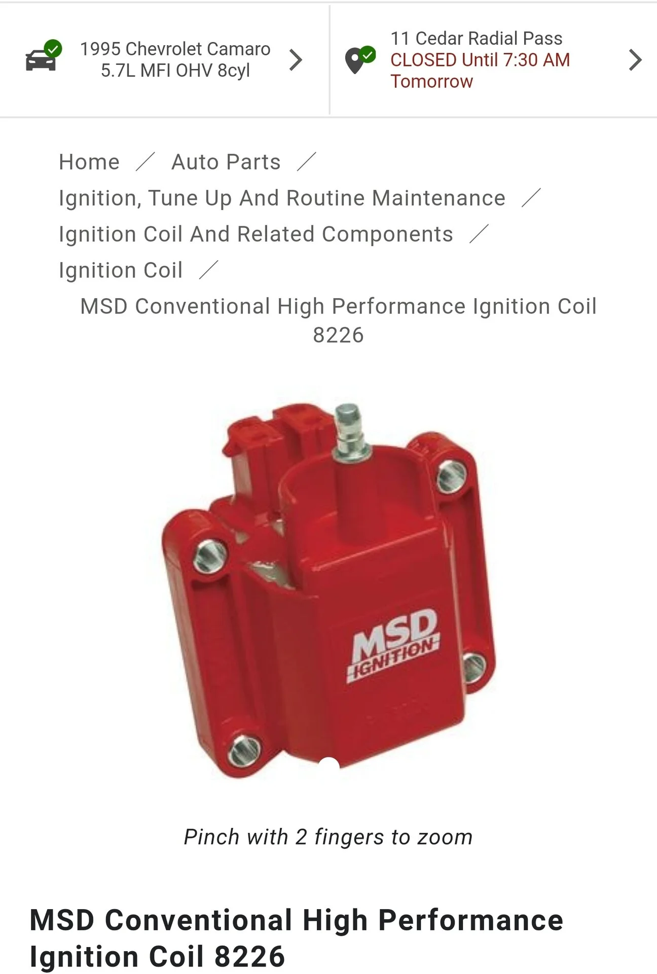

So, what coil should I buy? You said stock GM, but specifically, which one? Sorry for my ignorance. Gotta break it down barney style for me.
Reactions: Lawdawg86
Assuming this should work...
MSD used to be the go to but now just chinee junk, ac delco, echlin work just fine, let them race cars use up that MSD junk.
Good old copper spark plugs too, none of those wizbang triple platinum three pronged high dollar whatever John Force wannabes say you need.
I just looked up a hei cap/rotor and coil for a gm 350. That's what came up.

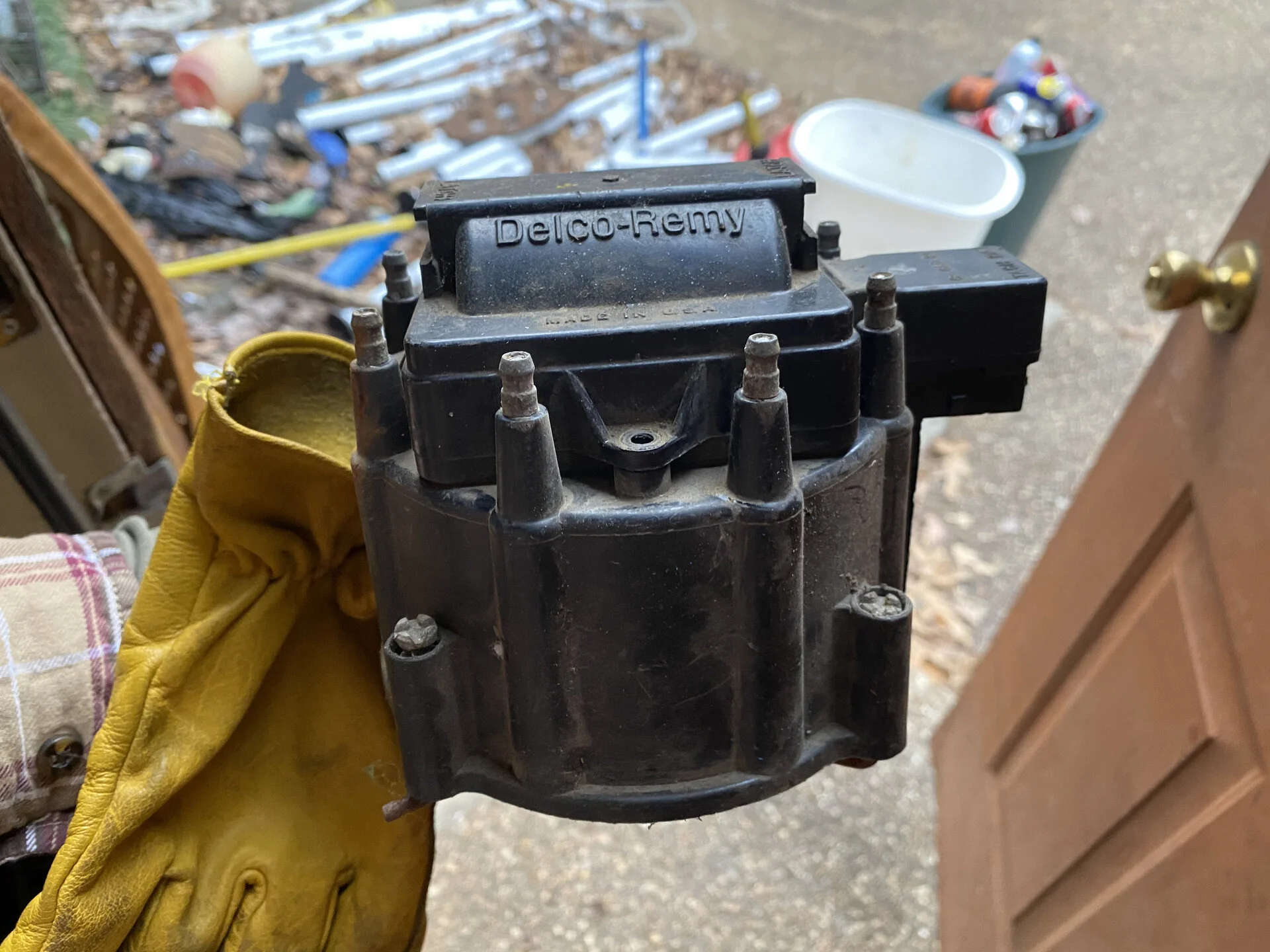

It’s a black/blue rotor, a black cap, and coil is the same, fits in top of the HEI rotor cap. I’ve got 8 or 9 sitting in the shed. Here in a bit I’ll send a pic of an old one. It’s a two wire setup. One for power, and one tach. It’s the easiest part of the entire engine
Reactions: General karthief
Here’s an old one I had laying around. I keep them around just in case one on the old truck gets a crack in it. I usually polish up the points in the caps and sometimes folks that throw them away give them to me when they do a full tune up.
no need in buying one of mine. They’re super cheap. I’ve used coils off gms and Fords before. No big deal. As long as your car is wired with the two wire HEI system any GM cap will work. The coil, cap isn’t expensive at all at the auto parts store
