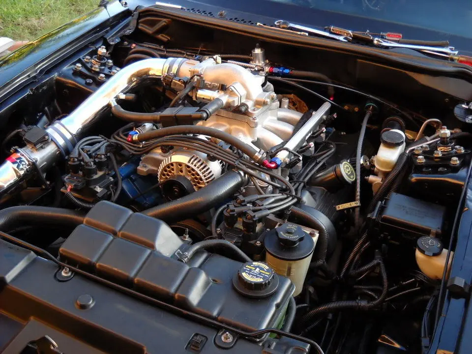

well i got the edelbrock on, and its missing realy bad, it idles fine, but as soon as i rev it, it misses, ive changed the spark plug wires, cheaked for vac leaks, adjusted the fuel pressue, and nothing makes a difference!, the only thing i have not changed are the spark plugs, im thinking maybe some coolant got on them, the car was apart for a week and a half, so if there was coolant on the plugs was sitting on them for a while:(
any ideas?
i feel like i always answer these questions, not ask them!!:mad::bang:

on a better note, it looks sick on the car, it makes it look like a realy motor

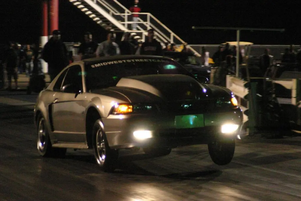

Side note, I saw my first carbed 4.6 yesterday at the Buick vs. Ford shootout in Noble, Oklahoma. He also had the Victor Jr intake. Looked very clean without all the wiring mess normally associated with the 4.6's. Wish I would have gotten a picture of the motor. He said he lost a little throttle response, but he didn't think it really hurt the low end power. The car ran hard as hell. I think he said it was running 10.80's on a 75 shot. Here's a pic of it launching...

Holy hell
