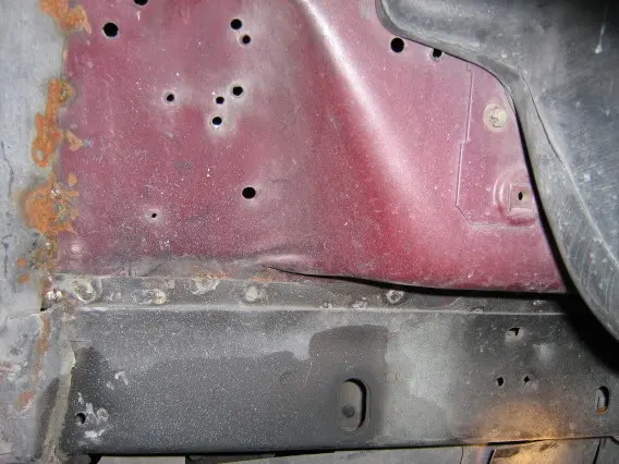

The sound of revenge is thumping in my head. Since I have been on the unemployed side of things for the last couple of weeks, I decided to take the downtime to work on the stang and complete the engine bay prep. I was checking the vacuum hoses and changing what ever was cut or damaged. I removed the fender well cover to get at the rest of the lines and made another discovery. The front part of the inner fender was red.:bang: :bang: :bang: The car had been in a front end collision. It wasn't in the Carfax report at all. The passenger side fender is a replacement and most likely a few parts of the front end. Now I'm worried, because I don't want to drop a brand new motor into this car and have to worry about crap handling.
It doesn't look like the strut towers, k-member and steering rack was ever damaged, but how the hell can I tell with nothing in the car. :bang: :bang: :bang: I don't want to sell this car to someone else and a junkyard would never give me what I paid for it. Is wrong to want to drink that bastards (the guy who sold me the car) blood? I can't beleive this.
I just snapped a few pics. It's all forward of the shock and spring, but I'm still paranoid now:

The repair doesnt look too bad tho, just a little wire wheel action to that rust and then get some under coating and cover up the bare welds. As long as your schock towers are all squared up you should be alright. Even if that was a crappy repair, it would only hurt you in an accident, if at all. Dont worry about it, a repair can last as long as the rest of the car as long as it was done right.

Looks like the rails were bent over in that picture. As long as its in front of the shock towers and was pulled straight, you should be fine.

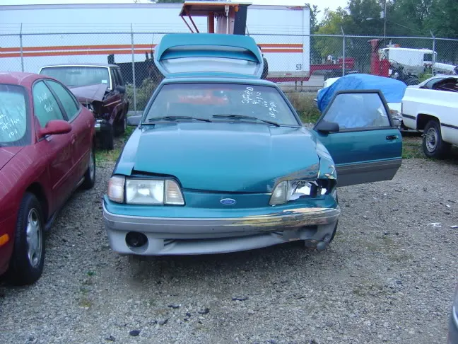

Probably looked like this, this is how I bought my mustang, and it will not show up on carfax, liability only from the person that wrecked it.

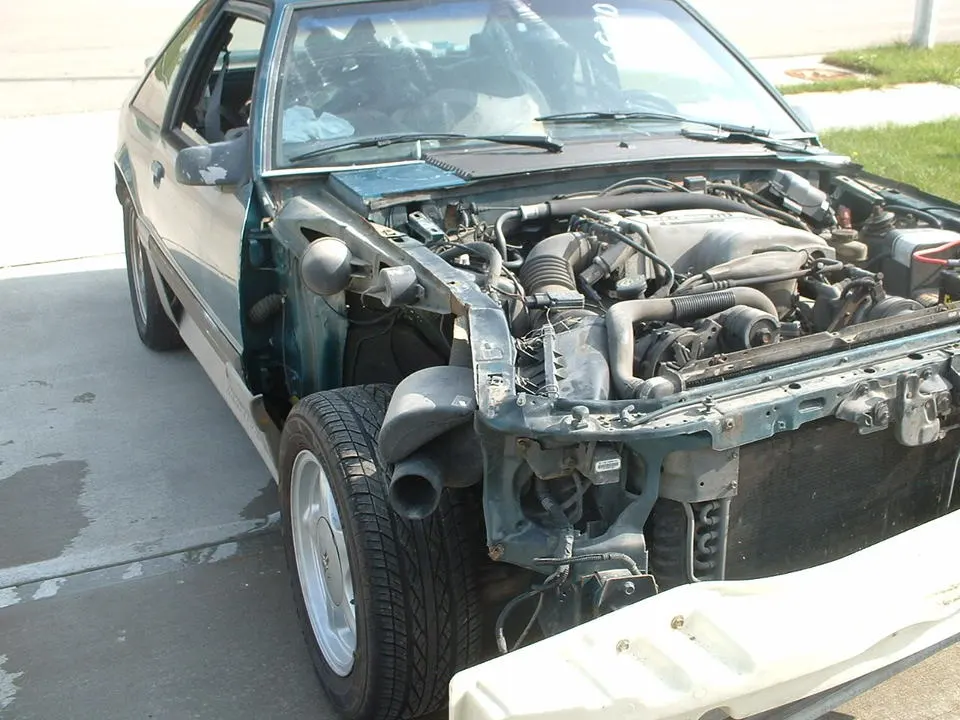

damn 89gtstalker, I feel better after seeing what you were able to do with your stang. I have been looking through the rest of it and it does not seem all that bad. I think I just over reacted when I saw it because it was something that was not expecting.
