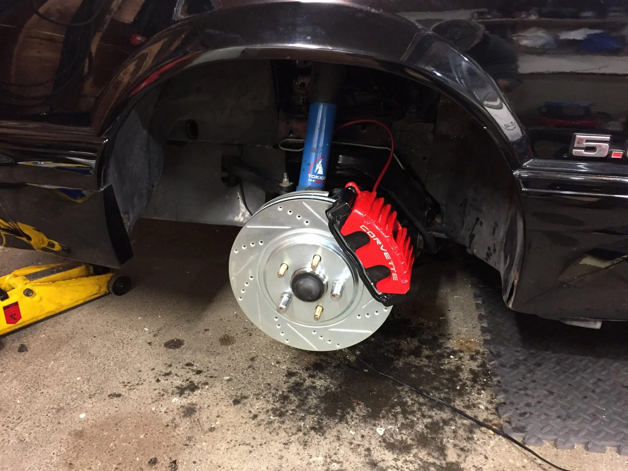

Will look something like this, except say Baer since they use the same PBR castinh
However, you are spending $280 shipped for the correct brackets. I think you said you already had cobra brakes, so you can reuse your rotors, and possibly the brake lines

You should post a pic of the calipers just to confirm but they are basically identical PBR castings to the c5/c6 and 05/06 GTO. That means if you ever need parts in the future (pads, clips, pins, boots) you can source parts for those cars rather than going direct to Baer.
