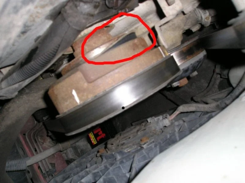

I was changing my oil in my stang and I looked at my balancer and saw a rubber piece moving out from under my balancer and was wondering if it was an issue.
I attached the pic.
Thank you
Tom

I put a breaker bar on it and ratched it down so the bar was laying on the garage floor. I then quickly bumped the starter and the bolt came loose. Its pretty easy, just make sure you've got that wrench turning the right way or it will go flying off.
I went threw 2 stock replacements in 2yrs (and about 4k miles tops), I went with a pioneer non-sfi and its been about 1-1.5 and no issues yet...but then again I realy dont drive it much.
Pioneer vote here either sfi or non-sfi.
I too also use the breaker bar and garage floor method...works great.
Does the bolt come off in a different direction? I'm doing it above the car and i've gone though two adapters connected to gather to make an extention, bad Idea, and a 1/2" extention. just twisted right off. if your looking at the front of the engine I'm pulling left, is this the right way?
Do I need to get an impact extention?
Thanks,
Tom
1/2" socket, 1/2" short extension and 1/2" breaker are what I use. A cheater pipe over the breaker can add additional leverage.
When you go to remove the balancer, dont forget to remove the WASHER.
Good luck.
Question. Why do the balancer on our cars go bad so much. When mine went bad everyone I brought it to said it prolly wasnt the balancer cause they had NEVER seen one go bad. D.Hearne on this forum has a 30 year old balancer on his 351. He never had to change it. Just curious.
