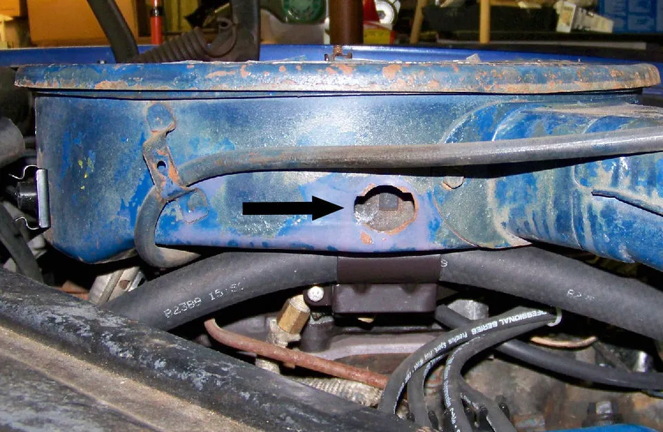

One other thing you may have is a fuel vapor purge connection on your air cleaner located here:
I’ve been trying to get a picture of the proper device that retains the fuel vapor purge hose. Do you have that?

Took a bunch of engine pics for ya platonic.just finished posting them. also checked for the tag on the radiator support and took a pic of it.My car dosent have a fold down rear seat.And,do you know what carb i have,and maybe the size?
OK, now I'm drooling on my keyboard. Thanks a ton for the pictures. You've saved me a lot of time. Your carb is the Motorcraft 4300-A 4V (605 CFM). You even have all the original hose clamps. Don't lose that fuel vapor purge hose as I've been trying to find one for 2 weeks now.
