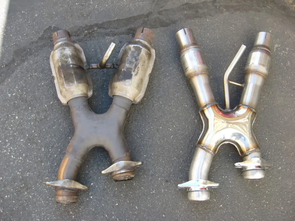

While I'm sure I could have used a couple of tricks to pass, I decided to make a more permanent change and just get two more cats. I bought a new Bassani catted x-pipe earlier this week, and since Bassani is based here in Southern California it arrived quickly. When I opened the box, I was quite surprised to see the new hi-flow cats on the x! All the photos on the web show the older style. The Bassani hi-flow cat has part number 25MSC. Here's a side-by-side photo of the two:
Should have taken a picture of the butcher job I did when I added the two other cats to the pipes, but ah well. Both x-pipes are exactly the same size, and the new x fit right on with no mods. Car does sound quieter than it used to, noticeably quieter. Haven't driven it enough to say if I've lost SOTP power.
