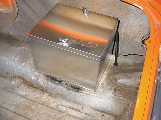

Anyone have pics on how you mounted your hold downs and boxes???

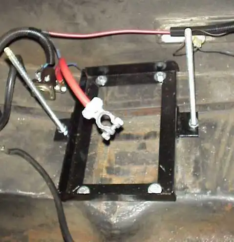

Im considering welding two threaded rods to the floor and welding a bracket to bolt down to hold on to the battery.
This way when i get a nice NHRA legal box i can just drill holes in it and add a set of wingnuts to the lid.
Something like this
But im not sure if thats a legal set up.
Thanks,
Adam
Personally, I wouldn't try welding a stud to the body unless you have a backing plate. If you can manage to do it without burning a big hole in the body, it will still be flimsy. I wouldn't trust it in an accident.
I was considering welding a plate to the floor as well, Basically taking some 16g cutting it to the desired size then welding the studs on. Basically mock it up outside the car then weld it in.
