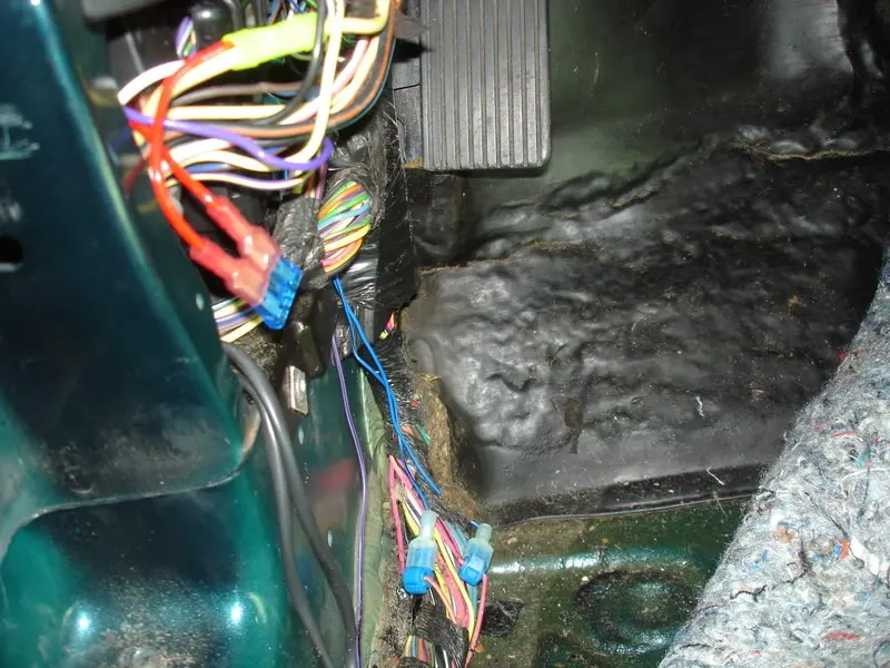

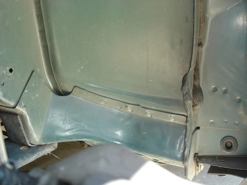

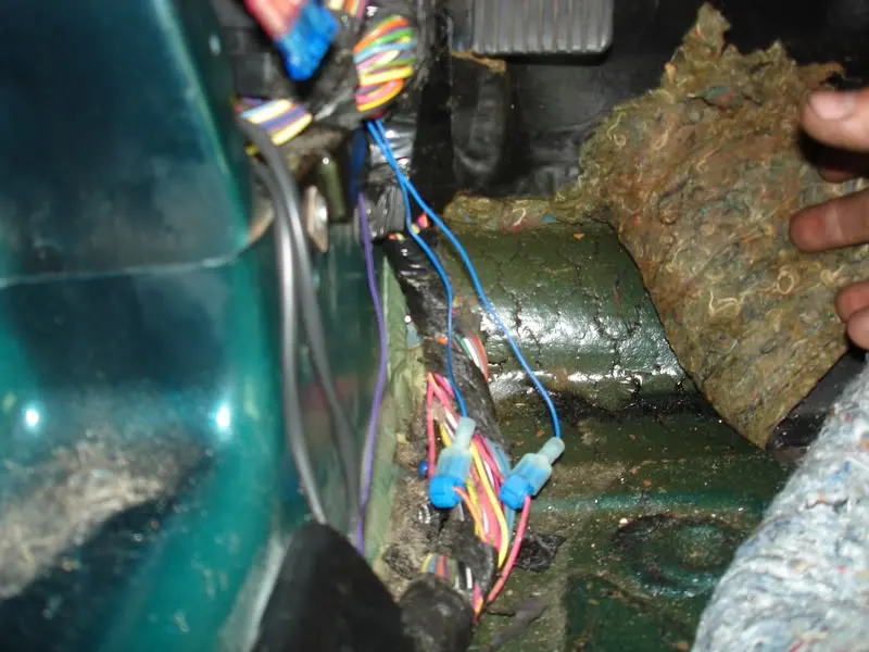

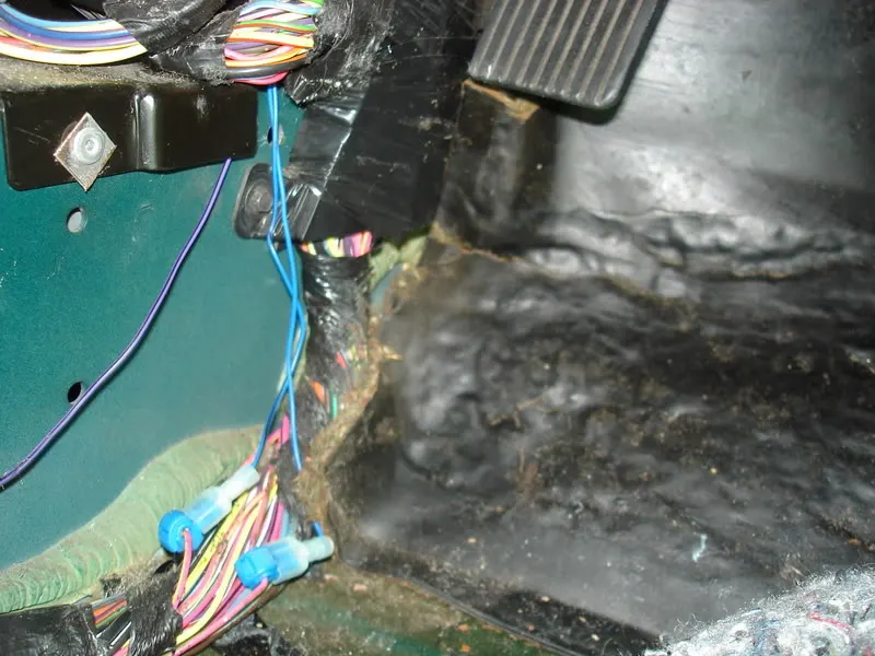

I have searched and came up with no pics but this:
bidg1withmyson said:
I ran the cable down the drivers side. Cut a hole in the back seat floor hump to pass it thru,Then under the door sil plate up and out the firewall thru the cruise control brake vacuum switch hose gromet (we removed the cruise) between the brake booster and the strut tower and around to the fuse box.
Does anyone have pics of the routing of the wires inside the car.
Did you have to cut into the firewall/floor board?
heres of pics of the area Im talking about.
I need to finish my battery relocation by tuesday.

I cut holes in the floorboard and ziptied the cables to the k-member and up to the approriate connection locations.
Redsnk95
Feb 3, 2002
2,243
Houston, TX
Jun 1, 2008
  • Jun 1, 2008
Yep, I clamped mine to the subframe connectors and other areas.
