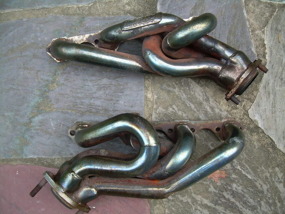

+1 ....I put my bbk unequal ceramics on last summer and i think the passenger side already blew a gasket. but def. go ceramic they keep the engine bay cooler. chrome will look awesome at first but will be bluish gold eventually.
My chrome ones turned blue with less than 20 minutes in the car, lol. But I went cheap intentionally. I had to have a nice set that would last me a year or two because I have better things in mind for later on. I had some problems with the stockers .... so I went with some BBK U/L chrome shorties.

good choice. these used to be chrome:
