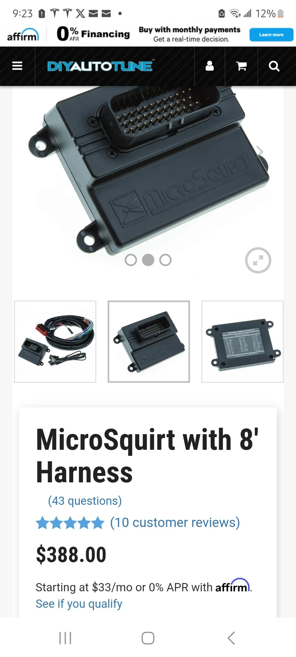

The emissions stuff doesn't need to go back on but you should get a tune. The mspnp2 is good ( I have one in my car ). It plugs right in and gives full control. Diyautotune is the place to go for that. Way more flexible than the factory computers. MS3 is even better but more for heavier modifications.
Ok, I bought a code reader for the last car so I'll that tomorrow after work. Is the mpnp2 the same as Microsquirt? I'll look at that now. I do have access to a tuner with a dyno. He offered to help me out before I bought this car.
