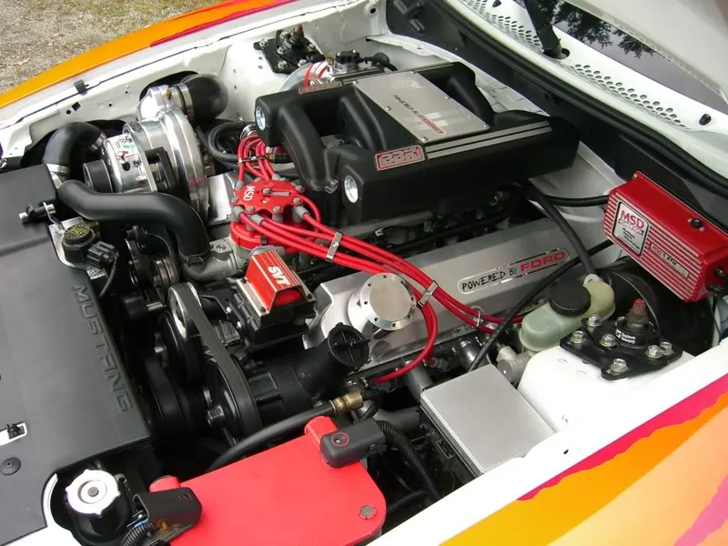

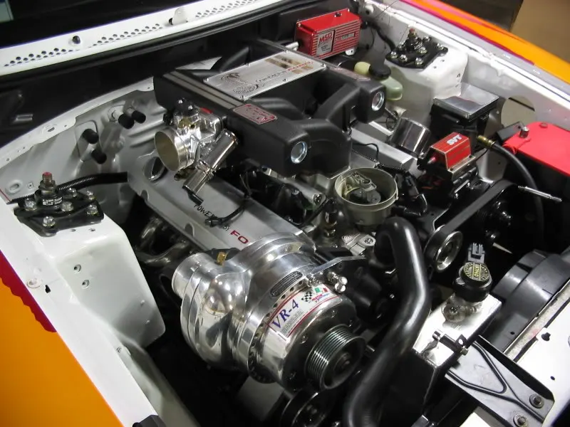

I had the bbk intake for awhile. Two problems I had were, 1 it wasn't big enough for my setup with the supercharger, where as it maybe fine for you setup. Second is it sucked alot of oil into the intake, even with an oil separator. However, I think this way a design flaw that I have read about their pcv setup design. I also think being supercharged made the problem worse for me.
So it may be a great intake for your setup, just not for mine. Which I knew it probably wouldn't be when I got it, but no one had the balls to try it out so I went ahead and tried it.
As far as looks, yeah they come to your door looking pretty good, but with a little time and effort, you can make them look even better. The looks and a different design was one of the main reasons I tried the intake. This is a pic of when I had mine, (which I sold for $450 in the spring) but I sanded down the fuel rails to look brushed instead of blue, custom top plate, painted black upper and painted cast lower. Then I gave all the raised lettering a brushed look. It looks good as it comes but with out a lot of time or money it can look way better.

WOW your engine bay is clean. I really like the paint job on the intake. In fact the whole reason i am looking into a new intake is because I new I would need one soon but my egr doesnt clear the valve cover I got. I was told they would work for a 94-95 and were made specifically to clear the egr and roller rockers. I was going to get a spacer but figured it was time to move to something that would allow it to breath more.
