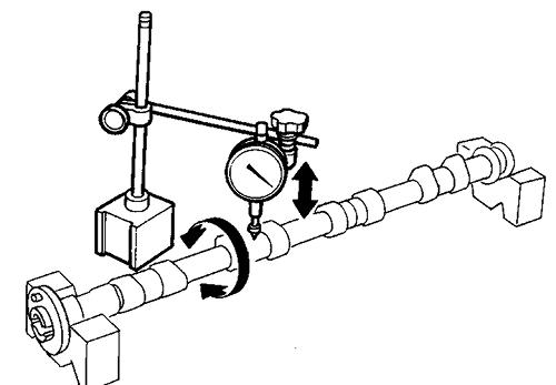

A machine shop can easily check the can to see if it is straight. See the picture below...
