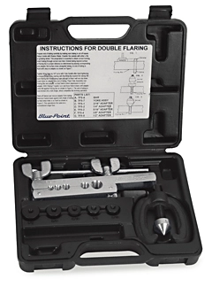

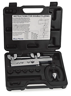

If you want the cooler and a gauge to monitor the transmission temps you are gonna have to cut both lines. You will want to make sure you have a cutting tool as well as a flaring tool. I happen to like SnapOn tools.
http://buy1.snapon.com/catalog/item...&group_ID=1338&store=snapon-store&dir=catalog
http://buy1.snapon.com/catalog/item...&group_ID=1339&store=snapon-store&dir=catalog
