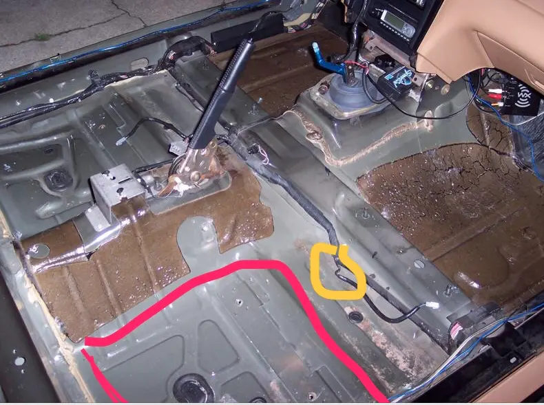

Anyways, we have a 1995 Convertible v6 that we are trying to get in daily-driver shape. We already pulled the front seats and the rear seats from the junkyard, have the carpet and the plastic trims ready to install but there is a big rusted through hole that we have only a slight idea on how to tackle.
The hole starts from the back area to the first bend in the floor pan with a smaller hole up ahead. Provided a picture (not my car obvs) of how it is roughly. The big red square is the hole that we need to cut out as it's rusting away, and the small yellow circle is the rust spot.
We have someone who can do the welding and can get some metal for it but i'm not sure how exactly that is gonna work with this small space. Any ideas?
The drivers side also has some patches where it has started to rust, can i just clean this out, sand them to get rid of the rust and be good?
Thanks
Edit: We were also planning on bolting the seats through drilled holes...would this not work?

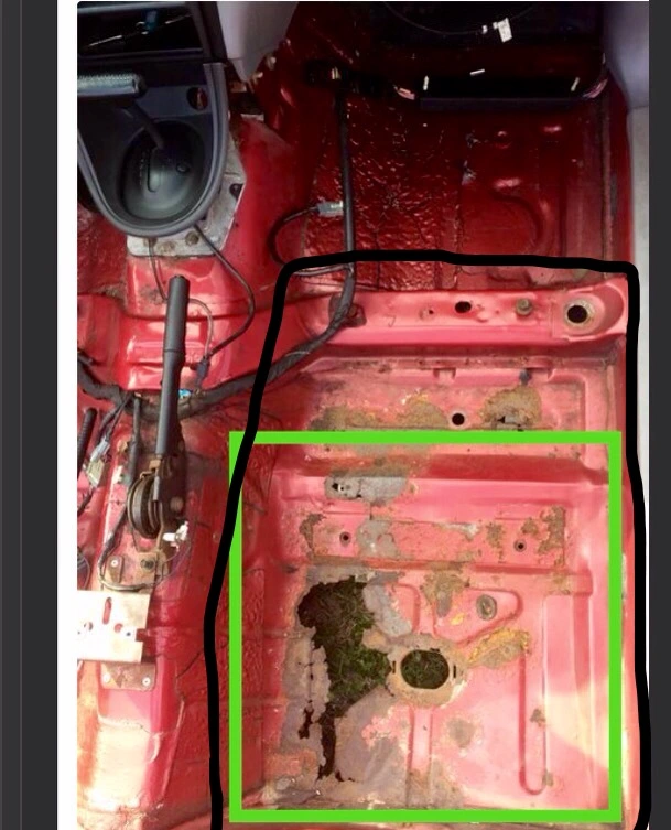

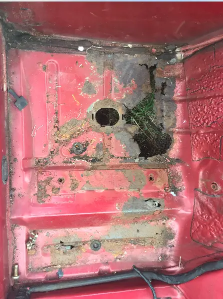

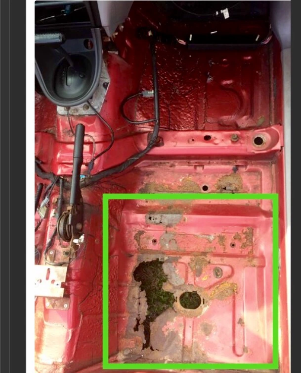

Here's the picture of the whole pan up towards the front. I also attached some of more rust in the back seat area. I'm thinking a patch up with sheet metal would be best here since it is not something that people stand one. Would that be best?
And the drivers side is showing some of what I hope is just surface rust. How would I fix this so it doesn't keep getting worse?
I'm going to get the floor pan from the junkyard since it will be cheapest. Already have the tools, but how much should I cut?
Anyways here are the pictures.
View: http://imgur.com/a/Qm3t5
I'd cut out as much as you can from the parts car,then cut your floor smaller than the new patch so you can flange it in.. Daves advice may differ-so what ever he suggests is what I would do lol
I don't know if you need to flange, maybe just overlap about .5-1" with the "new" panel.
If the yard cuts it out, just have them cut through the front seat brace and across the front of the brace. Have them cut into the rocker about an inch up on the side.
You'll want to be able to drill out the rocker to floor spot welds yourself. You'll do a much neater job.
Also on the back side were it rises into the rear seat area have them cut like the trans tunnel, up about three inches.
Again, that's so you can cut the spot welds were the floor attaches yourself.
If they want to cut a larger piece than that, take it. Don't take a smaller piece though. Trimming it to fit is easy enough, not having enough is a bad thing.
This is what i would get from the yard (the black line).
As for the rust spots that aren't rotted through. Go over them with a knotted wire wheel to clean the scale off first. Get a rust converter and put it on them and let it dry. Sand that off to see if you have more rust, if you do, repeat with the converter. I used POR 15 on my '86 floor pans to cover the bare metal after that. That works really well for sealing the area up.
Sand blasting is an option, but messy.
