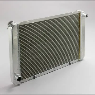

So is this the oneyou are getting? http://store.summitracing.com/default.asp?target=esearch.asp&N=110&Ntk=KeywordSearch&Ntt=griffin+
If so let me know how it works.
I am in the market for a new rad as well.
