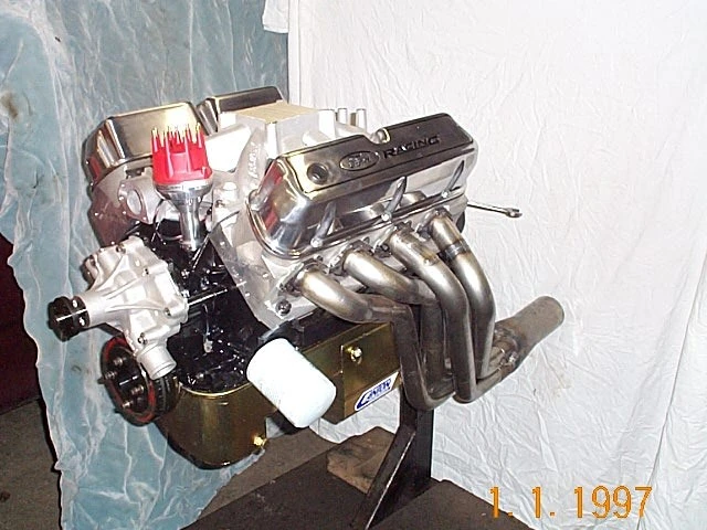

I have a 418 windsor in my car, I went with the TFS "R" heads on it. With hydro roller, unported heads/intake the motor made 581/539 flywheel #"s on pump gas. Cam is 252/262 @.05, 110 ls, .576/.576 lift, compression is 11.25:1, intake is a super victor with a 1000cfm demon carb. 1 7/8 kooks also. I paid under $1500 for the heads new and have no complaints. Also, with the 5spd on a shortshifted shakedown pass @3300 lbs the car went [email protected]. Just some food for thought.
Mike.
