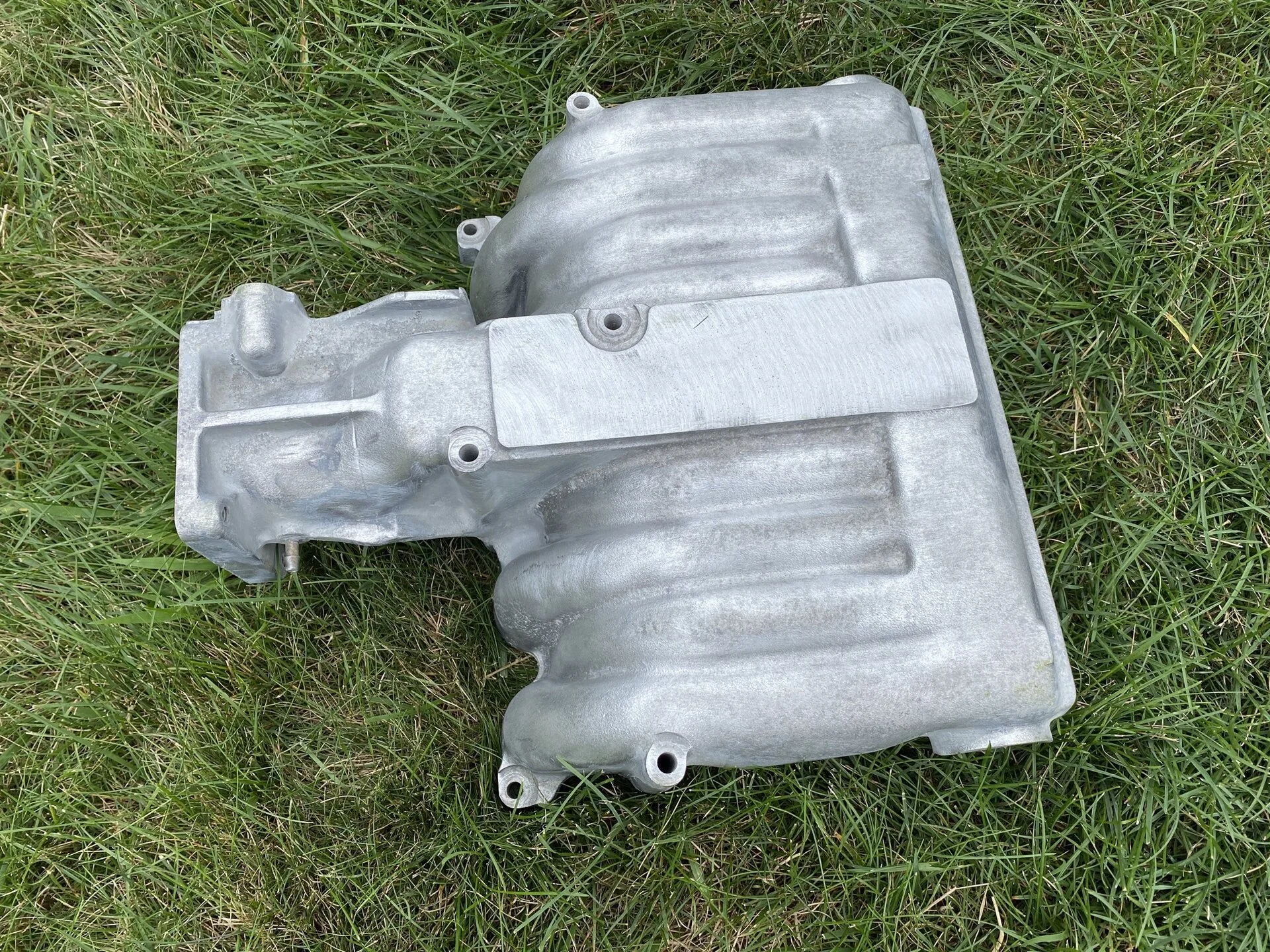

I prefer this stripper. It’s a bit safer than the aircraft stripper which is some nasty stuff. Downside is this works slower, upside was I was able to do it in my basement without fumes.
32-fl oz Regular Stripper Paste https://www.lowes.com/pd/CitriStrip-Stripping-Gel-1-QT/1000567963
But, I pretty much lathered up my intake, misted it with a sprayer and then wrapped it all in a black trash bag and checked on it a day or so later. Rinse and repeat if necessary.

I prefer this stripper. It’s a bit safer than the aircraft stripper which is some nasty stuff. Downside is this works slower.
Final result, before a quick sandblast.
Your regular stripper does good work. ;)
I’m sure the Citrus-strip is what some CA friends are using and report the same results with.
I don’t want to know how they can make degreaser or paint stripper from citrus fruit.

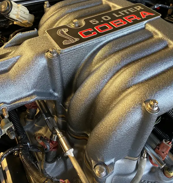

I noticed on my intake that the Cobra Emblem is made into the manifold itself. It is not a plate. I will just have to very carefully paint it up nice to look like what you have. Unless, yours is just simply placed over the emblem with some sort of adhesive?
You are right, it’s part of the intake. The 93 version has an aluminum decal.
If you are painting it, you can paint your base color first, and then touch up the pattern with black paint.
If you powdercoat it, a good coater can create a 2-tone effect with that pattern and make it look painted or polished
