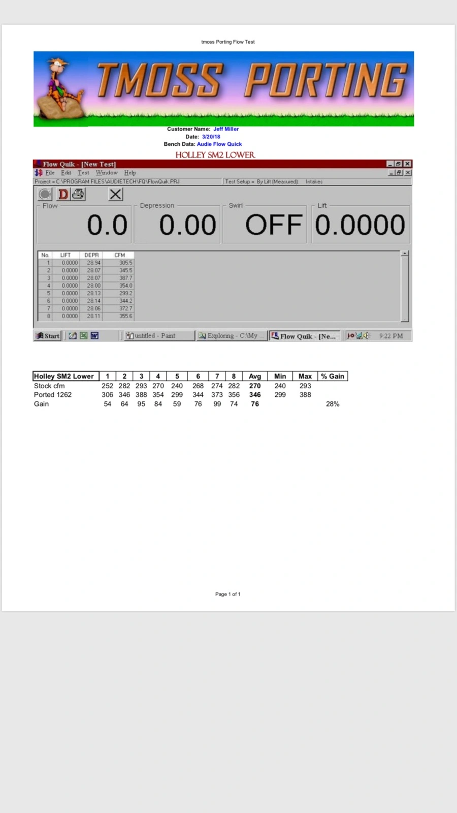

Well fellas based on what I am getting so far I am leaning heavily toward a tmoss ported lower cobra intake for my application. I really like keeping a car close to stock appearance and that cobra intake on top under the hood looks great to me. I have a dyno sheet on my current setup. I will try and find a way to contact Tmoss and when it is all done I will have another dyno done and we will see what we got. I appreciate all of your input!

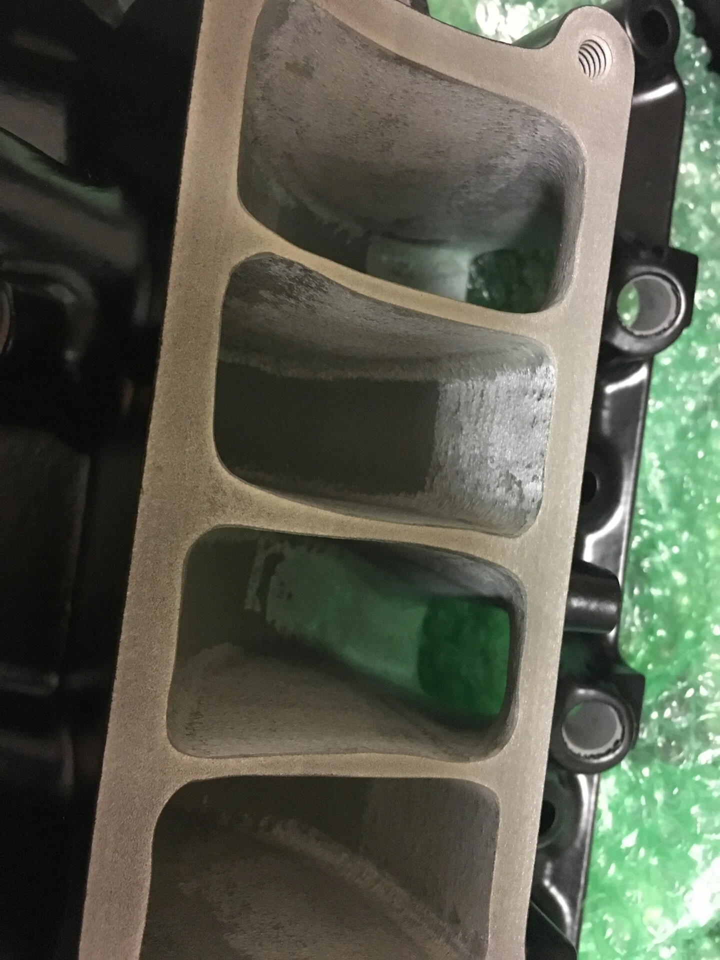

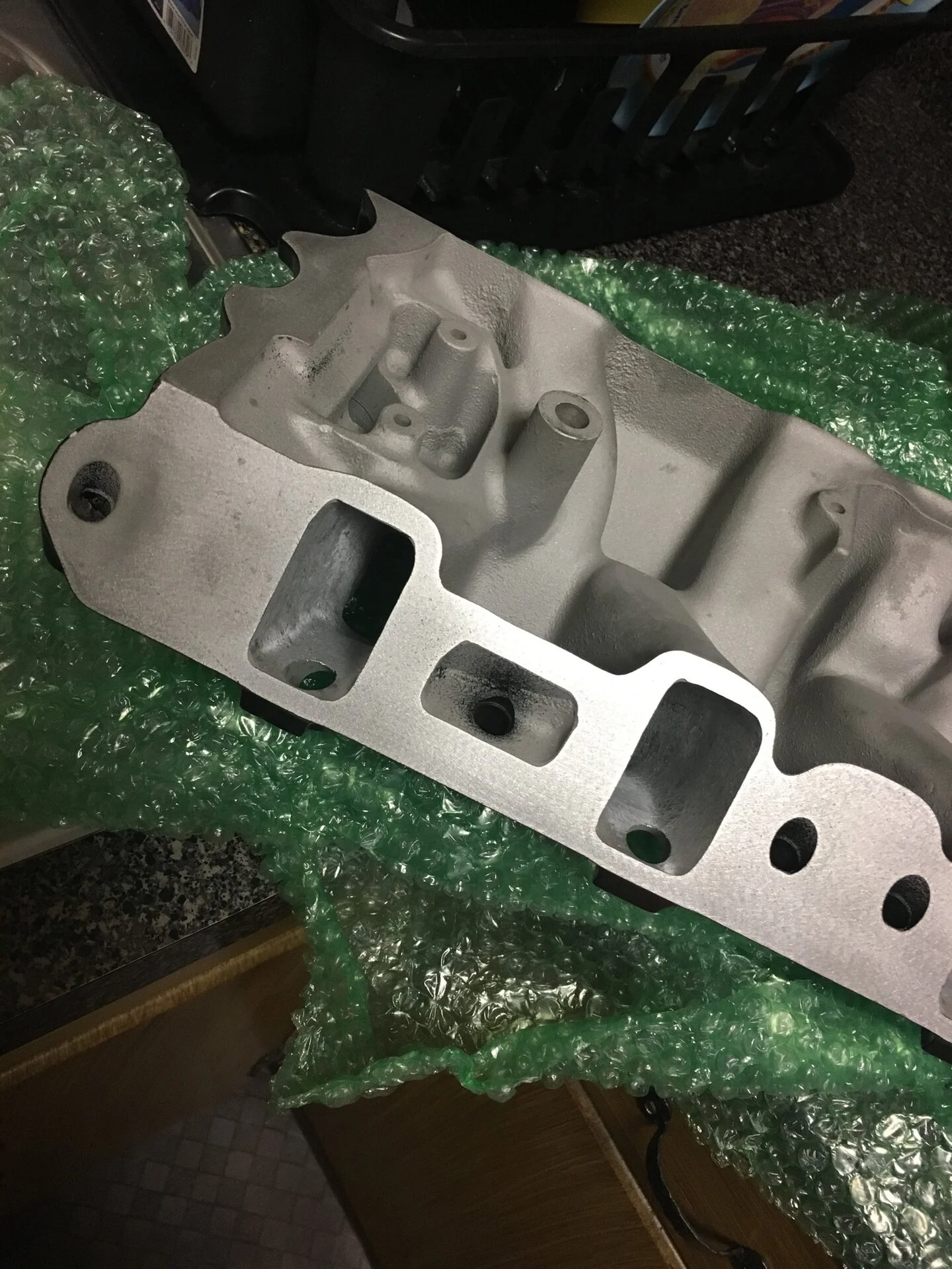

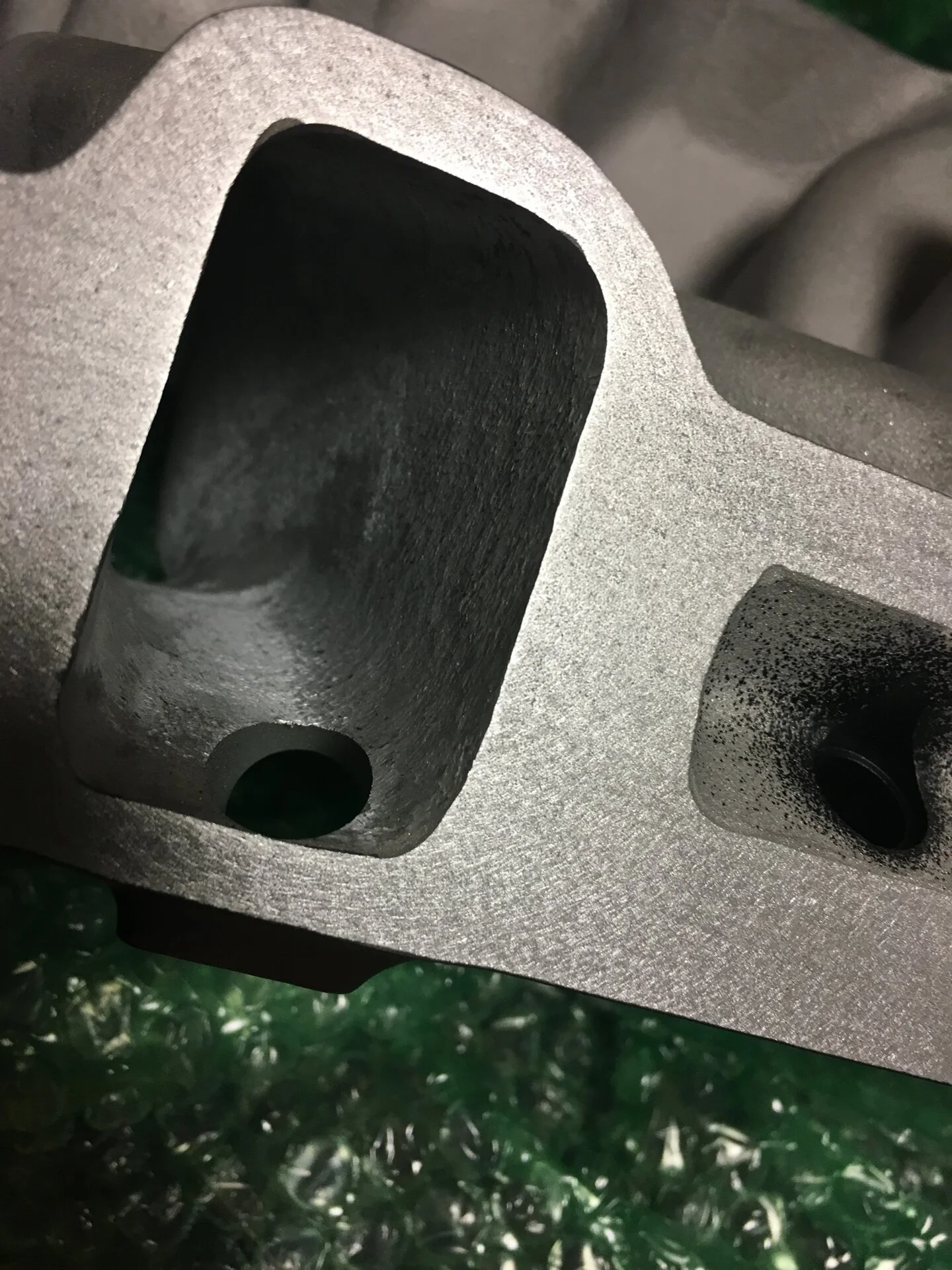

Pack the lower manifold with lots of solid foam and packing peanuts after putting it in a heavy, clear bag.

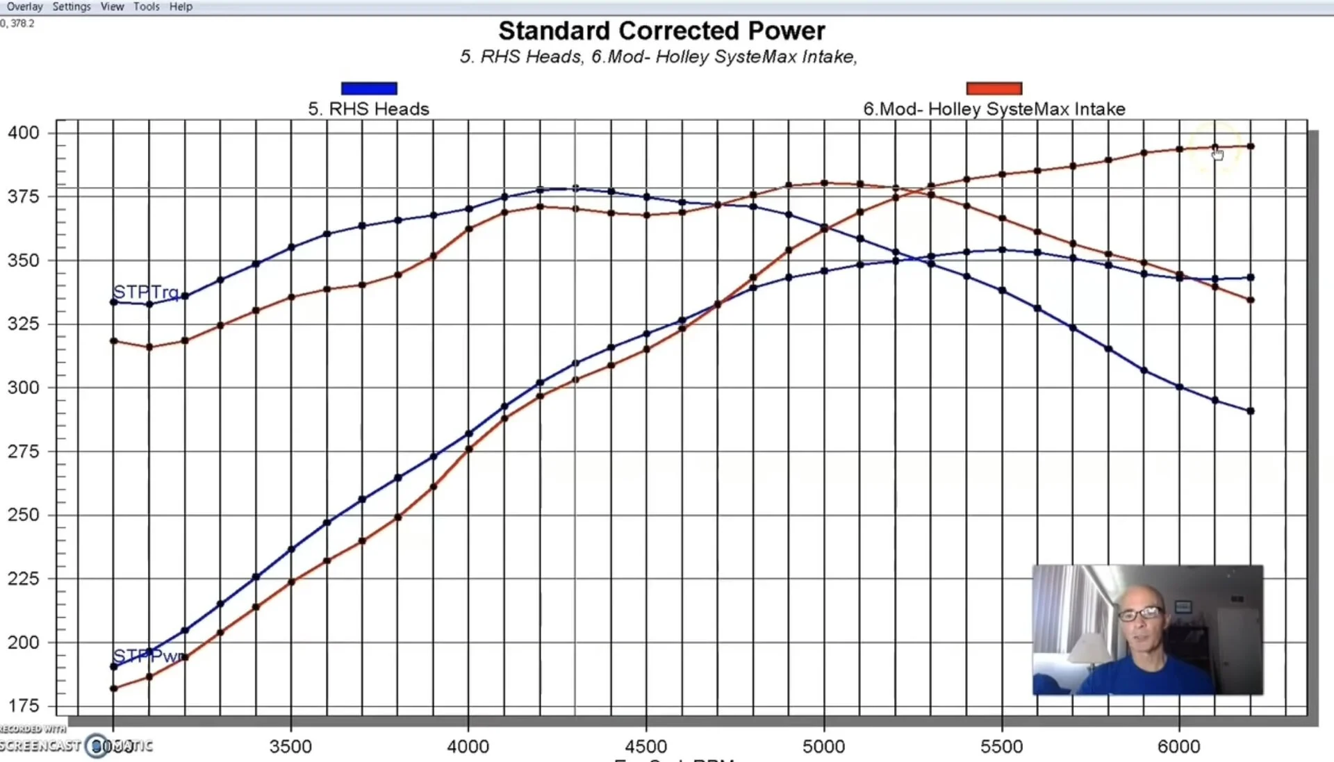

Just to add on to what I said earlier. I found the video I was talking about. I’ll spare you from watching all 30 mins.
Long story short. AL headed 302 with a GT40 intake vs system max. Just like I mentioned earlier. The long runner intakes make more power down low, but at 4750 they switch and the Holley takes off.
Gt40 in blue, Holley in red. Gt40 just runs out of steam around 5k rpm

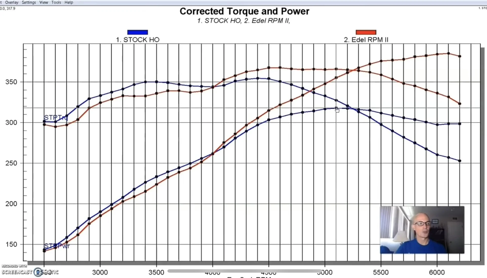

Just for giggles. AL headed 302 with stock HO intake and edelbrock intake. As you can see, the HO intake even outperforms (not by much) the RPM II at low rpm, although the crossover point is much lower at 4000 rpm
Nice graphs, Mike. I remember that being the consensus from the mags back in the day, too. Me personally? I'd leave the Cobra Intake on it. I like the look... and after all, it is a Cobra.
I prefer the looks of the Cobra as well. Given that for my needs I know i'd be doing a lot of 2000-4000RPM pulls on the mean streets, I opted to stick with the cobra intake on my TFS170/Custom cam combo, although I did port the cobra (TMOSS did the porting).
I'd imagine if i swapped to a Trick Flow intake i would see a difference in power like the top graph, with the trick flow taking off somewhere around 4500-5000RPM and giving more peak power. That's a 25HP difference in that graph but all of that power would be at an RPM that I would rarely use on the street. I'm sure an extra 25HP at 5500 RPM would be fun as hell though
Of course, you can always compensate for the reduced lower end power of an aftermarket intake with 4.10's until you get that engine wound up.

Did the article/video run the Edelbrock RPM intake? Any other product with this name is a safe choice for a wide and useable power band. Engine Masters on MT ran the episode that tested carbed, dual plane intakes with an AL headed 351 again this morning.
I would like to also see what the ported lower GT-40 family intakes would have done in the same test.

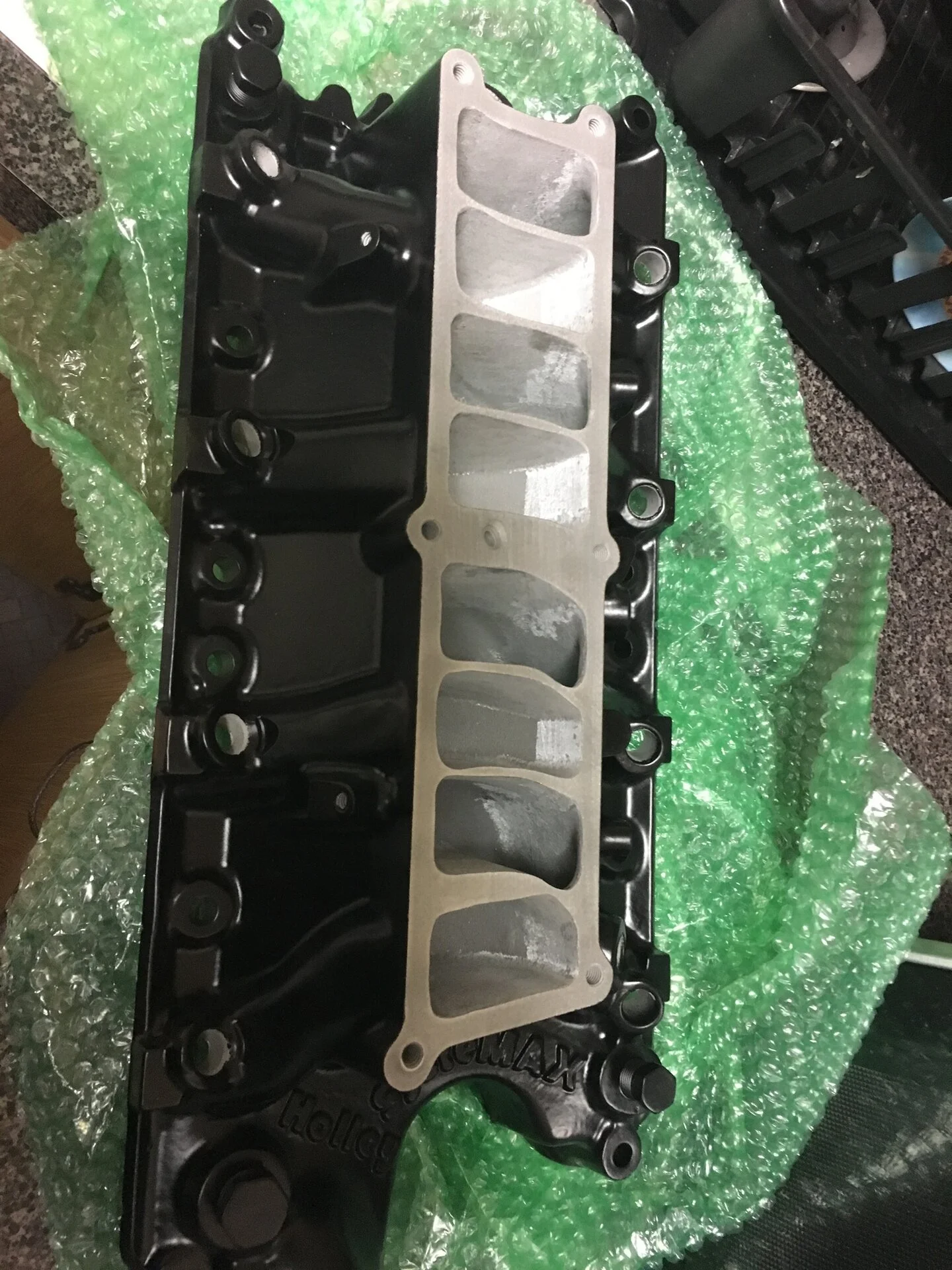

I have Seen a lot of banter between big dogs and t moss . I wonder what the reality is. Miss’s have done it forever . He did my systemax for me .
I have seen big dogs claim they outflow anything that moss has . I’d like to see an unbiased party test it

I know. I followed a lot of that banter from the sidelines and have kept out of it. It's spilled over to FB and YouTube as well. I would truely love to see a dyno test between a Bigdog ported Cobra and a tmoss Cobra on the same engine just to compare the dyno curves.
I think one guy offered to do it on Corral a month or so ago, but don't know if that ever became a reality.
Yes, on modified motor.
Right around 6:00 give or take

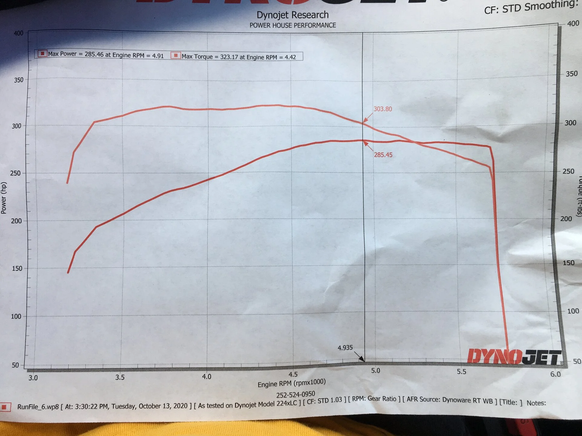

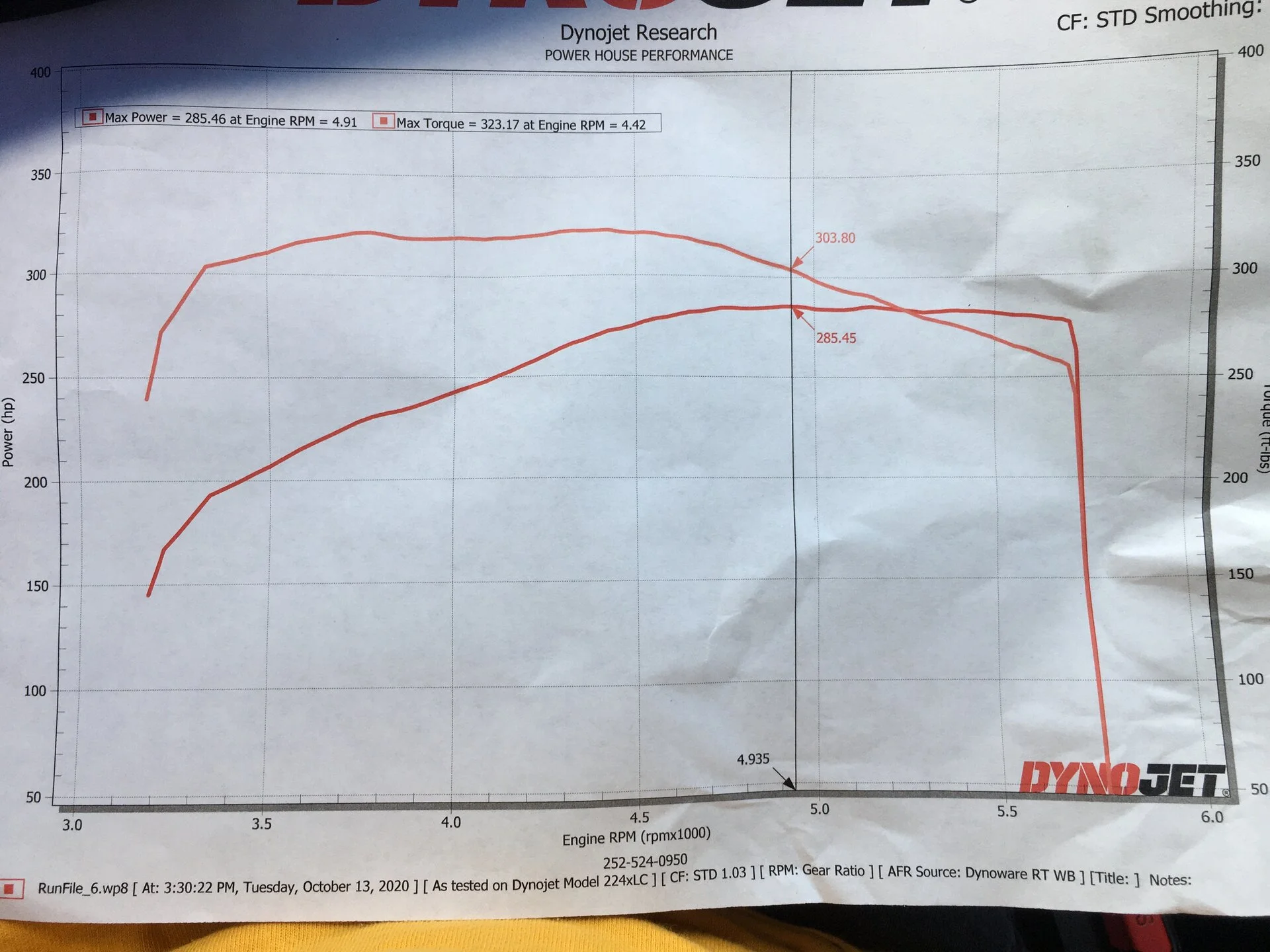

I have never heard of Bigdog. How do I contact them? If I get them to do mine it could likely be available in the future to test against one of the many Tmoss ported GT40 intakes. That would be some good data! I feel like either party that has made a name for themselves on these mustang platforms probably knows what they are doing though and I wouldn't expect one to dramatically outperform the other. Here is a Dyno sheet with my current setup.
