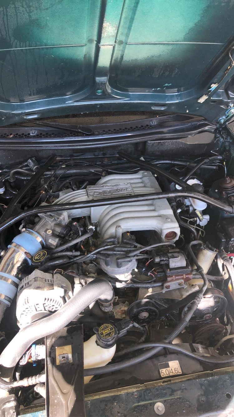

it doesn’t it is very tired and sluggish so i’m thinking throw new heads on it and put piston rings on it
Go back to you build thread Keegan Martin, and put some pictures on what you have done. Glad you still have your car.
just did

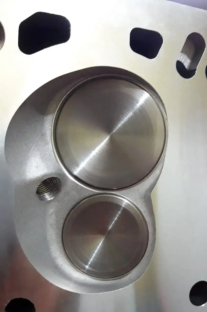

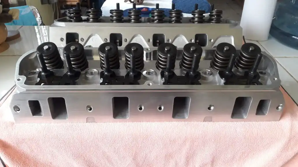

so finally I have installed the Promaxx on my 331 and Thursday was the 1. start ..Terminator X is doing right the Job ..after 20 -30 seconds engine was running nice and some minutes and warming up ..even better ... used Headbolts from speedmaster, Felpro Gaskets, ARP 7/16 Rocker studs and the Compcam Magnum Roller rockers.. needed some longer Pushrods..also from CompCams ..from 6.250 to 6.300 to correct the Rocker Geometry ...havent been on the street to test.. too much rain here ... but as soon as possible I ll go for a ride ... wondering if bigger Valves make a difference ... was running Ported Floteks 180cc/58cc with the smaller valves 1.94/1.55 and PM has 2.02/1.60 also 180cc runner but 60cc chamber ..so engie has a little less compression....out of the Box the Promaxx have way better Flow then the Floteks .. but I ported mine In and Exhaust side ..so I think Flow is pretty similar ??! so its just the bigger Valves but less compression ...I ll see what happens ..I have tons of 1/4 mile times with the Floteks ...
