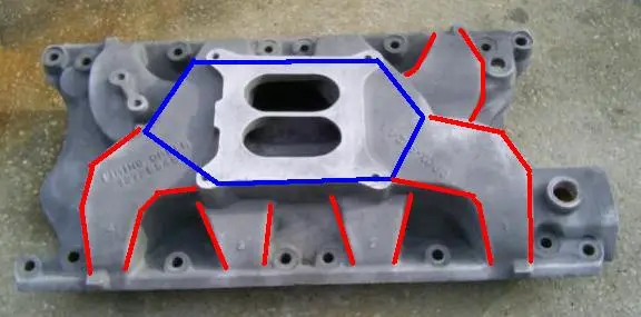

The neat thing about the 69-70 GT 350 intake, I believe that is the C9OX you refer to, is that it is more radical than it appears.
At first glance it looks like a Performer or stock iron intake, but with some study you find a very large plenum and large/short runners.
For a dual plane intake, it should rock pretty good!
The runners come in from the plenum like big funnels.
They don't get down to port size until right at the ends.
I have owned them, but never run one. :(
I have always wanted to try one out.
I bet they work awesome.
Here is an example:
The blue shows how the plenum doesn't just sit under the carb and split into runners like a regular intake. The plenum extends far past and under the carb pad.
The red shows how the plenum gradually funnels down and eventually becomes what we would consider port runners.
Edit:
Just for giggles, I did the same to a 'regular' 4v intake.
The plenum is central and small.
The runners are straight off the plenum with a single size.
I don't know how true it is, but I have read that ports that funnel, rather than just shoot off the plenum, have an advantage.
A sort of pulse supercharging type thing.
I know the principle, but trying to explain physics is not my strong point.;)
