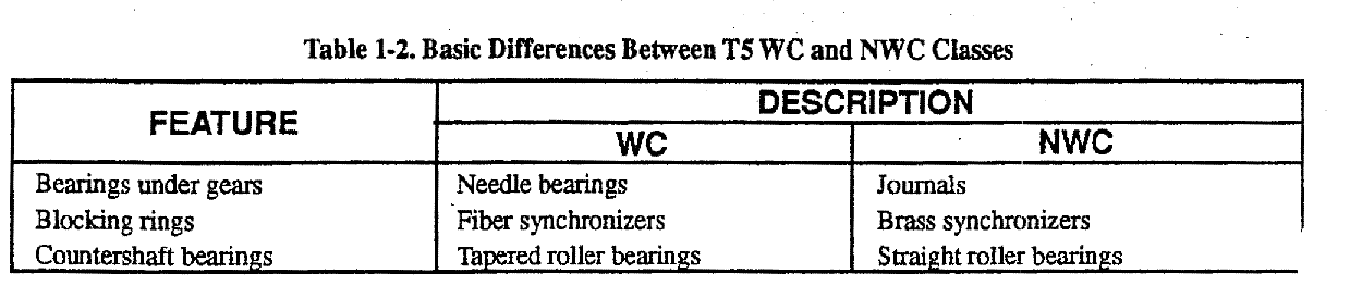

World class is only a marketing gimmick. The main differences were in the syncos, roller bearings in the input shaft and some other small changes. The best factory T5 is rated 330 FT/lbs of torque, and that is a constant load, no shock load like dumping the clutch or speed shifting. Drive it hard and it will break.
basic-differences-between-t5-wc-and-nwc-transmissions-gif.70356
T5, all versions used in 5.0 Mustangs
