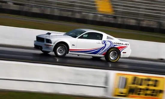

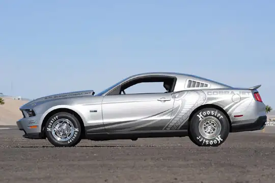

It probably depends on what race series they're running (nostalgia, classic, factory, etc.) and the rules, many regs. limit them to the largest wheel available at time of production which was 15". Also if they're doing 1/4mi. 15" is better than 17", just look at the new CobraJet = 15" rear tires!
