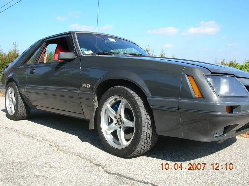

When I got my car painted, I told them "Do not touch the bumpers, I'll do them". I did that for a few reasons. The big one is to make it easy for my to fix any scratches the the Mass-hole drivers put on my car. BTW: I never park my Stang near other cars. So far, I have only two very small scratches, both my fault. :-P

Here you can see how my bumpers turned out: (I think they turned out very nicely :))
Mustang 86 - Mach1 Springs
BTW: The "white" you see from the bumpers in some pictures is the reflection of the sun. In some pictures, you can see that the paint is uniform.
FYI:
Below, you can see a close up of the front bumper, and one of the two small scratches (near the top corner of the turn signal).
And, yes, that SUPER MEGA AWESOME hood fitment is 100% from the factory, neither the hood nor fender where ever removed (when that picture was taken).
