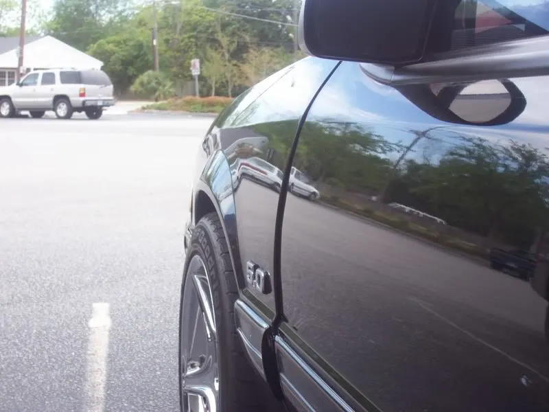

iv always used the front sub frames in the front and the rear end for the back? is there a better way to jack up the front/ sides of the car? just got to thinken bout it cause i noticed my fenders bowing alittle bit

It is usually because someone jacked the car up under the front fender where it bolts to the car right behind the front tire(s). The solution is unbolt the bottom of the fender, use vise grips along with a hammer and straighten out both the body where the fender bolts on, and the bottom of the fender where the bolt goes through. Bolt it back on and it should be fine.

One the notch I used to have the pinch weld was pushed up so far from a previous owner, that I had to straighten the pinch weld out the best I could and then wallow out the hole that the bolt goes through to give me more room. Like thief said, once the pinch weld is straighted it should line up. Or you might have to have a buddy push in on the back of the fender while you tighten it down.
