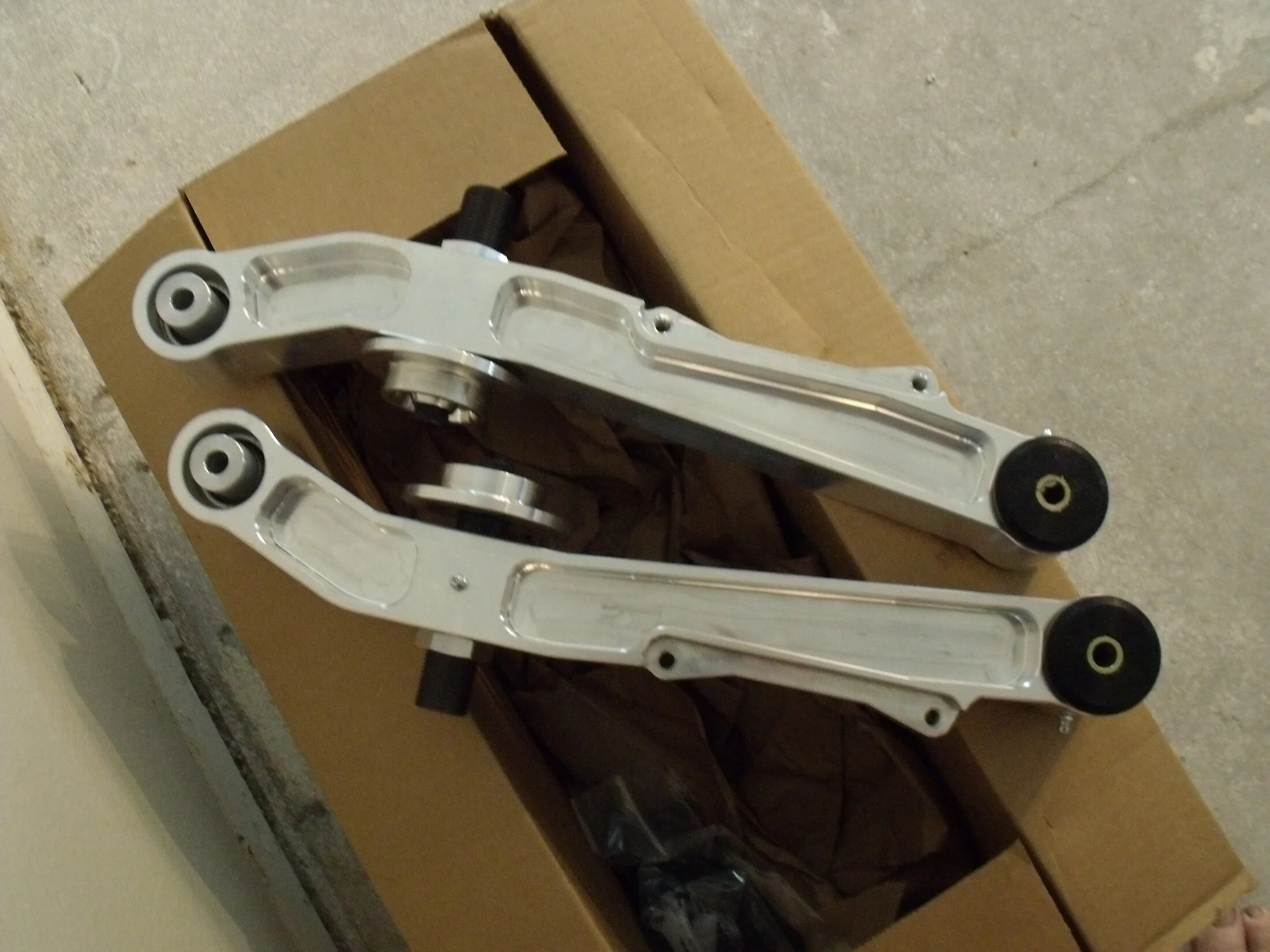

I have BMR Adjustable Lower and uppers on my drag car.
Maximum Motorsports are IMO the absolute best and for what you get the best bang for the buck.

I ran my stock style suspension with these for years before moving to a full MM suspension and the car was a blast to drive and very predictable.
While the lowers are good, no real need to replace the upper with new ones, chassis side bushings are $26 a pair at rock auto for a decent brand, moog sells the chassis and axle side for around $45 for two kits needed, you can also box the stock ones while there out if you want to and Ford still sells the c clip, axles side bushings and a bottle of friction modified for $40. https://www.summitracing.com/parts/fms-m-4050-b Same stuff just saving a few bucks, not much more work then doing just the axle side bushings. Stock arms do help keep the upper torque boxes alive if there not welded up, poly on the chassis side that isn't a ball bushing is worse then solids in my experience and only few like MM use those types of bushings.

would adjustable ones be necessary? whats the advantage to getting adjustable lowers, i know uppers are to set pinion angle, but whats the point in adjustable lowers?

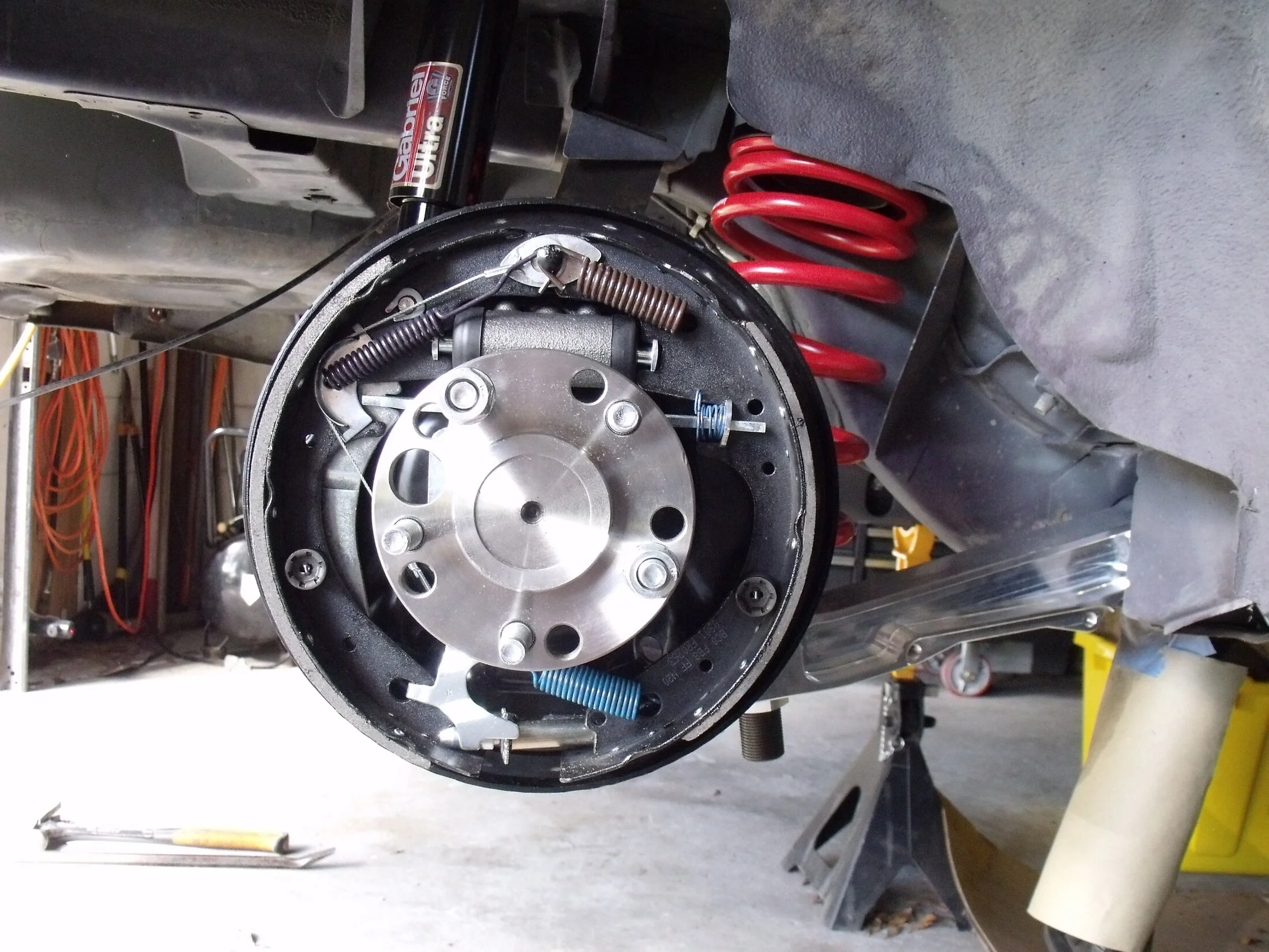

The 'weight jackers' allow you to set your ride height. Useful if you're running wheel/tire setups that differ in size from stock or you just want to sit higher/lower than it would otherwise.
It's a 'nice to have'.
From the Steeda website:
The adjustable spring seat allows you to raise or lower the rear of your Mustang up to 1" with just the turn of a standard 1/2" ratchet. Plus, Steeda went the extra mile by using a roller bearing assembly on the spring seat to make adjustment even easier. Steeda's 3-pc. bushing design positively locates the axle for maximum traction and control without torque-box damaging suspension bind. Patent pending.

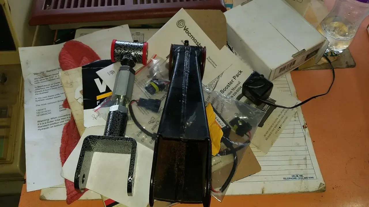

Boxing the uppers are not recommended for a stock suspension car. If you want better uppers then go to spherical end uppers. I’m not saying don’t box them it I’m just saying it’s not the best.
I have Griggs Racing lowers in my T-Bird and Global West double adjustable uppers of which both have spherical ends. Hard bite and handles really well.

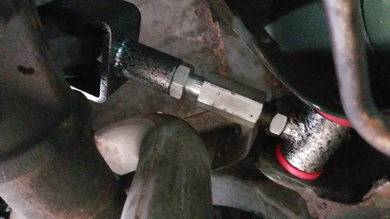

That team z set of uppers looks like a weaker copy of the steeda version, which at least has half the top boxed for strength. I never liked the open top version.
I ran a version of them with heims only on the body side and that would be a firm hell no a second time.
Before I had the torque arm I ran motorsport uppers as my last set, I would do that again.
