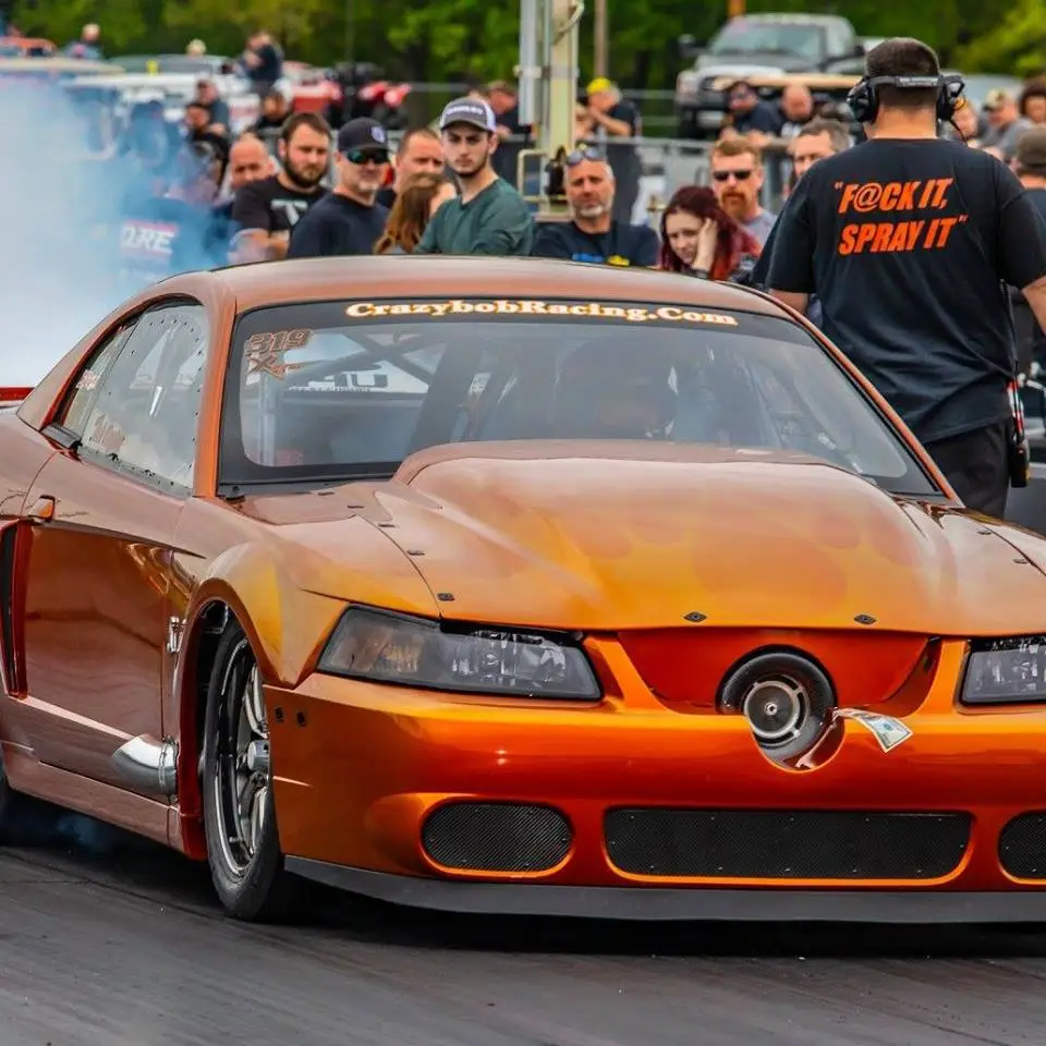

again... you can go that low it all depends how much you are willing to spend to fix the geometry. the front of the torque arm is in a fixed location height wise, this gives you the anti squat and instant center. start going too low there the AS and IC get into a location thats not going be favorable for anything end result is moving the torque arm back up in the front.
stock suspension is going to be the same thing. you will need to change the mounting locations to get that low.
then on to the front
to get a 24" fender opening height
we had to have the tops of the strut tower cut off and made new to get the caster and camber right. we also had to use drop spindles to get the bump steer not all screwed up.
so again you can go as low as you want it just depends how much you are willing to spend to get that low. i will say working on a car that low is a PITA!!!!

THATS 24" TO THE WHEEL WELL
THE MACH 1 SPLITTER IS 3.125" AT RIDE HEIGHT

I love the money stuck to the front bumper. Is that a dollar bill or a hunnert dollar bill?
srtthis
Jul 3, 2009
5,129
1,666
204
Maryland
May 16, 2018
#24
  • May 16, 2018
  • #24
a real 100 layed in the clear. the guy who Bob bought the car from who had it painted had that done. its not our style but the place that did it wants a grand to take it out.
