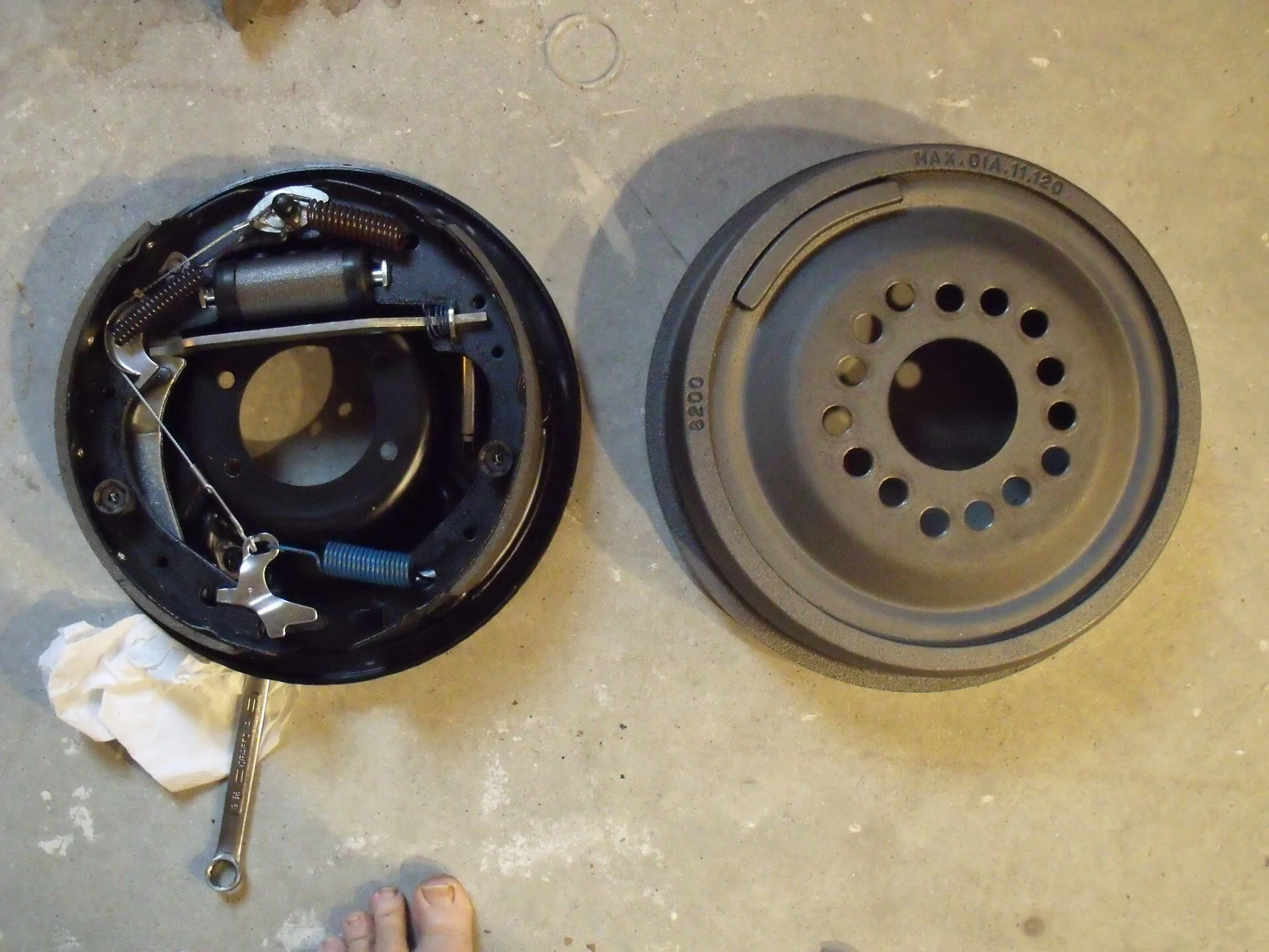

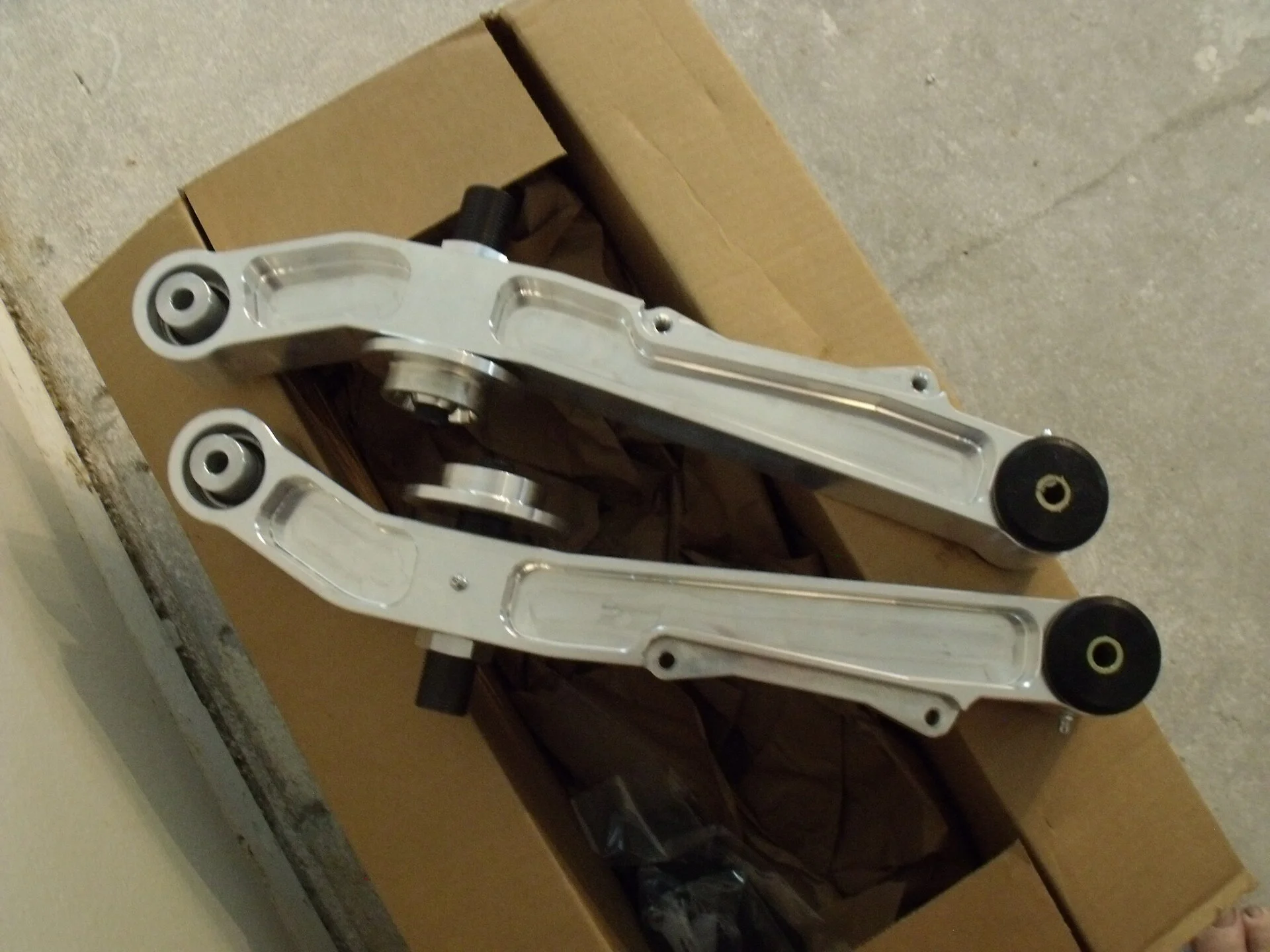

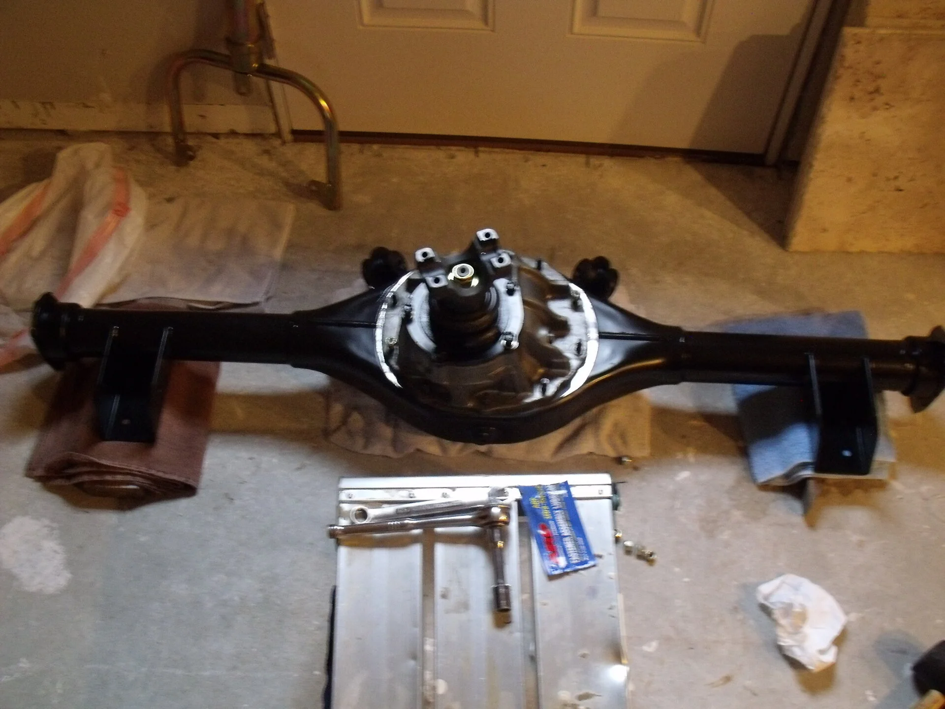

Taking out the 7.5" and installing whats in the pic.. New lower control arms, will reuse uppers if they look good
Do I need to take out the emergency brake at the lever? Why cant I disconnect it at the drum? I know this is way overkill for my grocery getter.... Thanks for the help

You can take them off at the drums. It's easier for me to remove them at the e brake handle cable bracket.

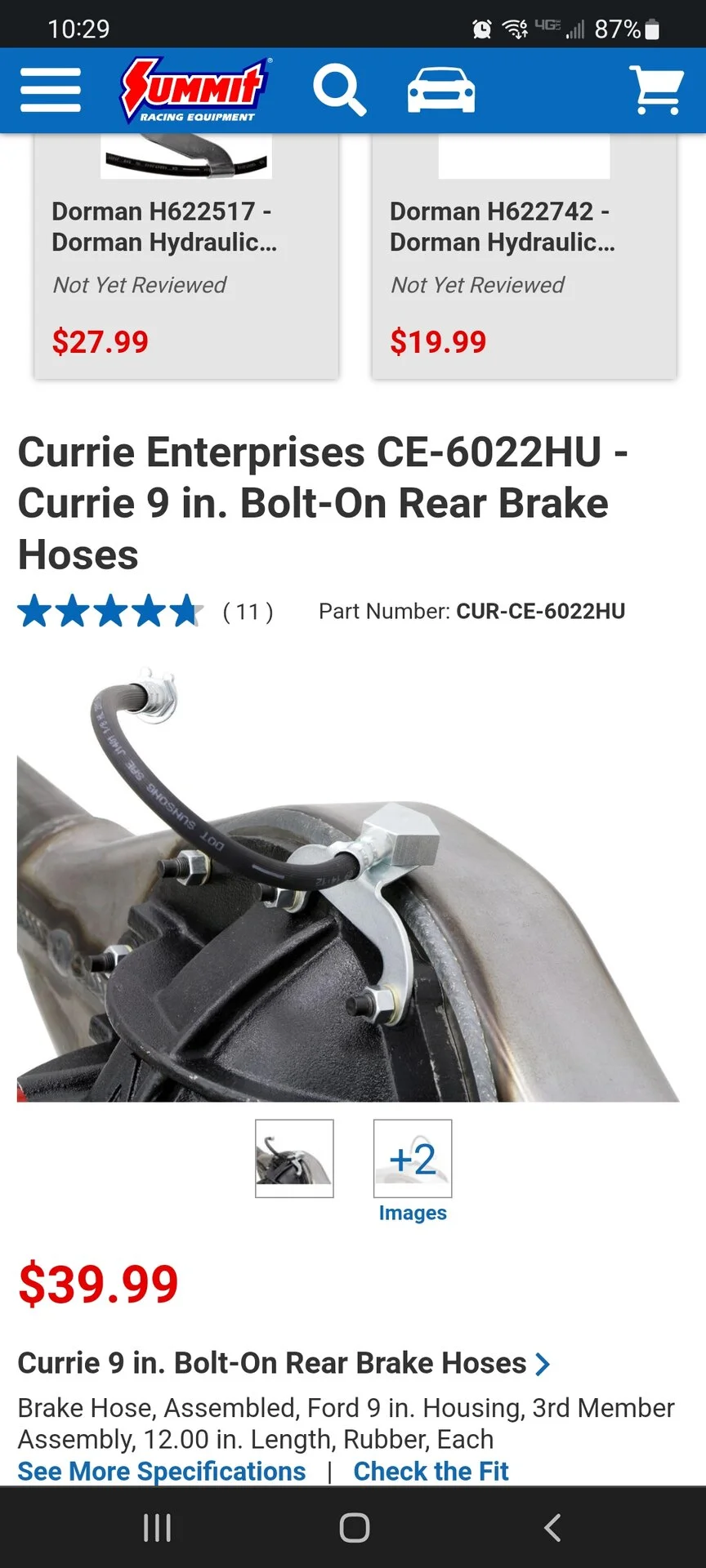

It's not a hard job once you start taking stuff loose. You may want to make some metal lines for the rear . The " T " fitting is bolted to the factory rear with a bracket. That bracket will not bolt on the 9 inch without making a bracket to bolt it to. It's been a very long time since I've put a 9 inch in a mustang. You will need one of these. It will be mounted on the studs on the drivers side with the rubber hose pointing towards the front. You might need an adapter to go from the hose thread to the hard line thread

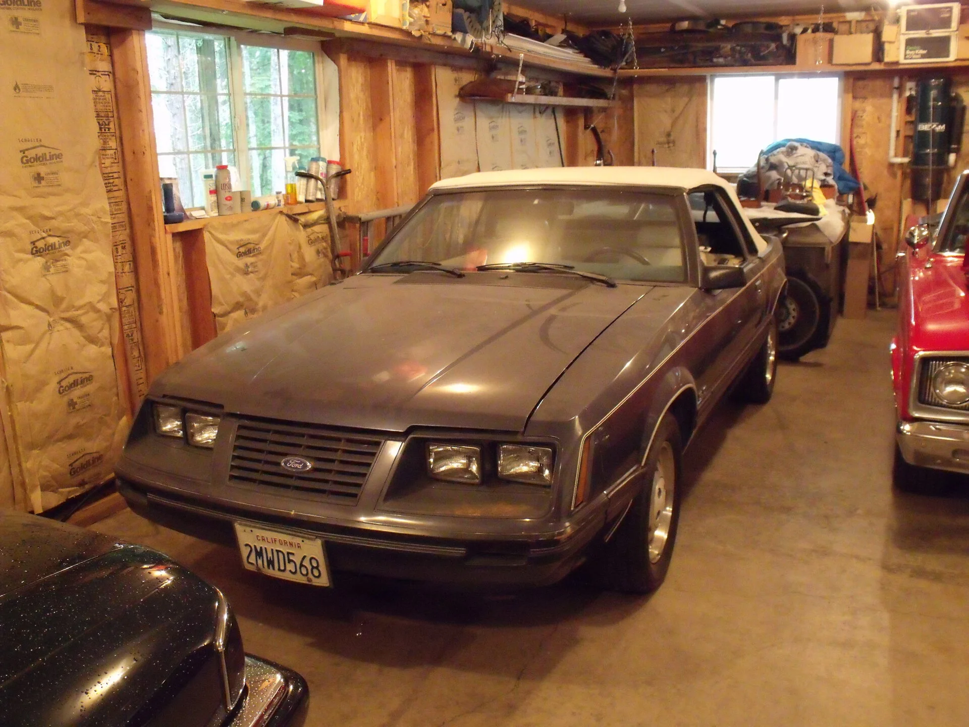

If your asking me I have not removed it yet.... Keeping the car a roller while working on sub assembly's until I get some garage space to finish it.... Sold my Dodge after owning it for over 31 years ( car movers are coming today) so I hope to get on this next week..
NOT my commiefornia plates... My sister is the Biden voting indoctrinated educated LOON...
Yes, I have this part on my list.
Read where some have run the brake lines from this bracket to the drums with no other " brackets" to hold the line?

The 83 I am working on has a 7.5.. Instead of buying a 8.8 to replace it, I thought I would go the 9" route as I have experience with them....
