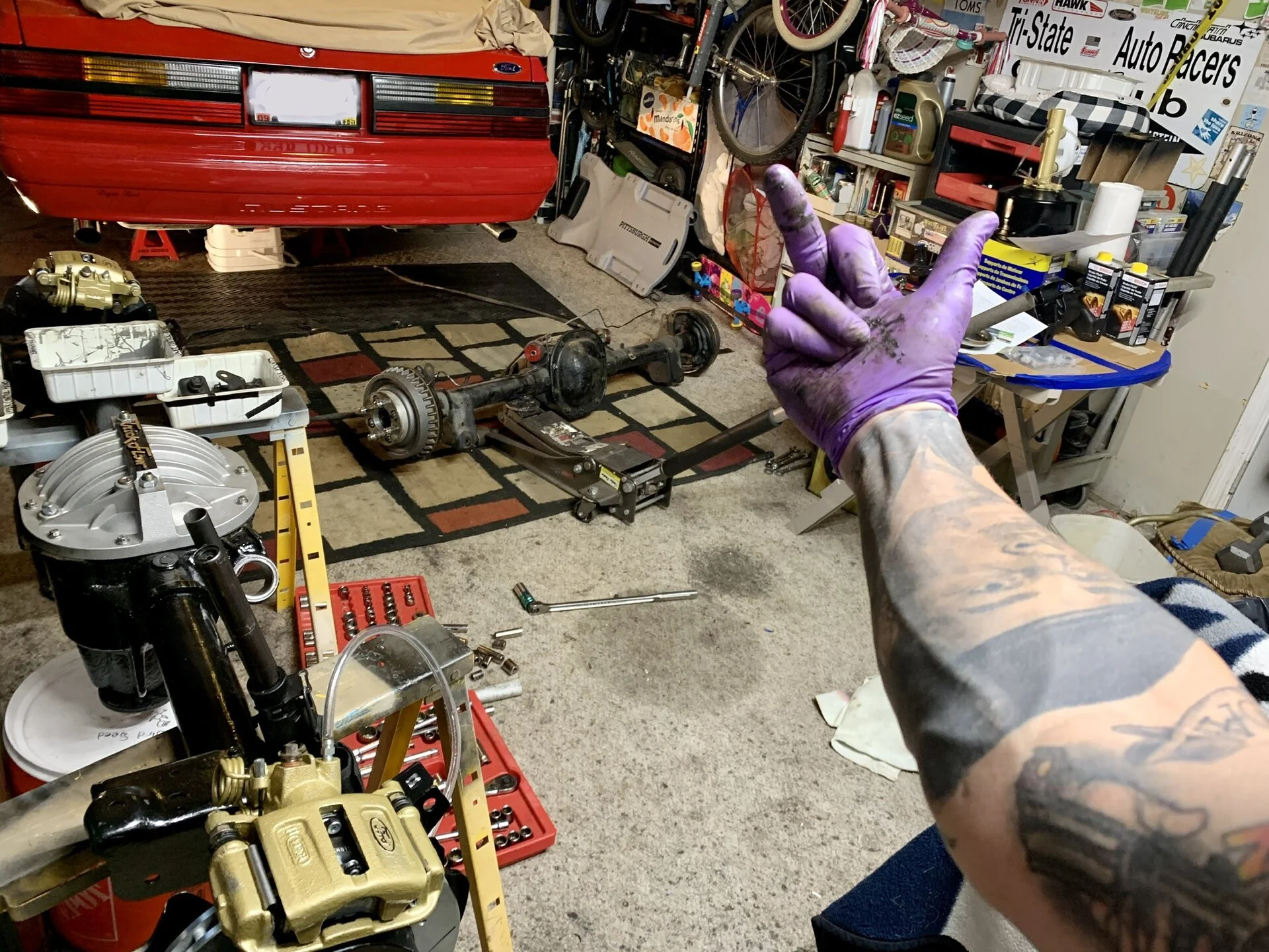

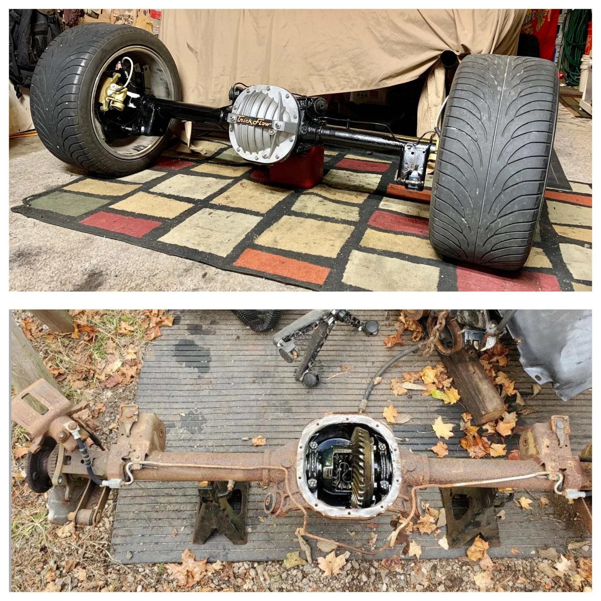

I swapped a T-Bird Super coupe rear on my car awhile back. I did it by myself with beer power, took a weekend. Uppers first, then keep the axle on the Jack. Manipulate the Jack height to get the lowers in place.
