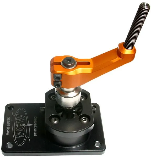

:shrug: The MGW doesn't come with the shift stops adjusted already. You have to do it yourself by the instructions provided. I know tranny shops will do it with a feeler gauge or something, but I just followed MGWs directions for adjusting them. If i remember correctly, MGW tells you to back all of the stops out all of the way so they make no contact with the shifter handle. Then put the handle in first gear and carefully adjust the stop so it contacts the handle. Once it makes contact with the handle, back it off until you can just slide a piece of paper between the stop and the handle in gear. Repeat four more times.

The stops aren't there to make your shifts shorter. They're there to protect your shift fork/transmission when slamming through the gears....so you don't "overshift"...Having the stops out too far is just as bad as not having them at all...:nice:
if you have adjustable stops then use them....I "doubt" there is a perfect preset for all cars, therefore, I "doubt" that anybody should just assume that their aftermarket shifter is adjusted correctly without checking.
Mustang 5l5 - Please explain your statement about only having the synchros halfway engaged. So long as you adjust the stops correctly this wouldn't happen...
1991notchbacklx- you mention repeating the process all 5 times....does your mgw shifter have a stop for every single gear? My pro5.0 only has two stops, one for up shifting and one for down. I base my adjustment on 1st or third for forward and 2nd and 4th for back. Reason for this is because who slams 5th gear or reverse anyway.
That's the correct way to do it. :nice:
What i got from that post was to set the stops closer in so the handle actually contacts the stops when you shift....in turn shortening the throws. This is bad and can damage the trans. When the handle contacts a stop, the shift fork is prevented from traveling it's full distance and the synchro slider may not be completely engaged with the gear. If they are not fully engaged, you can pop out of gear, bend shift forks, or cause other damage.

Yeah you've got it right the way yours is adjusted, Drew. I check all 5 gears for proper contact with the stop as a safety precaution, to avoid any potential damage and to prevent popping out of gear, etc. My MGW only has two stops, as seen here:
