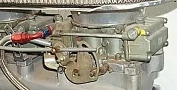

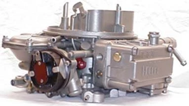

Is this sort of what your carb looks like? The fitting on the far right is called a banjo fitting and I think I may have a spare. If you have this type of bowl on it it's called a side hung bowl (as evidenced if you remove it and look inside it) and it has an aluminum tube that connects it to the other bowl. Center hung bowls tyipically look like your double pumper carbs in that the fuel line comes in from the side up at an angle.
If you can take a pic or find one on the 'net to let us know what you need/are talking about, it would help.
