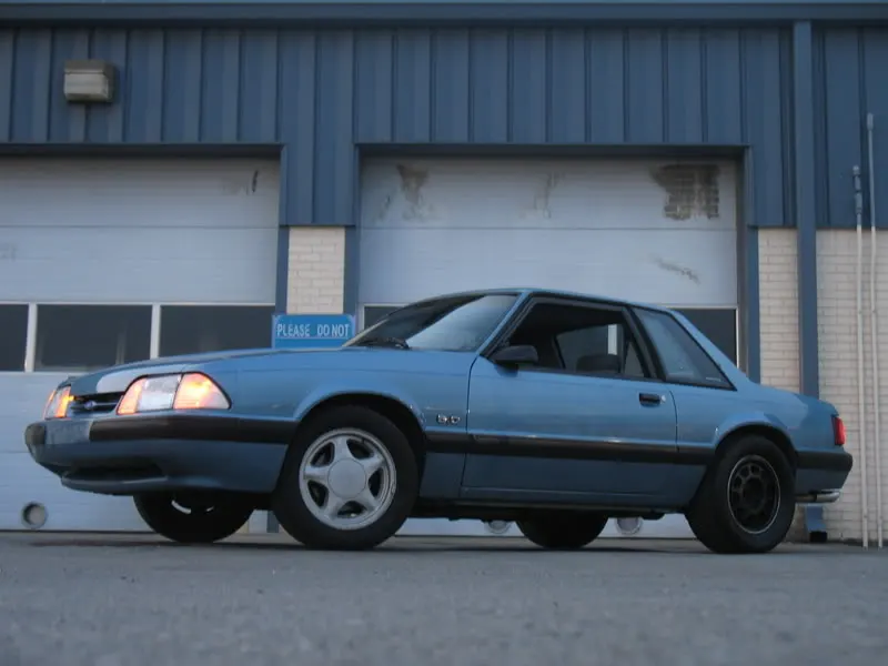

i have run 265/50/15's on my 10 holes on my 86 gt for years. they fit fine. there is a polished spot on the lower control arm where they rub slightly at full lock, but its not even enough to hear or feel. mine at dunlop gt qualifiers

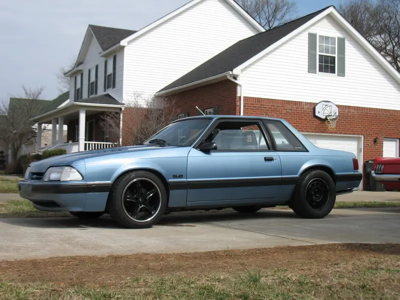

265/60s are absolutely perfect. They don't bulge too much, the height is nice...the only problem is that's a pretty uncommon size. I used to run 265/50 Pepboys Futuras and they were very nice but a little on the short side.

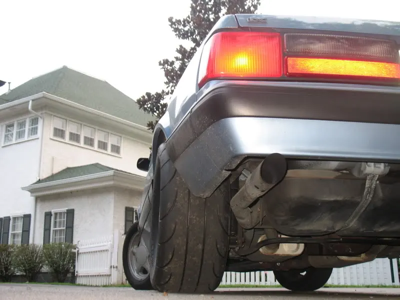

Im runnin a 275 Mickey Thompson on 10 holes. Granted they are for the track only, I have driven for a week on them every day with no problems and I drive 45 minutes to an hour one way to the track every Fri night.
