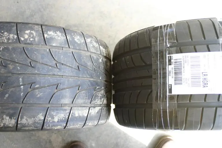

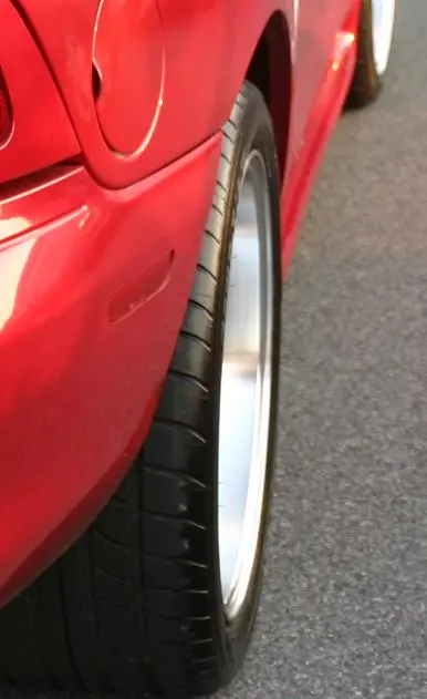

The 315 555's will work fine. I have a pic of a 315 555R next to the 295 BFG's that I ran on my 18x10 Bullitts, they're the same size. It almost looks like you could fit a little more on the rim. :nice:
Here are some pics for reference:

Boosted98GT said:
:hail2:
Congrats nice tires! :nice:
Aren't you a moderator on Modularfords?
If so, your car is very nice.:nice:
Do you have any pics you can post?
i always hear that BFG's run big and Nittos run small, but never seen any specific pics or anything.
that is kinda surprising though, that the 295 BFG and the 315 nitto look to be about the same size in your pic.....
nice comparrison pic :nice:
