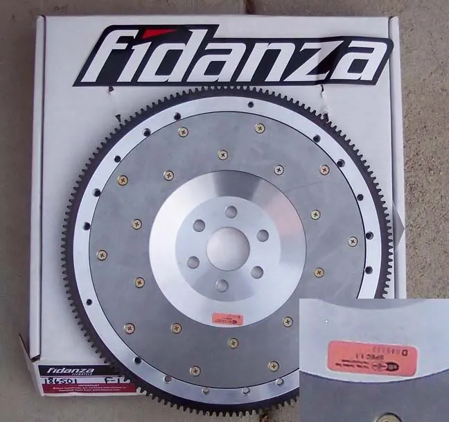

The Fidanza aluminum should be SFI approved........that's what I have and it's SFI approved. :shrug:

65ShelbyClone - As far as Fidanza being SFI approved, Summit's website's says its not approved and I can't find anything on their website saying if it is or is not.
I think I will end up going with the Aluminum, I think the 347 should have plenty of torque down low (especially compared to my current 289 setup) to compensate for the less rotating mass.

I have thought about that, the Fidanza has a replacable/servicable steel friction surface.
Go to Fidanza's catalog download page here. Dowload the catalog and you'll see that their flywheels and flexplates have the SFI seal. Mine does:
