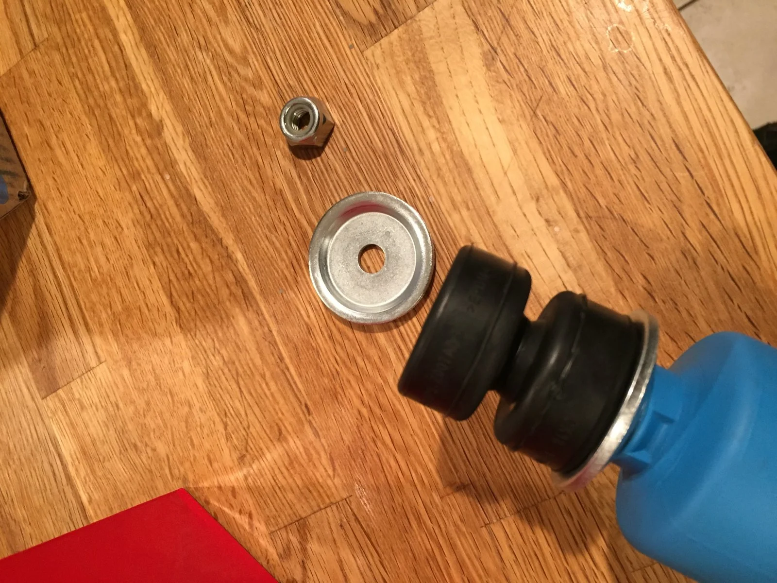

I'm having trouble figuring these out. They are 94/04 shocks but that shouldn't matter. Not enough threads to engage the nuts.

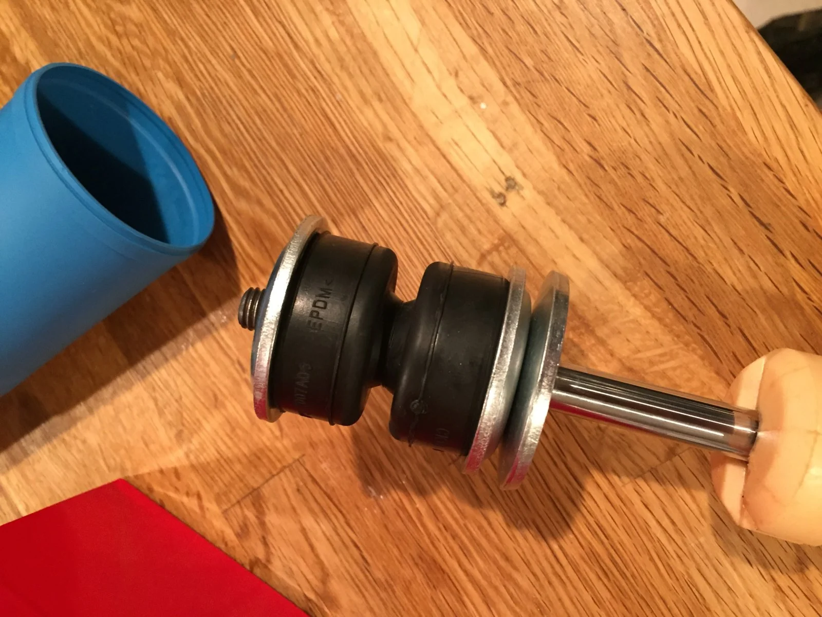

Circlip everytinh bottoms out on

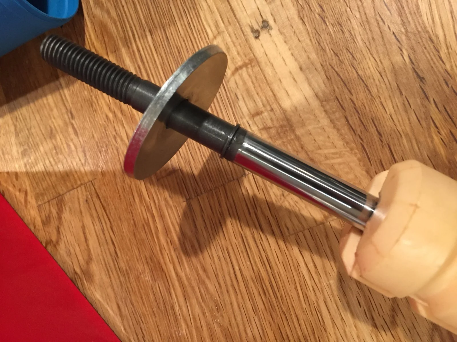

You can see the stackup minus the dust boot gives me 1/4"
But the spacer in the boot is more than that. So with everything installed I have no thread

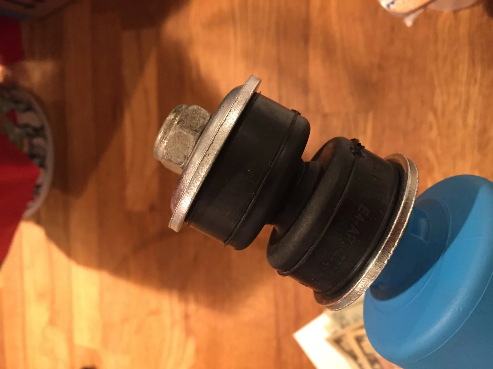

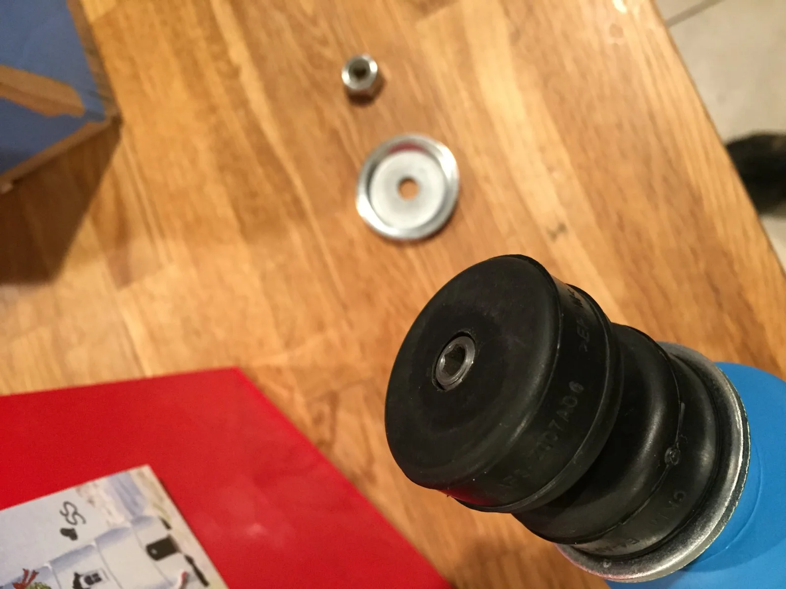

I've pushed and pulled and rearranged but can't get a nut on these. All pics I find show this exact arrangement.
Both shocks do this

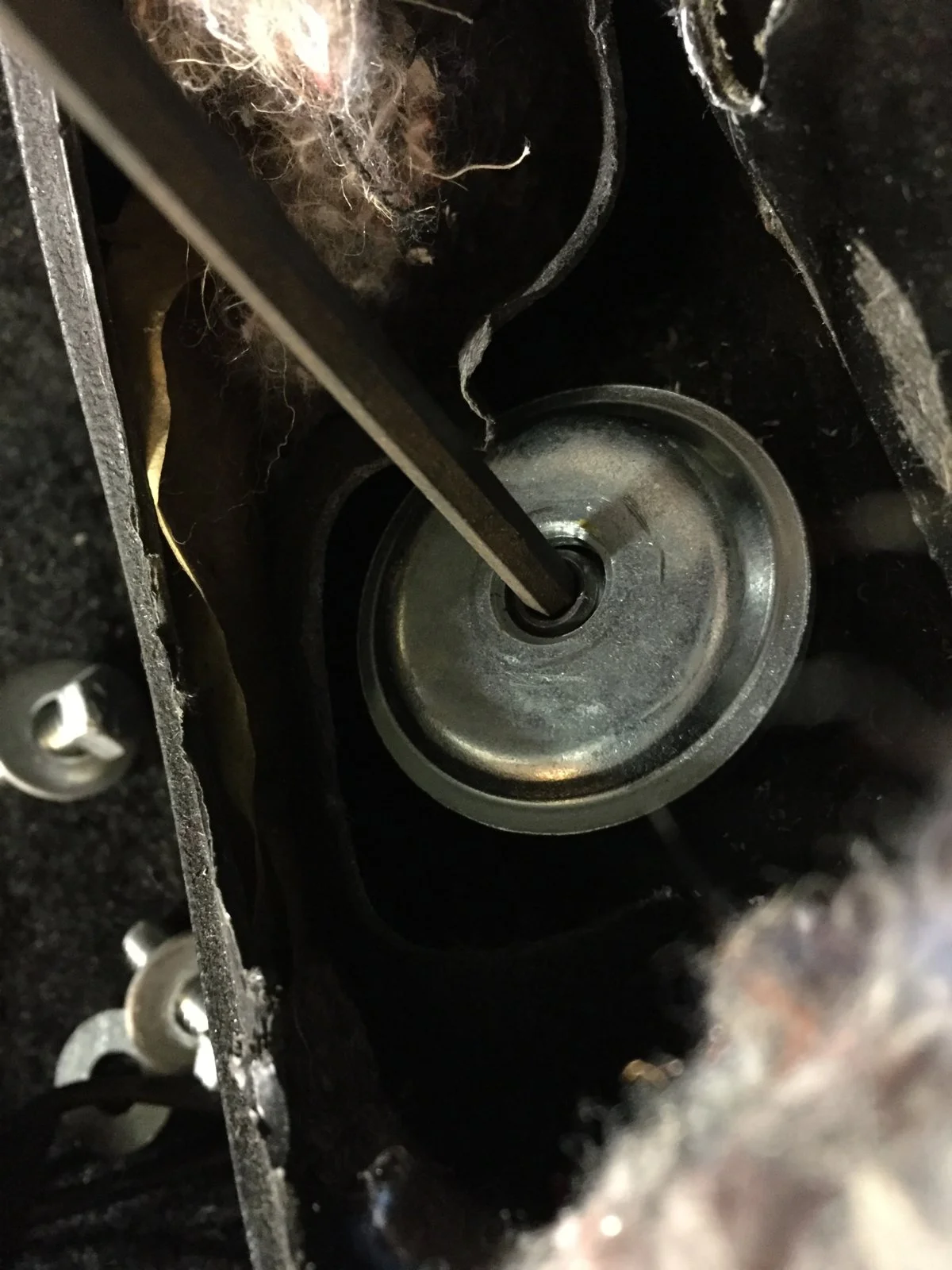

This is what I got on both sides. Can't catch a single thread
