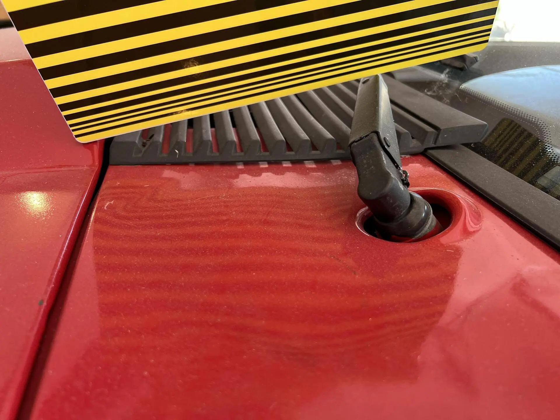

Also, I'm seriously considering starting on some body work. I know this thing is wavy as the ocean and I also know there are some bad spots hiding under the absolutely terrible paint. I am considering stripping the paint off, at least a panel at a time to see what's under there and if it's worth repairing or better off replacing.
Basically I have a running and driving coupe with a great drive train (other than exhaust leak) and interior but it needs paint/body bad. I know for sure I won't take less than $10-12k for it as it sits, but if I put another $10-15k in paint and body I don't think I'd get that back, unless I sit on it for another 10 years. And if I do that, I really would want to change it from Red to Blue, which means to do it right tearing it all the way down to do the engine bay and all. I dunno, I need to decide if I am just going to start plugging away at it, go full retard with it, or sell it.

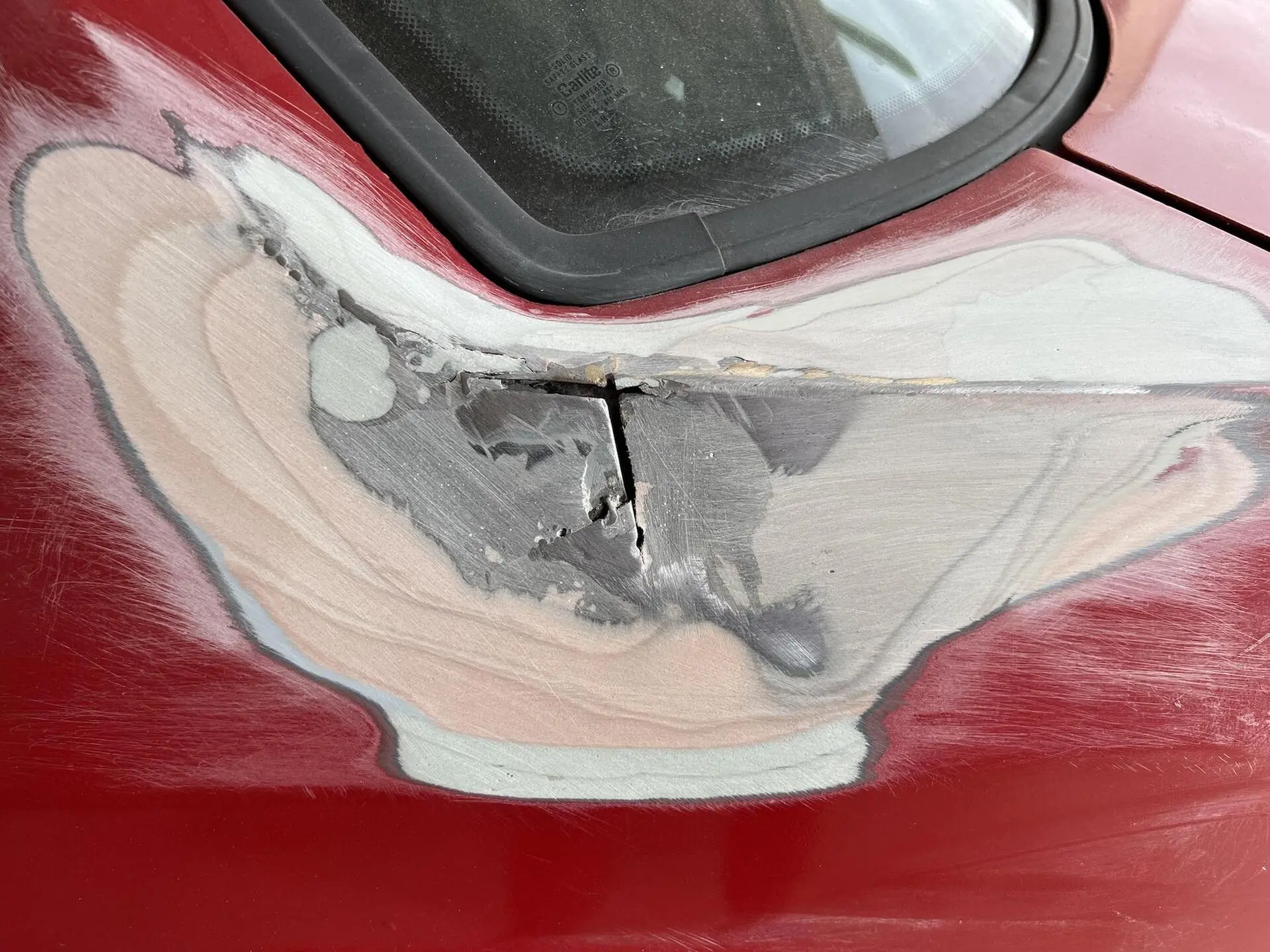

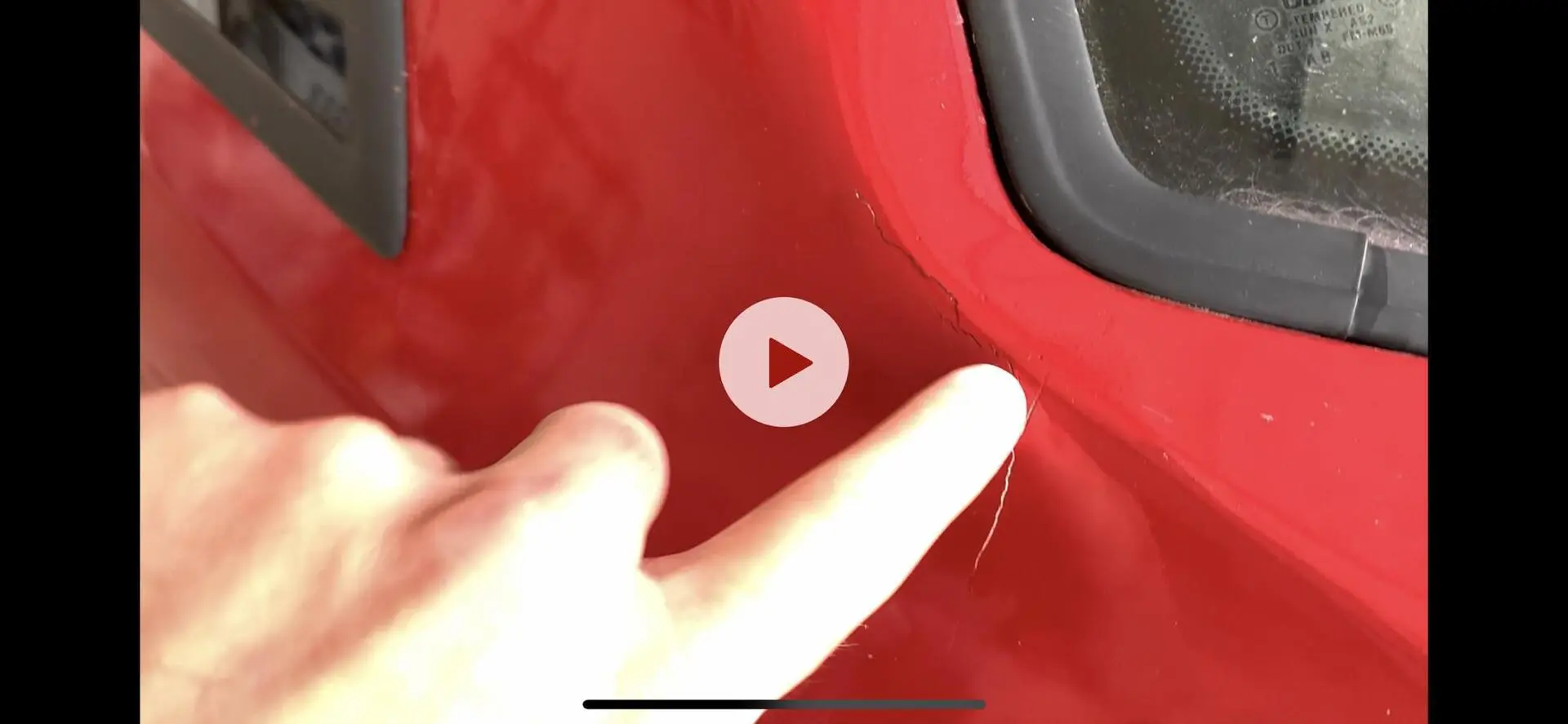

I always knew the paint and body were crap, but didn't know how bad until I started digging... it's beyond my skill level to fix it, I'm no @95steedamustang so I pulled the rip cord and stopped before I found or made it worse. Really the car needs to go down to bare metal and get fixed right, and I just can't do that.
This was clearly some bondo cracking under the paint...
So here's what I found when I sanded it down. Some idiot cut a right angle in a dent instead of pulling it, then closed it up with Bondo. Also the cowl has some damage, among other crap.
