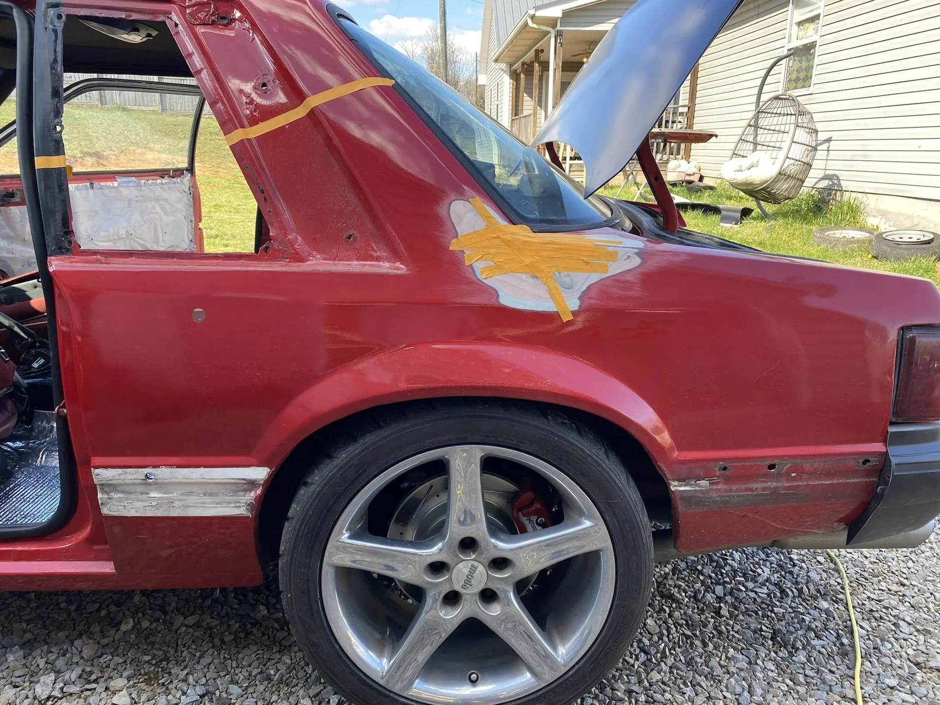

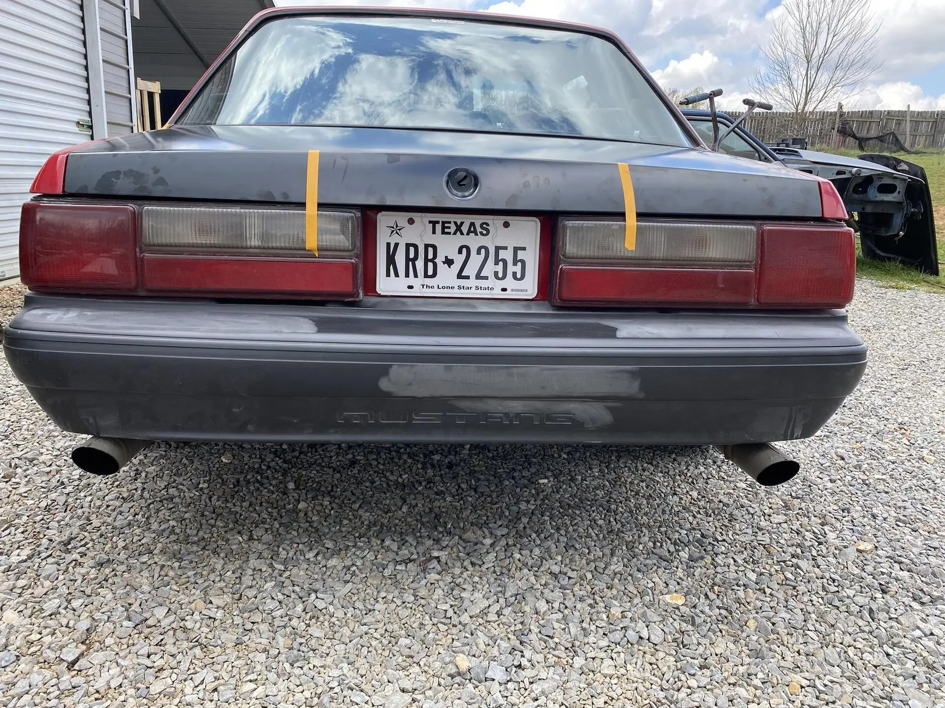

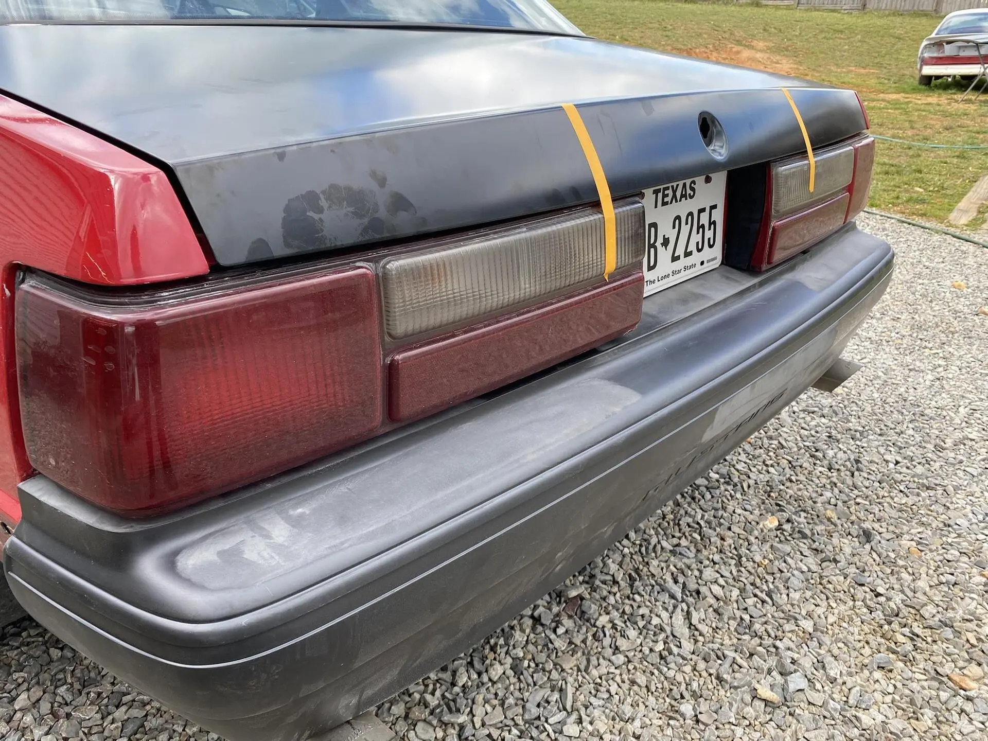

Surprise... I didn't sell it. Take note of the tape line on the roof.

So my rear bumper cover and trunk lid were in bad enough condition that it was smarter/cheaper to buy new ones and get them fitted up. We were going to need them in order to get the rear fender replaced and fitted correctly, so LMR to the rescue and Kevin was able to mount them up real quick to check quality/alignment and it'll be much easier to work with. I also intend to get some 1986 style tail lights for it as well, since the ones I have aren't great. Has anyone gotten the ones from LMR and have a review?

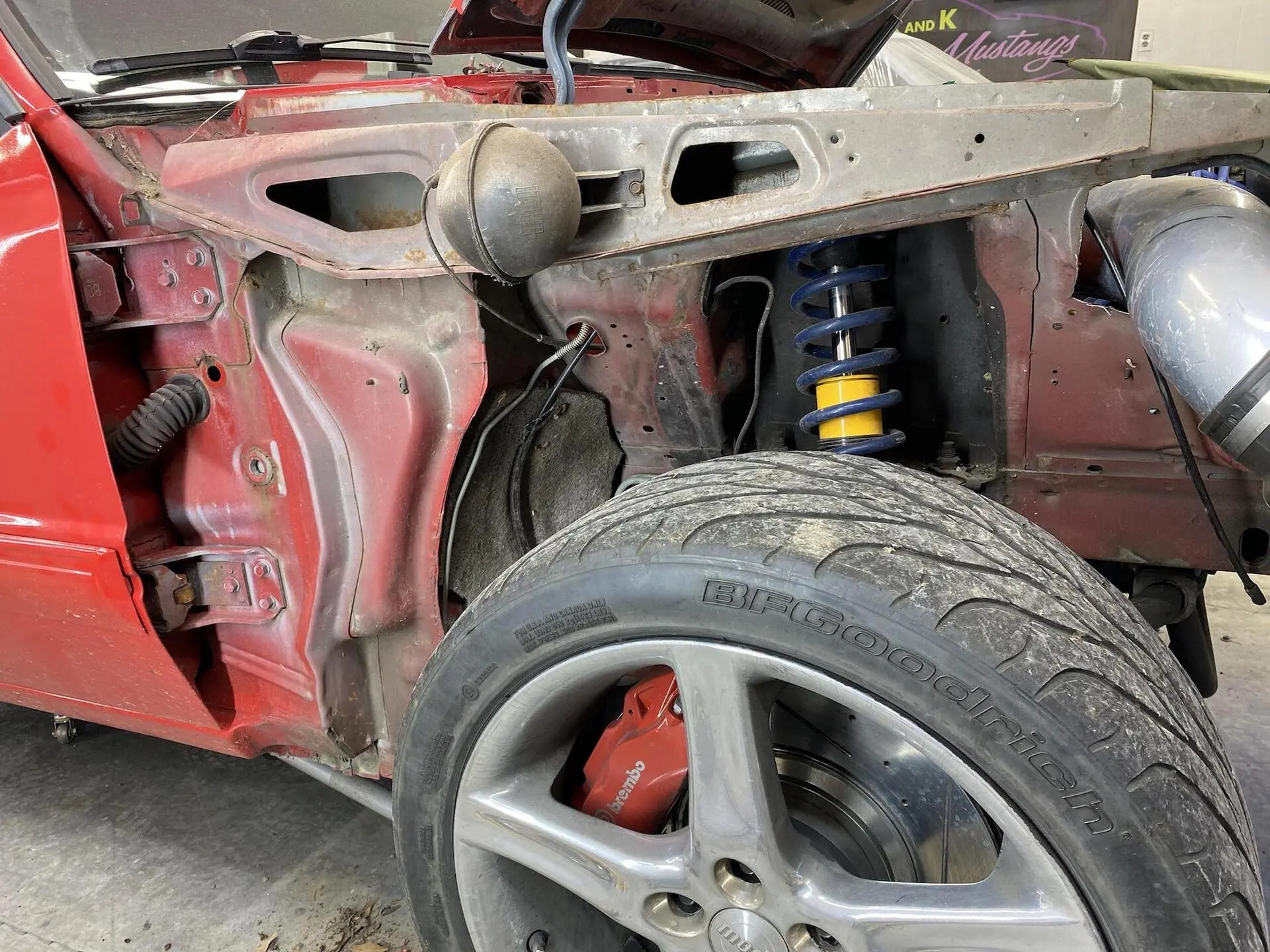

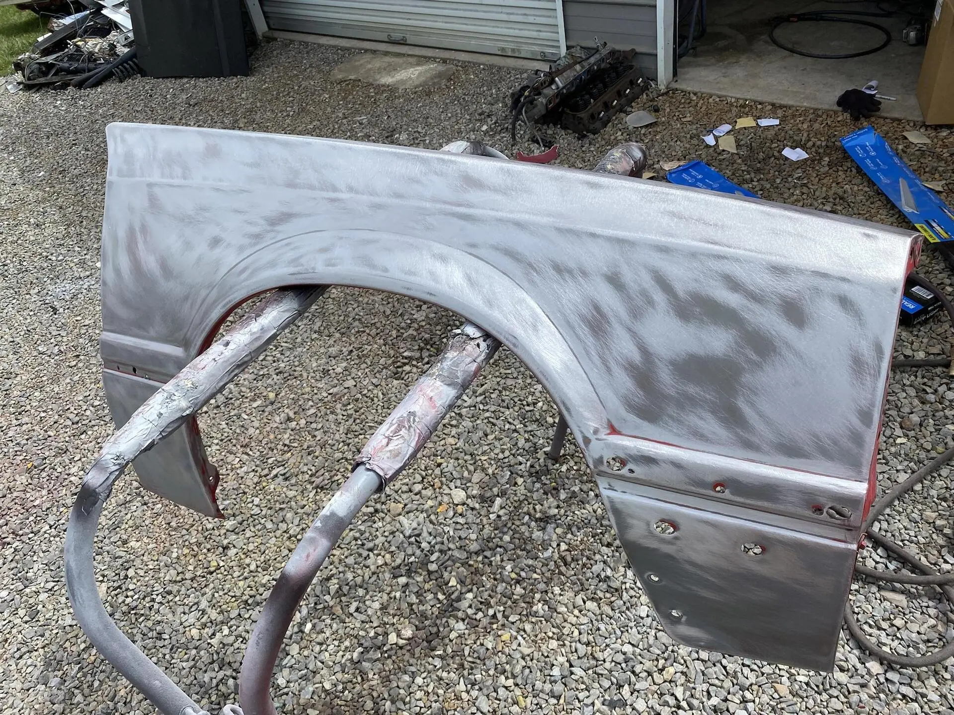

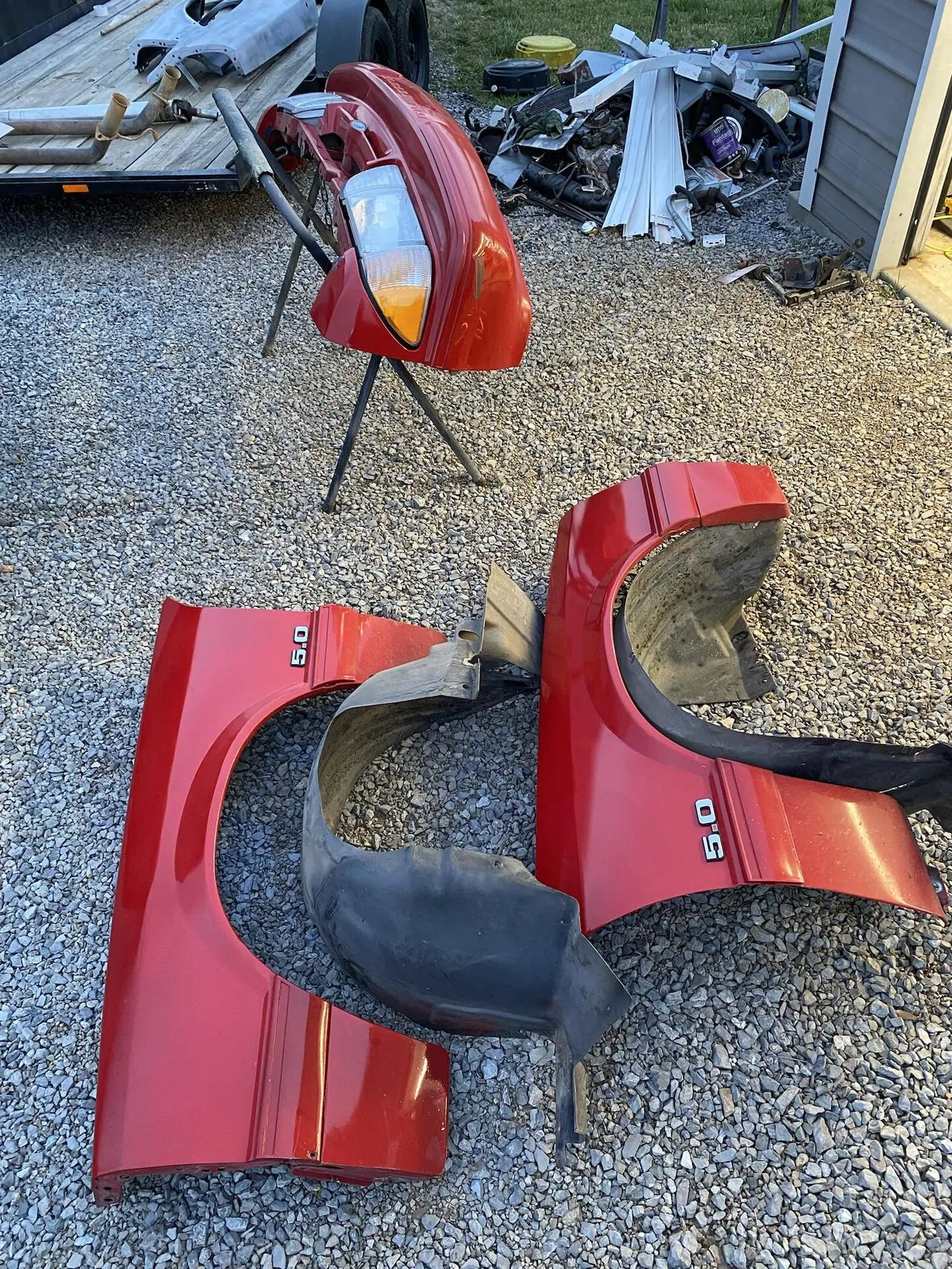

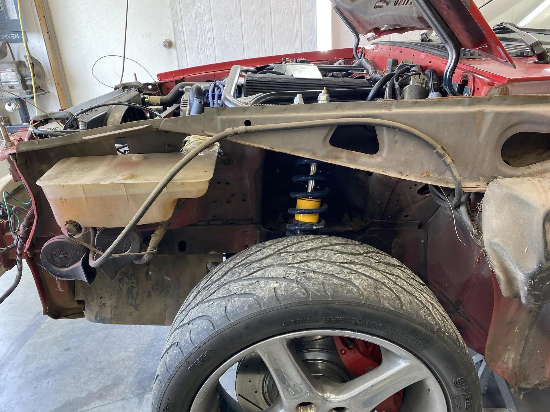

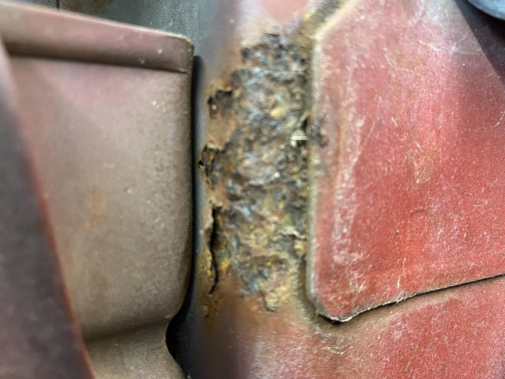

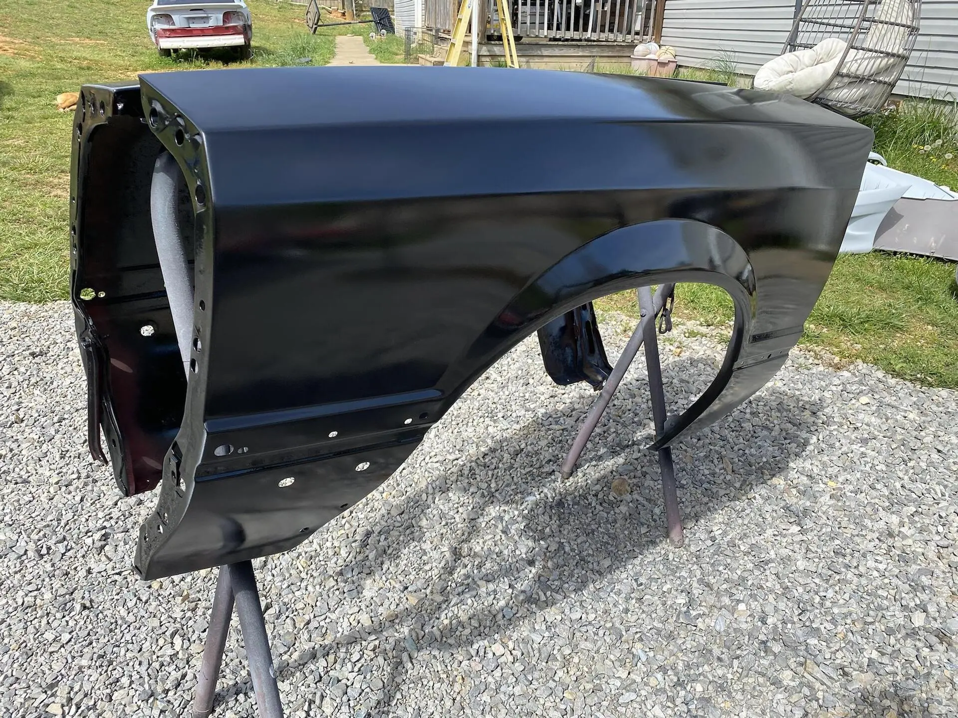

Tear down continues, last week the new trunk lid and rear bumper cover were delivered, I will order a new hood, front bumper cover, fender extensions, and 10 piece molding set this week. The cowl has damage (knew about it already) and will be replaced with the one from the donor car, as well as fix some rust areas on the driver's door mount area. Passenger side still looks good and clean.

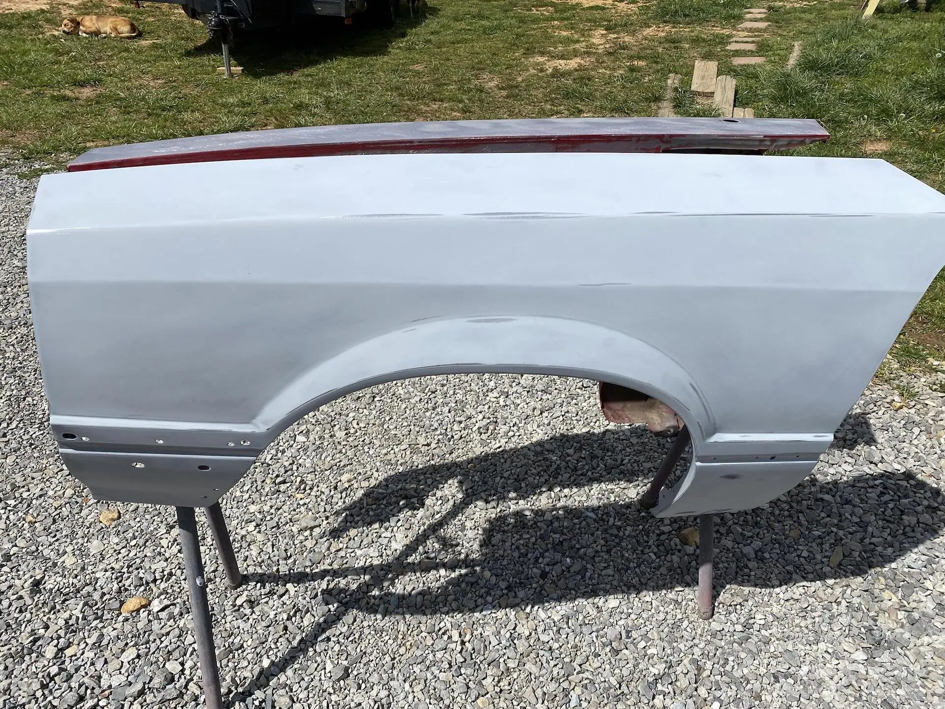

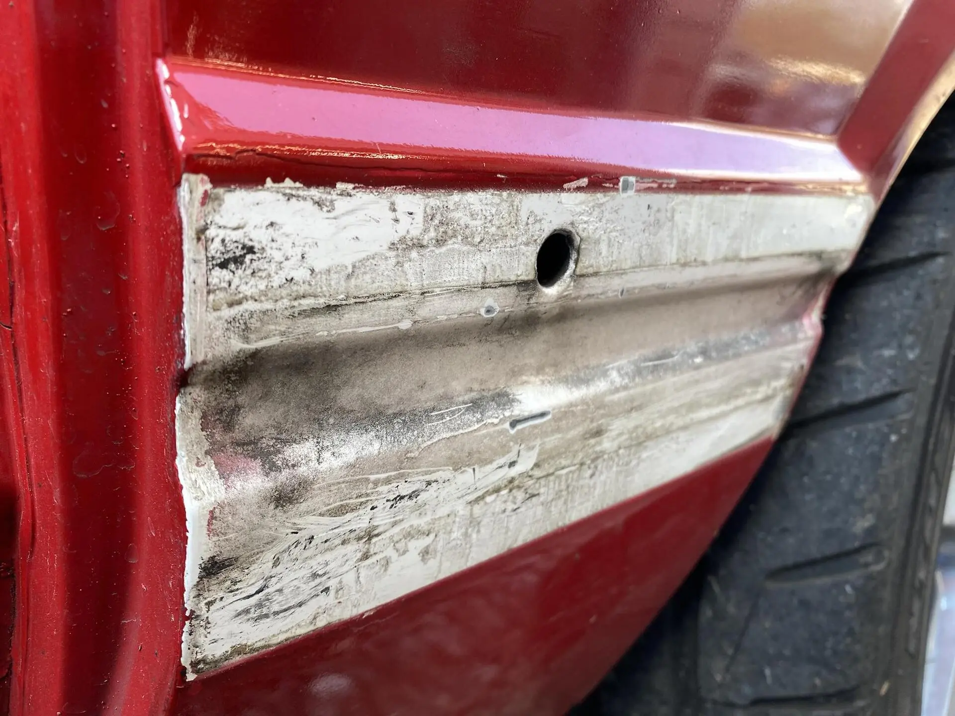

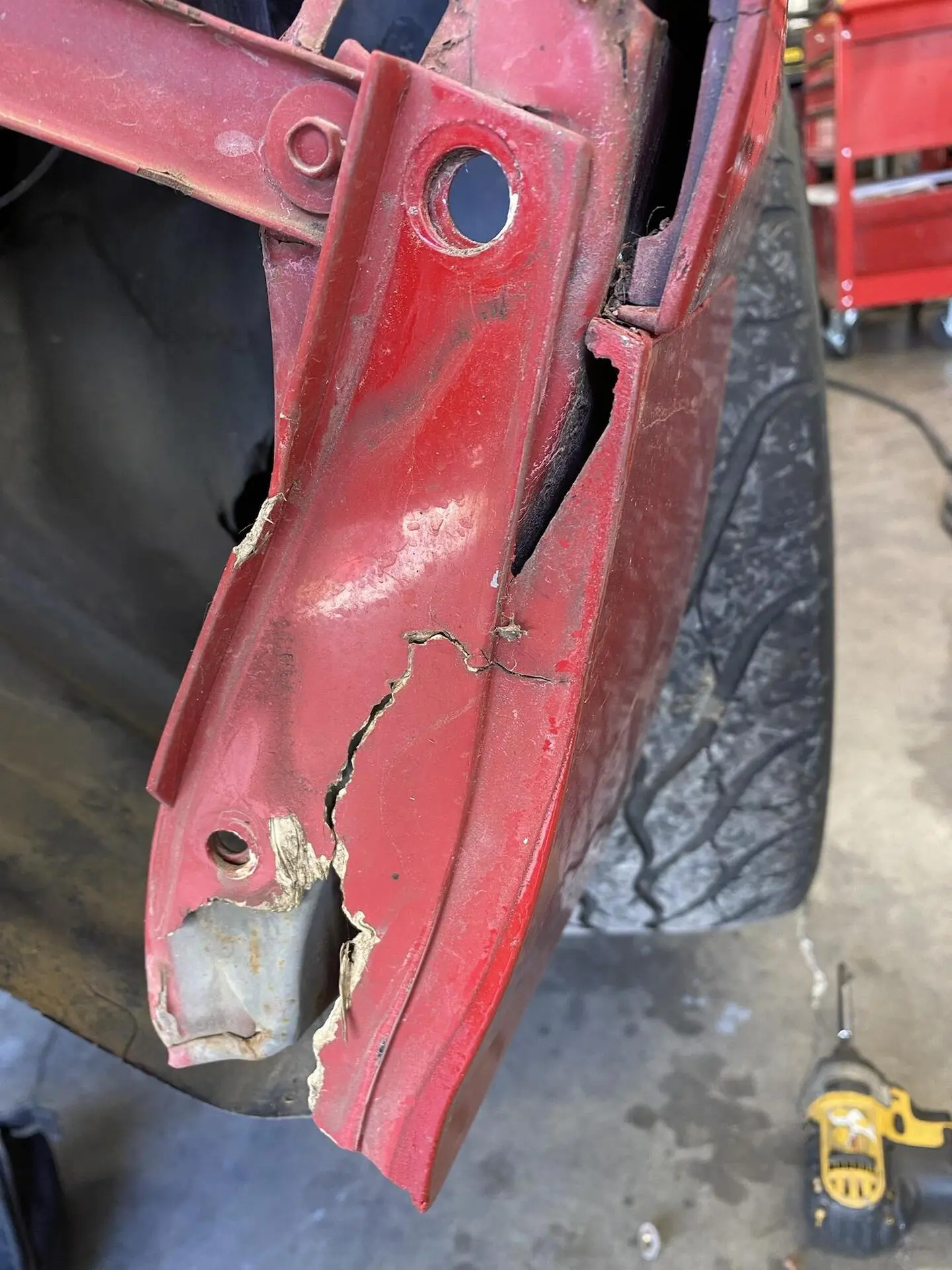

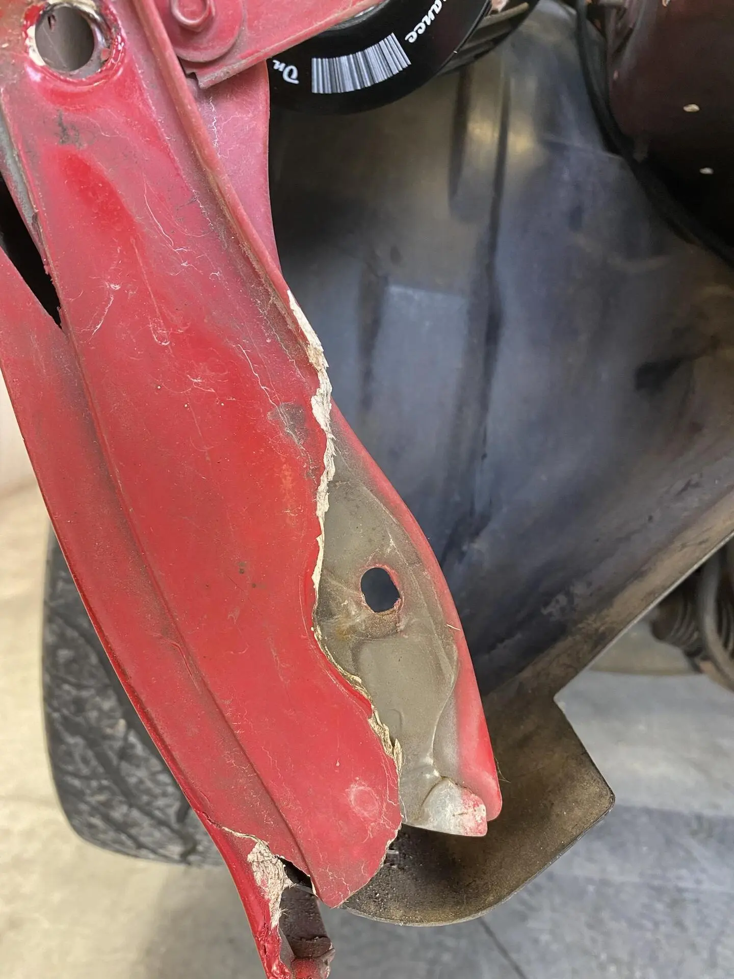

On the rear fender that has to be cut out and replaced, once the trim was pulled we found that not only is this the worst repair maybe ever (up by the window) but that this fender had already been replaced and it was STILL that bad of a job. That's white paint under the trim... astounding.
